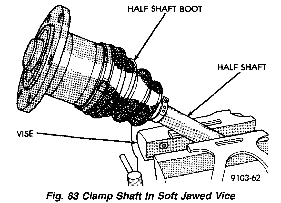

Passenger side. Rear tire is extremely hard to turn and differential bangs against underbody.

First, check to make sure the brake isn't locked. Remove the brake a caliper to see if that allows the wheel to turn.
If it doesn't, unbolt the axle at the differential (see attache picture). See if you can then turn it.
Let me know the results.

Okay, e-brake was locked. Differential still bangs and jumps.

Welcome back:
Confirm that the CV joints in both rear axles are in good condition and not loose. Also, check and confirm that the universal joint on the driveshaft is good.
https://www.2carpros.com/articles/how-u-joints-work
Also, make sure there isn't excessive play in the wheel / hub bearings.
Lets start with the simple things first. Also, let me know specifically when the issue happens as well as if anything changes it. I really want to eliminate the easy things before we dig into the differential. Make sure the differential fluid is full and clean.
