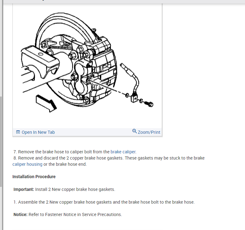

October of 2020 I lost brakes completely coming off a steep hill. The car has always had a soft pedal so this spring I replaced the master, all 4 rotors, pads and one caliper. Now it seems there is more stopping force in the rear of the car and the brakes get hot enough to smell in a fairly short distance, especially going down hill. Could it be a proportioning valve problem? I am out of ideas on how to fix this thing. Again, pedal is softer than I think it should be and the rear brakes get hot real fast. The car is disc all the way around. No lights on the dash and as far as i can tell the rear calipers are not stuck.

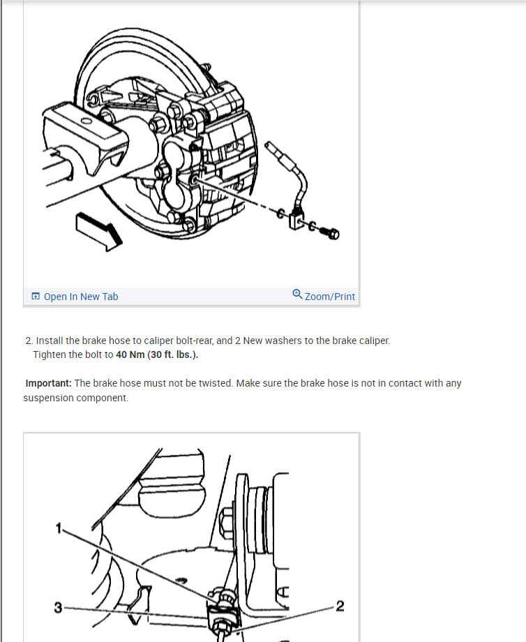

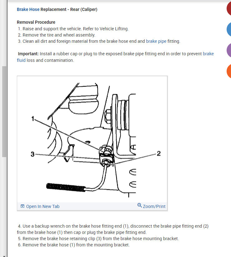

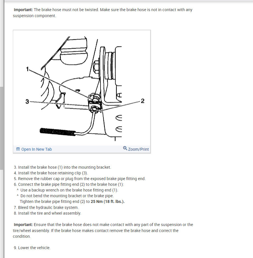

I suspect the issue by be a rubber line heading to the caliper but this is unlikely that both would have failed at the same time.
So if all this happened after the master cylinder then you may have a faulty master that is holding the caliper partially applied.
However, I would start with checking the rubber lines by holding them and having someone apply the brakes. If the line swells then more then likely it is failed and needs replaced. This actually will hold the caliper partially applied.
