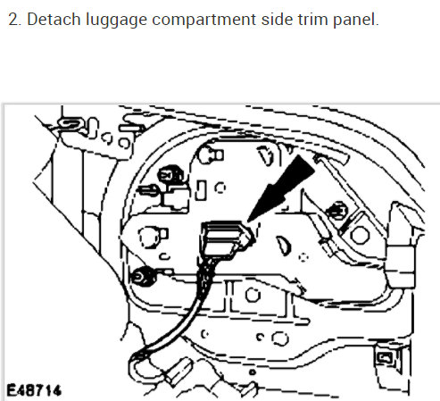

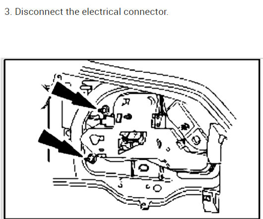

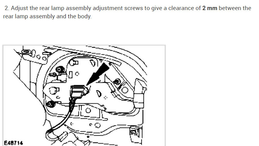

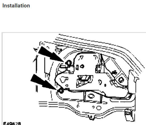

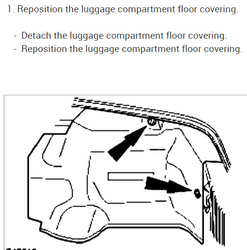

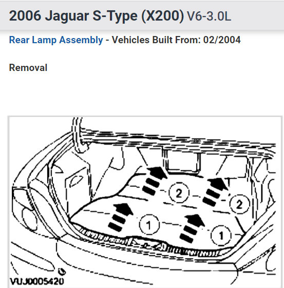

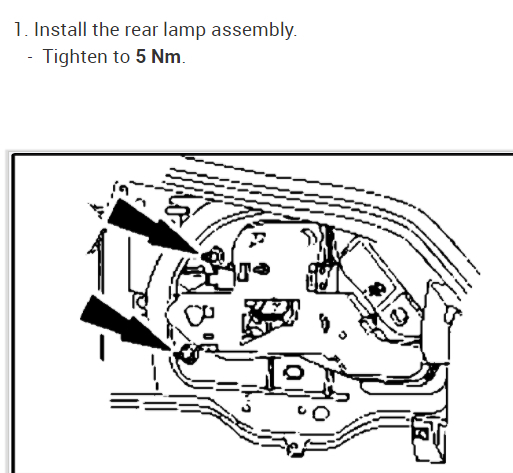

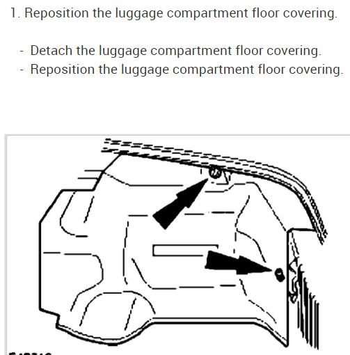

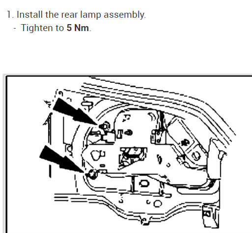

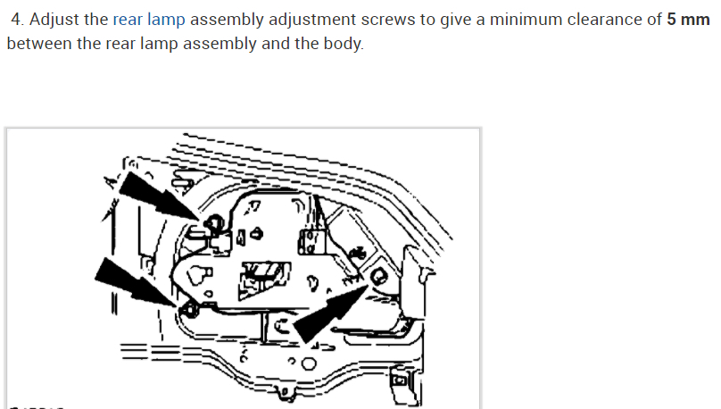

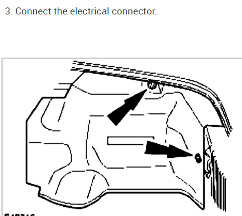

How to open cover? brake lamp is out.
Apr 4, 2017 at 10:10 AM
DANNY L
  • 5,648 POSTS
Hello, I'm Danny.
Here is the information you've requested. I've attached picture steps below on how to remove the taillight assembly to gain access to change the brake light bulb on your car. Hope this helps and thanks for using 2CarPros.
