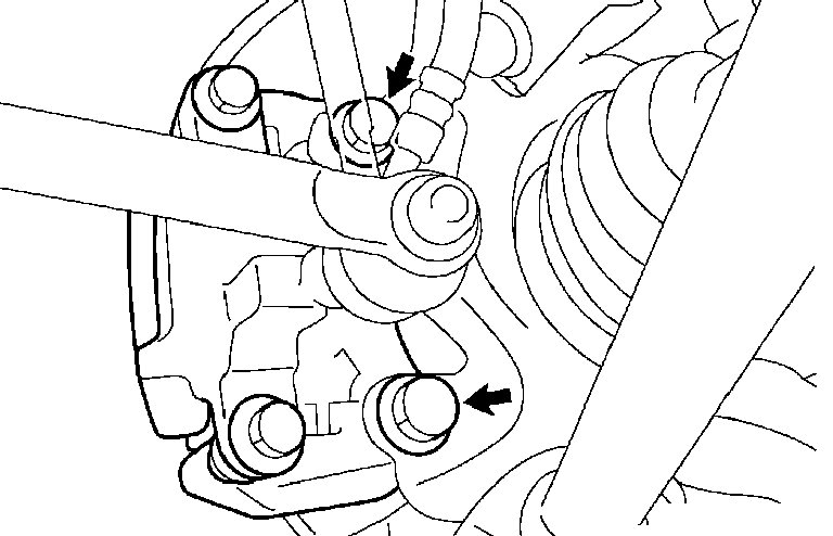

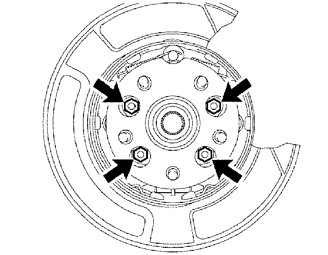

Was told I needed to replace rear axle and drive shaft because you can’t just replace the bearings in this model vehicle. It has a shake in the rear at low speed between 20 and 45 mph.
Mar 21, 2019 at 6:32 AM
  • 110,248 POSTS
Welcome to 2CarPros.
The axle shaft which has the CV joints on it is separate from the hub bearing. I wonder if the terminology is getting mixed up. If the bearing is bad, it can be replaced. If the axle shaft is bad, it can be replaced, and I'm not sure why they said the drive shaft needs replaced other than they may be referring to the axle as the drive shaft. So, that will need confirmed.

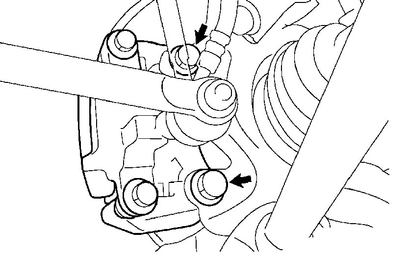

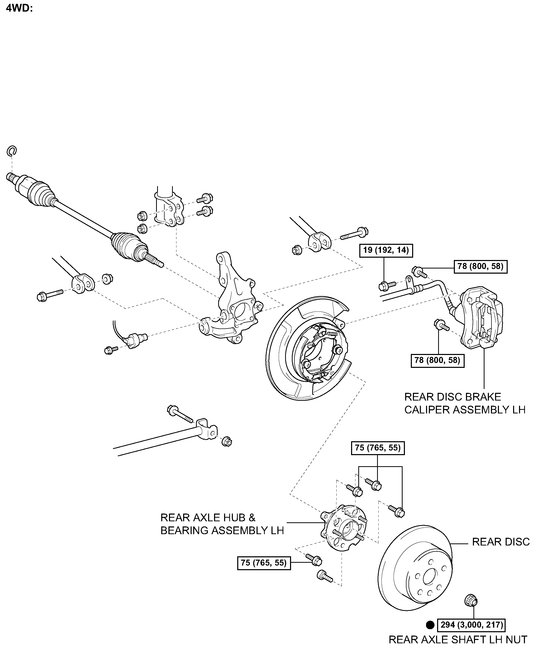

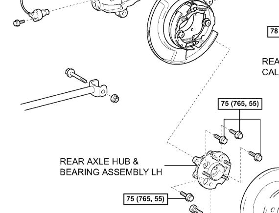

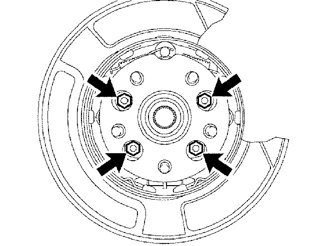

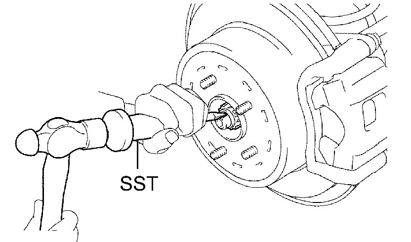

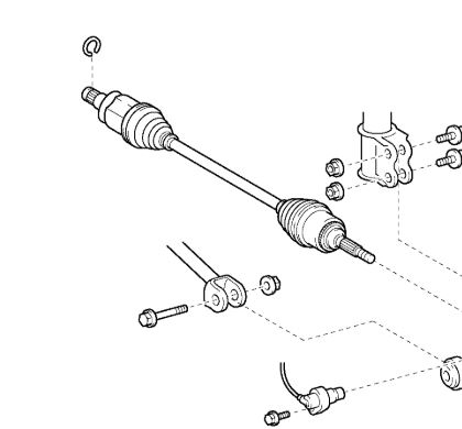

Here are the directions for replacement. The attached pictures correlate with these directions.

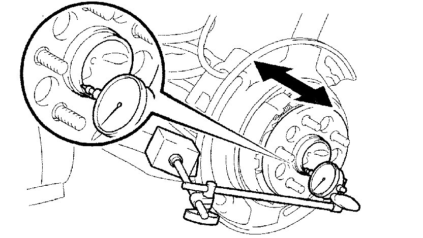

ON-VEHICLE INSPECTION
picture 2
1. INSPECT REAR AXLE HUB BEARING LOOSENESS
a. Using a dial indicator, check for looseness near the center of the axle hub.
Maximum: 0 mm (0 inch)
If looseness exceeds the maximum, replace the axle hub assembly.
NOTICE: Ensure that the dial indicator is set at right angles to the measurement surface.

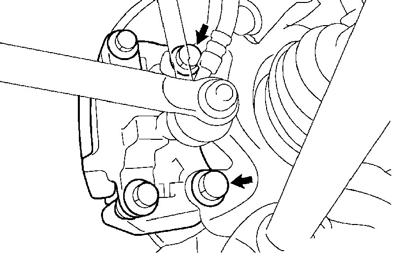

2. INSPECT REAR AXLE HUB BEARING RUNOUT
a. Using a dial indicator, check for runout in the surface of the axle hub outside the hub bolt.
Maximum: 0.08 mm (0.0031 inch)
If runout exceeds the maximum, replace the axle hub assembly.
NOTICE: 30 Ensure that the dial indicator is set at right angles to the measurement surface.

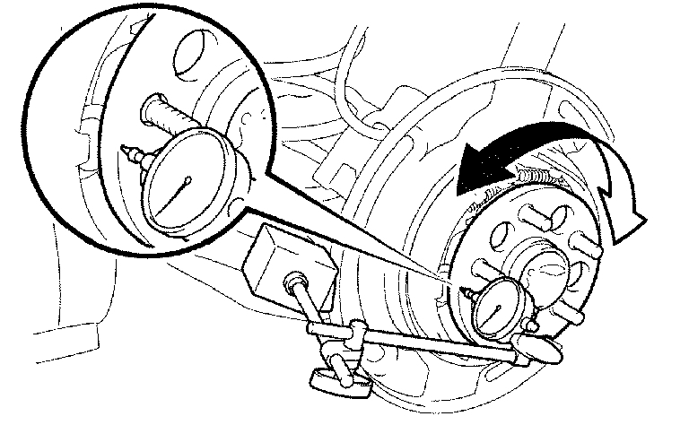

2. SEPARATE SPEED SENSOR REAR LH
picture 4
3. REMOVE REAR AXLE SHAFT LH NUT
a. Using SST and a hammer, unstake the staked part of the axle hub LH nut.
SST 09930-00010
NOTICE: Loosen the staked part of the nut completely, otherwise the screw of the drive shaft may be damaged.
b. While applying the brakes, remove the lock axle hub LH nut.

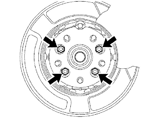

5. REMOVE REAR DISC
picture 5
6. REMOVE REAR AXLE HUB & BEARING ASSEMBLY LH
a. Remove the 4 bolts and the rear axle hub & bearing assembly LH.

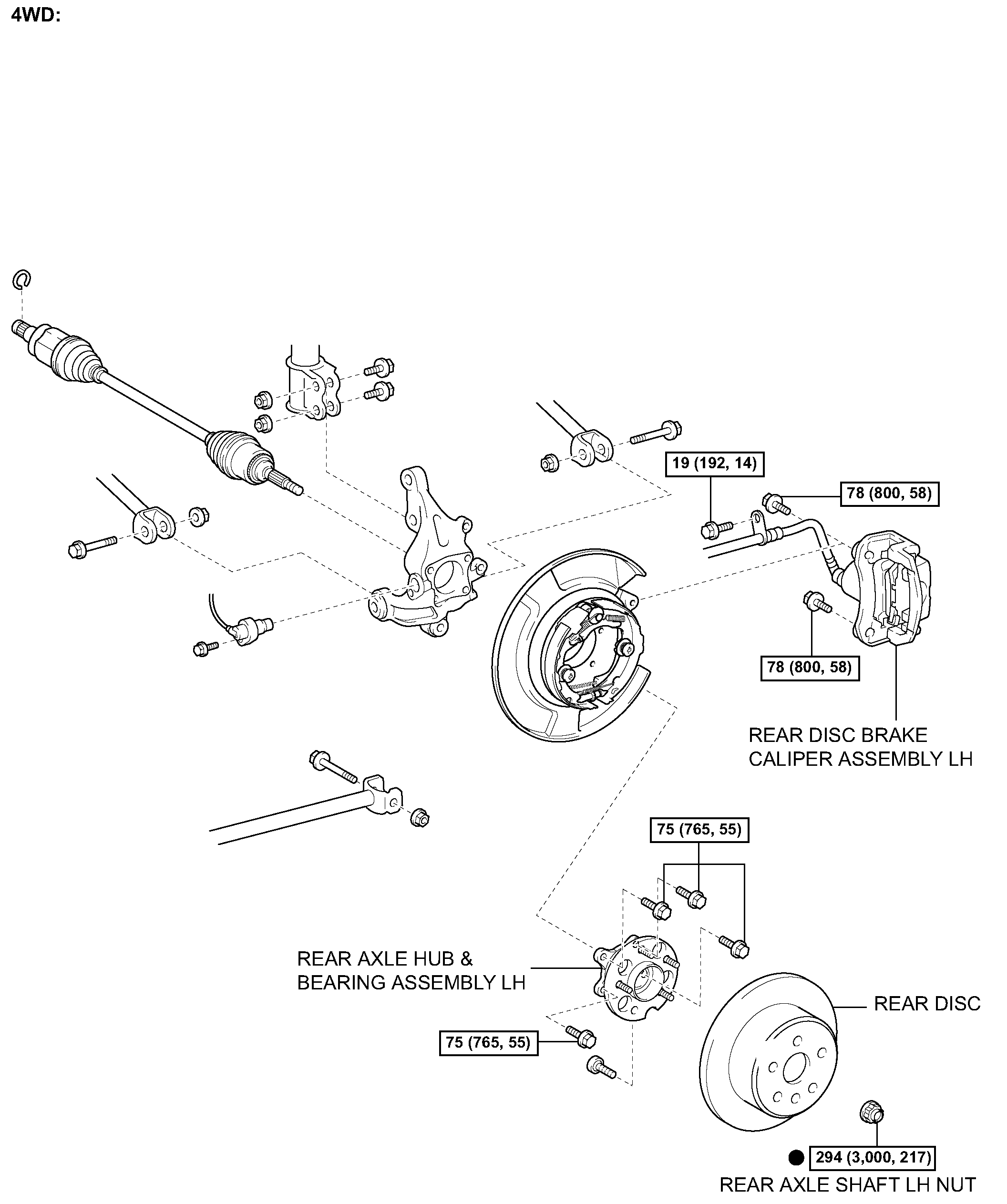

If you look at picture 1, it is an exploded view of the components. It shows the axle hub assembly and the axle. They are separate components. If you look at the last two pictures, I copied the specific parts. The first is the hub bearing and the second shows the axle with CV joints.
Let let me know if this helps or if you have other questions.
