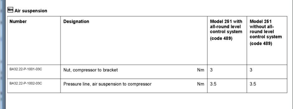

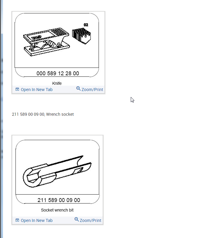

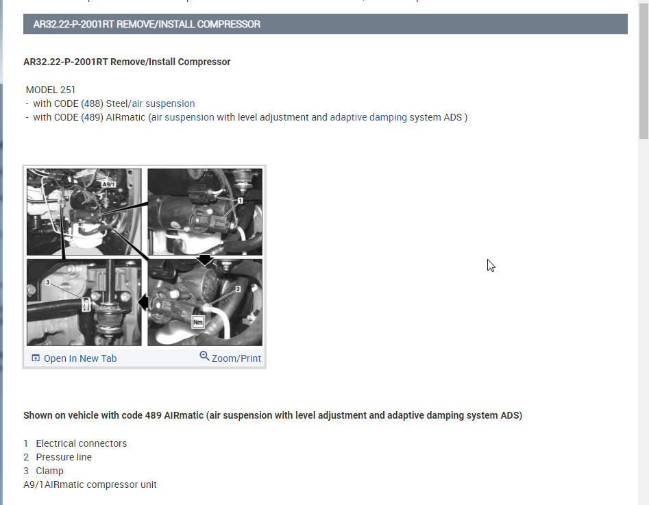

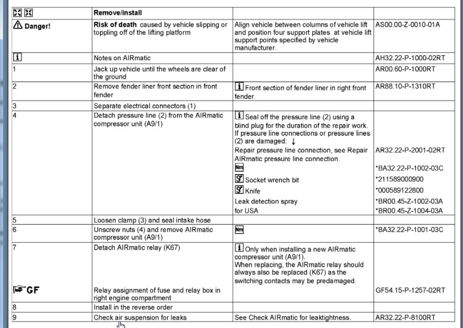

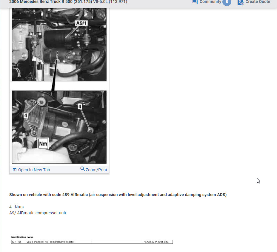

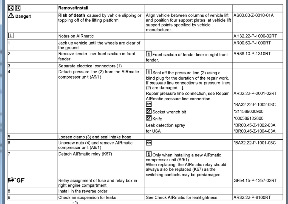

If the air compressor comes on but the suspension does not raise then either you have a leak or the compressor has burned up. This is not uncommon when you have an issue with an airbag. Basically what happens is the bag fails and has a leak. The compressor does not know this but it continues to try and fill the bag. Clearly it is leaking and the air is escaping as soon as the compressor is putting it in so the compressor keeps running. This causes it to burn out and fail. It will still run but not build any pressure.
So if the system has no leaks then I suspect you have to replace the compressor at this point. I attached the process for this below. Let us know if you have questions.
