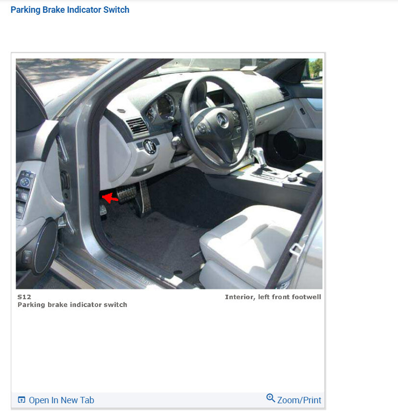

whenever i start the car and drive it, the display shows "Release parking brake" and it beeps even parking brake is not on. then i stop it and then drive it, it drives fine. Any solutions please? thanks

There are a few possible reasons why your 2012 Mercedes-Benz C180 might be displaying the "Release parking brake" message and beeping, even when the parking brake is not engaged. Here are a possible causes and solutions:

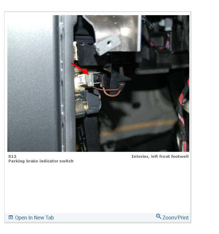

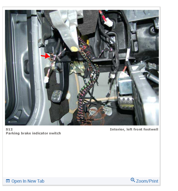

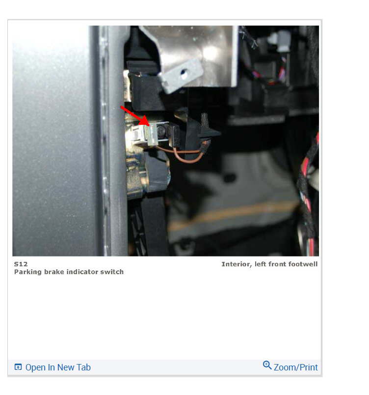

Faulty parking brake switch. The parking brake switch is responsible for telling the car's computer that the parking brake is engaged. If the switch is faulty, it may be sending a signal to the computer that the parking brake is engaged, even when it is not. This can cause the display to show the "Release parking brake" message and the car to beep.

Here is how to change out the parking brake switch which can be the problem. Check out the images (below). Please let us know what happens.
