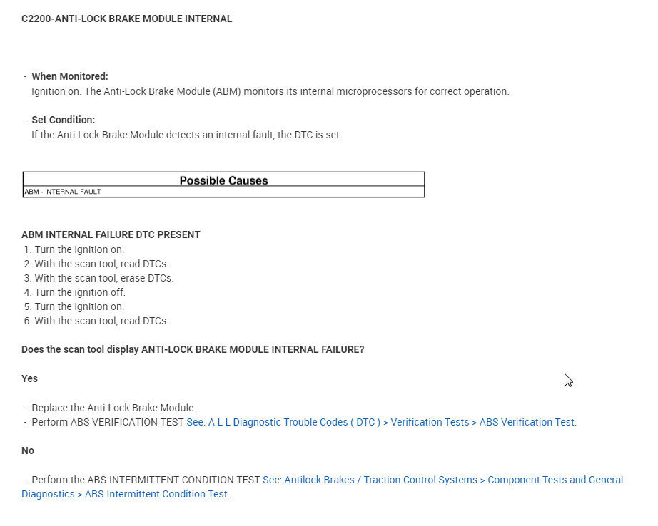

got code C2200
128,000 MILES • 3.5L • 6 CYL • 2WD • AUTOMATIC
KAMBEME

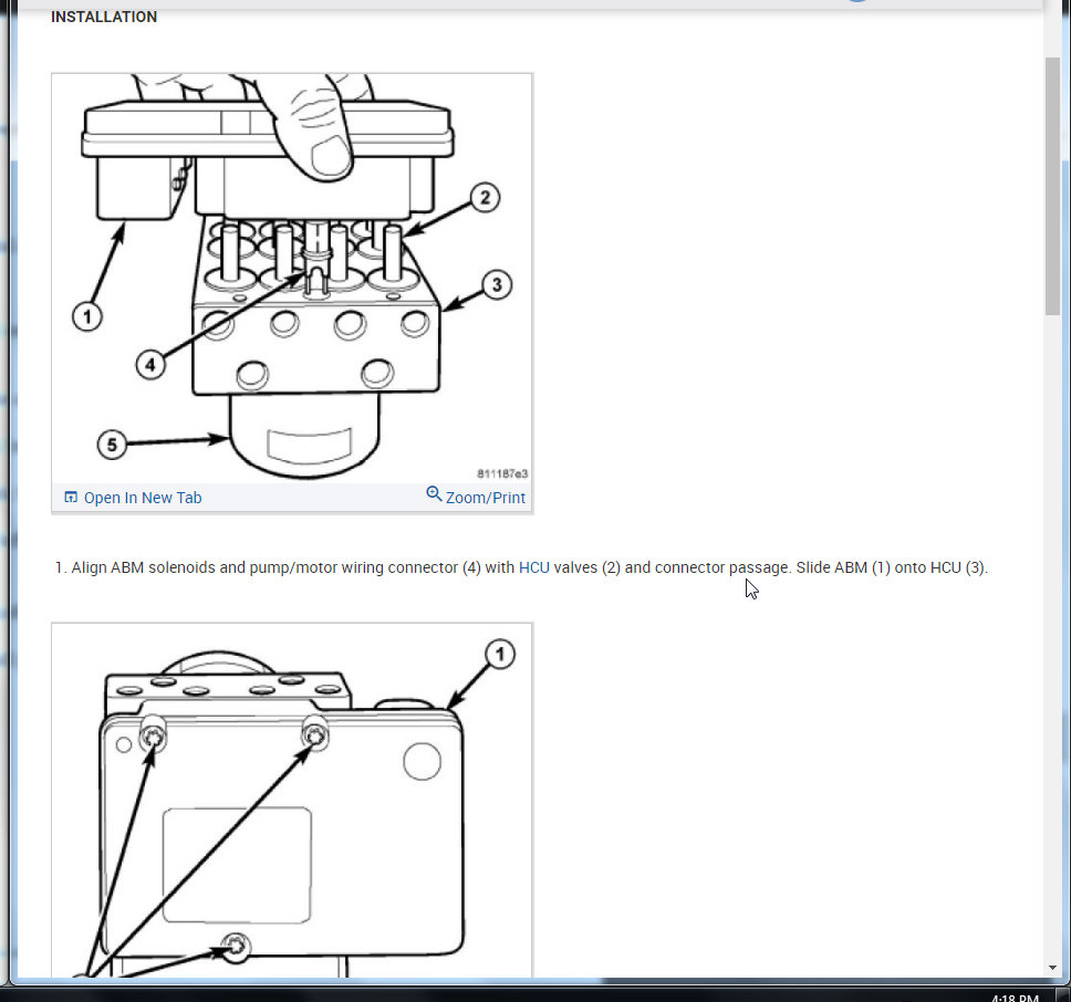

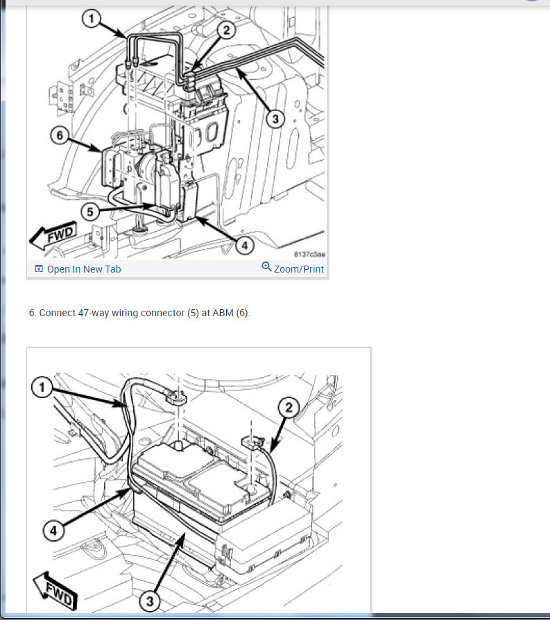

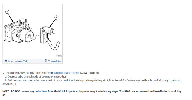

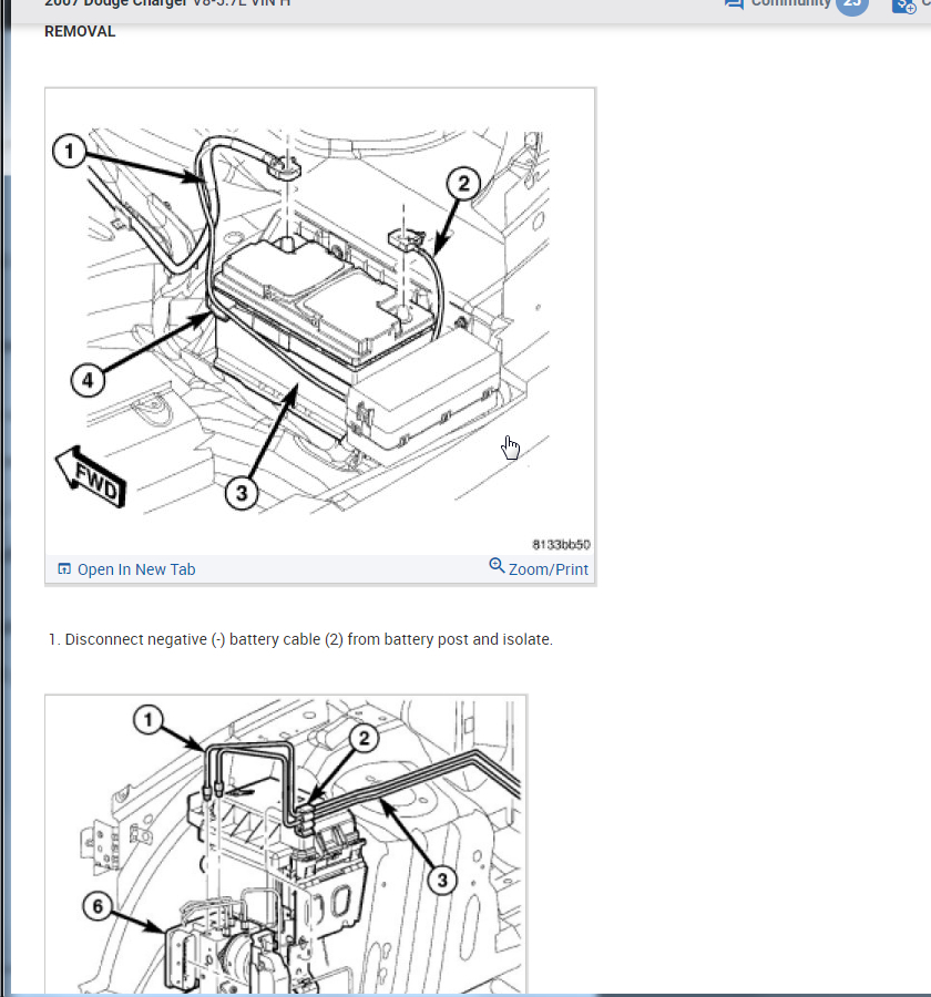

At first I needed new brake pads. So I did that, then 7 days later my emergency brake light and ABS and also a (z)- sorts z meant to look like squiggly lines in a ( ) 4.engine light as well. So I went t part store did a code scanner- got code C2200
So my question is how do I replace the ABS module?
Sep 3, 2020 at 3:53 PM

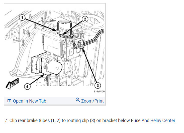

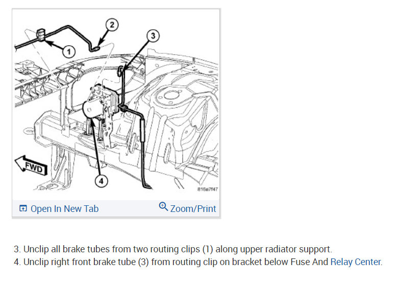

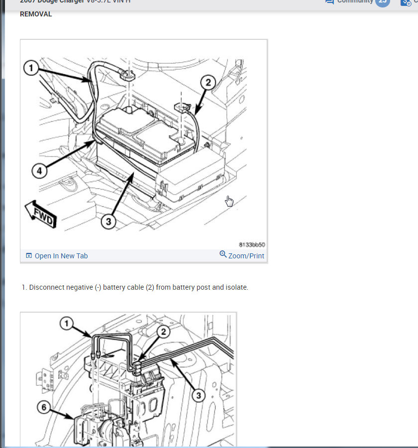

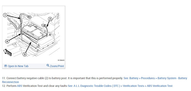

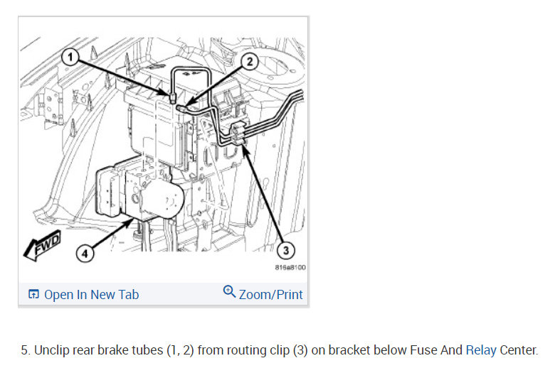

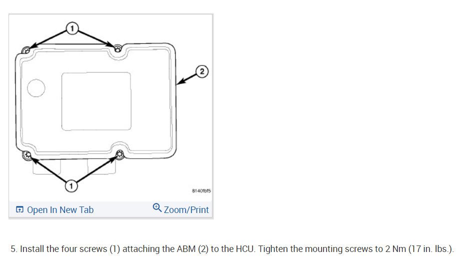

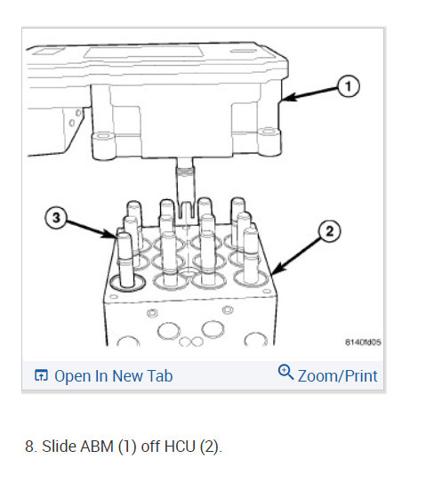

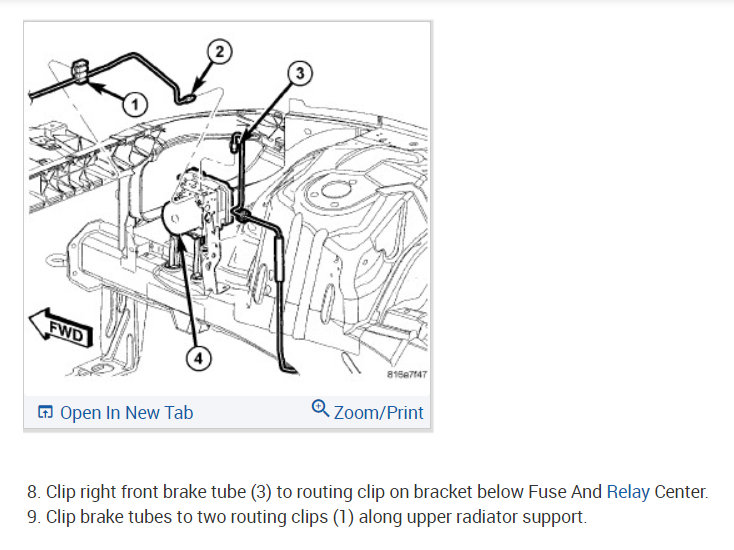

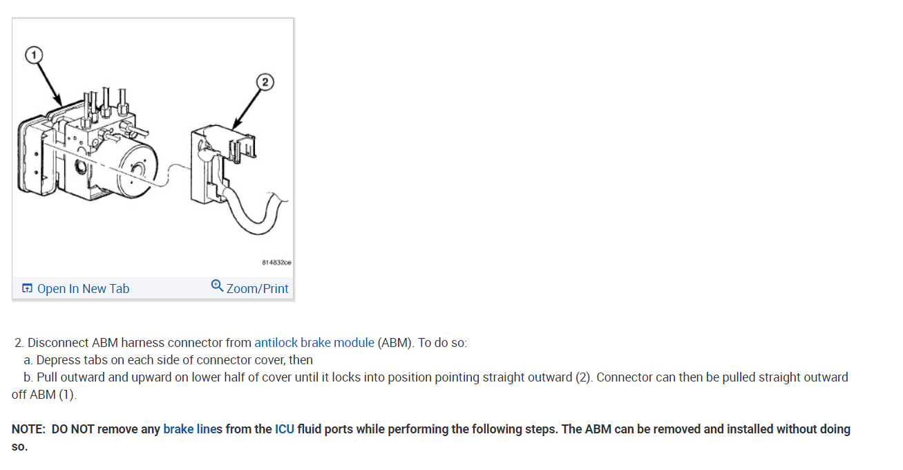

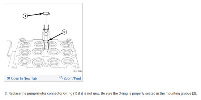

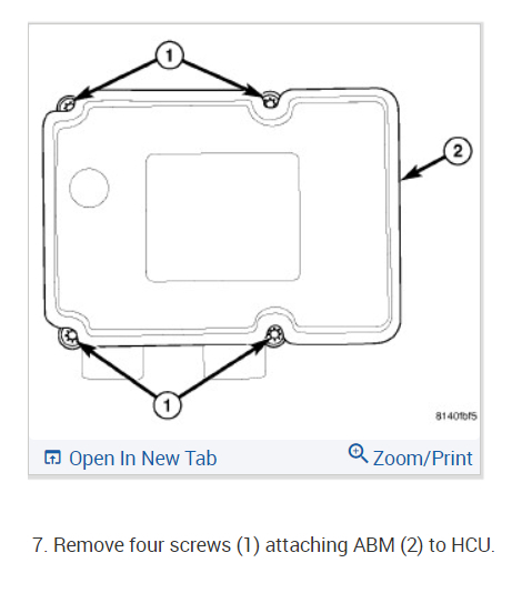

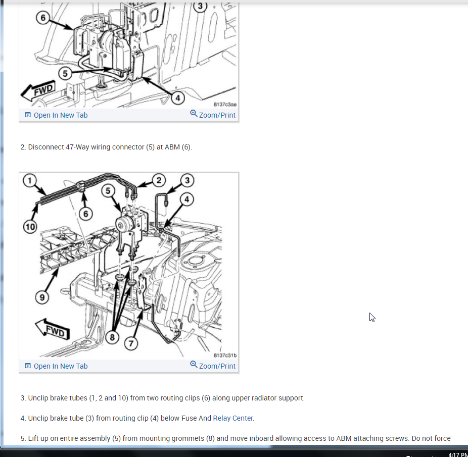

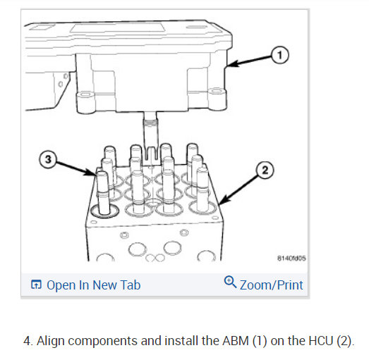

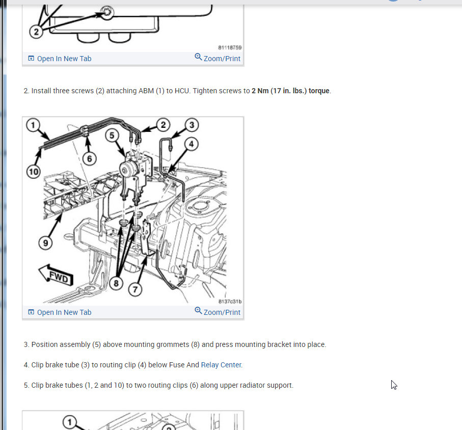

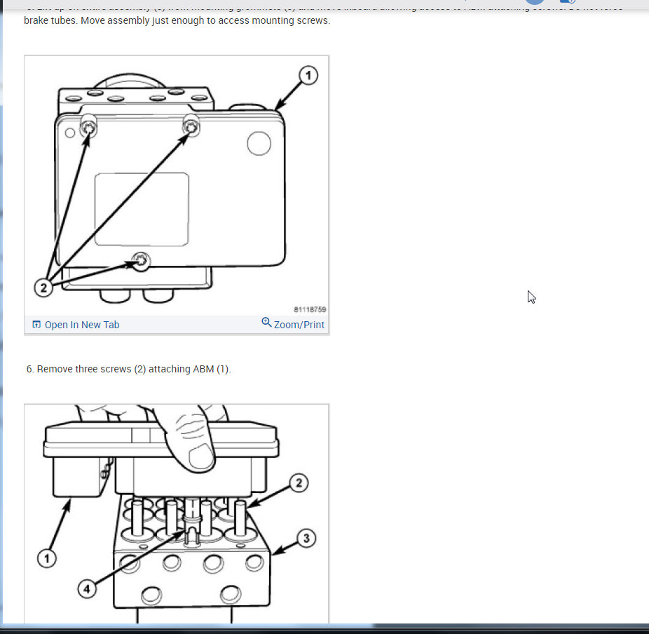

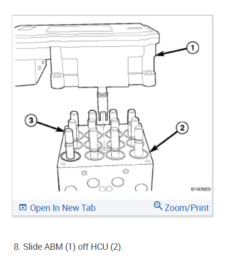

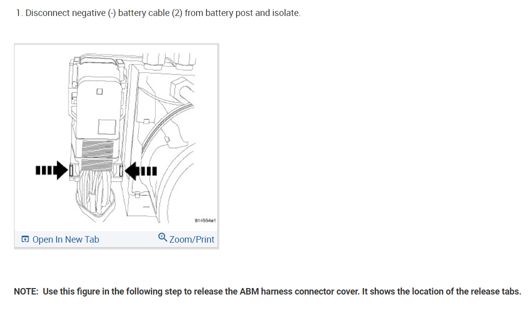

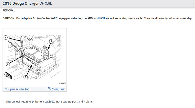

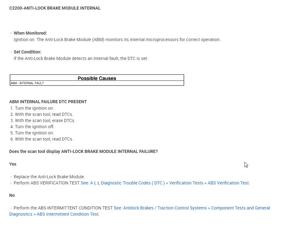

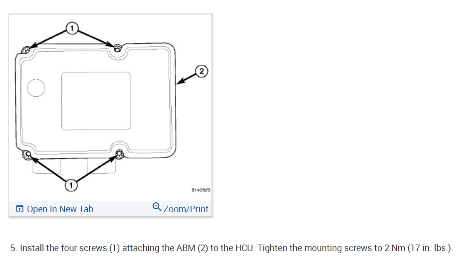

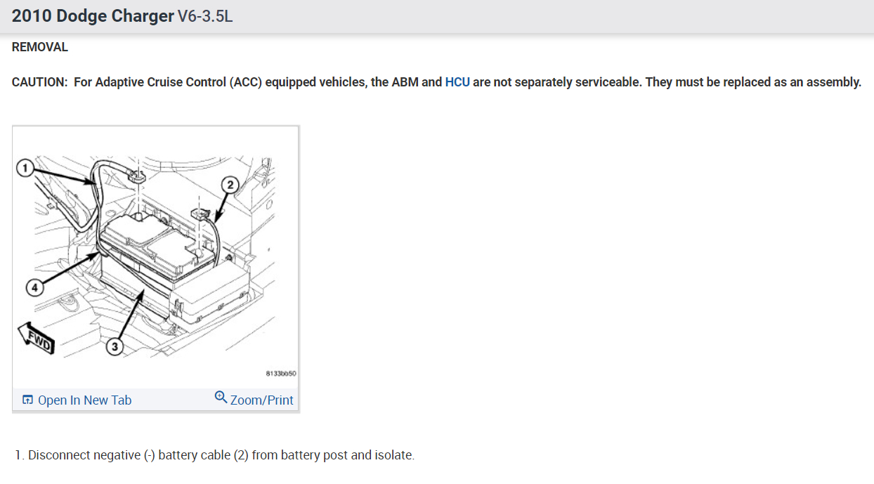

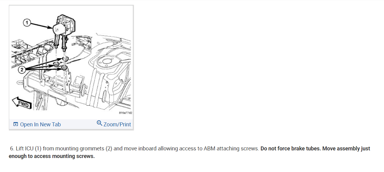

I am attaching the testing for this code and the ABS module replacement instructions. It is a pretty simple and straight forward code. If the code is active and it is displaying this code then the ABS module is the issue.
Unfortunately this would not be related to any brake work that was done, just a coincidence. This is literally telling you that there is an issue on the circuit board of the module and it needs to be replaced.

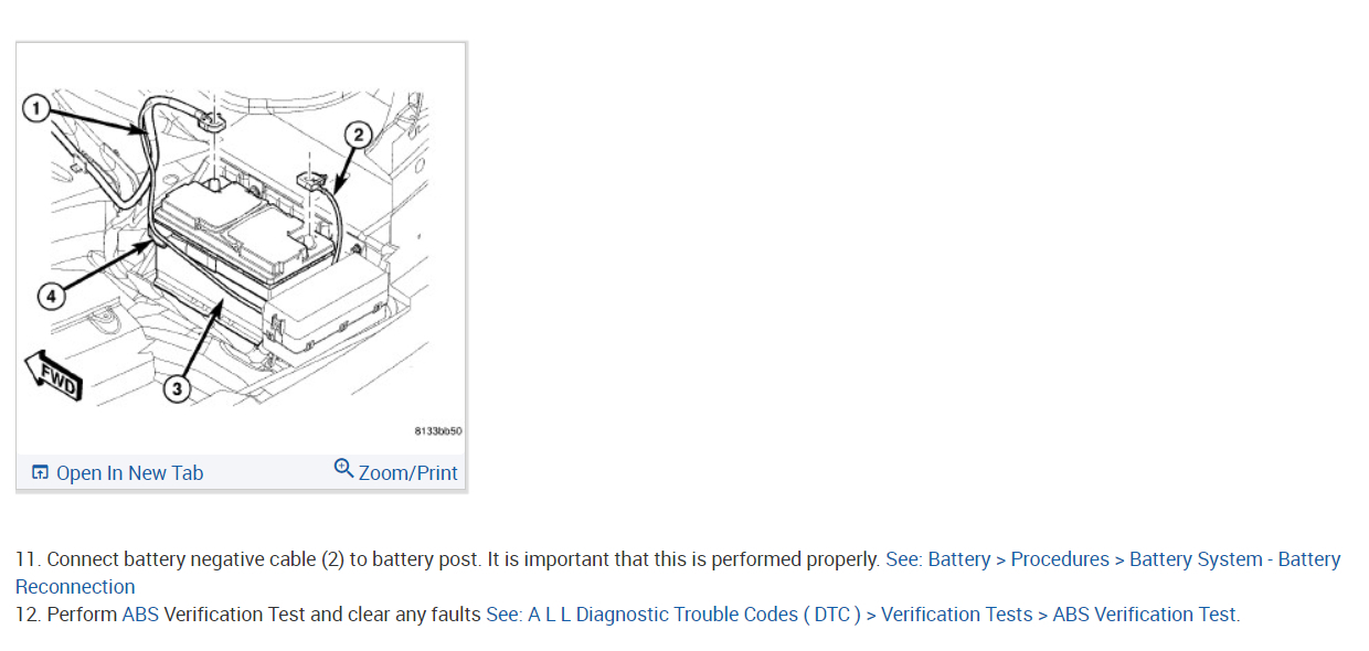

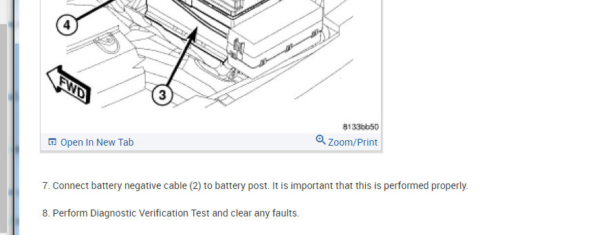

After this is done, we need to recheck the codes and make sure it is gone and this should include all the lights that you are seeing, brake light, ABS, traction control.

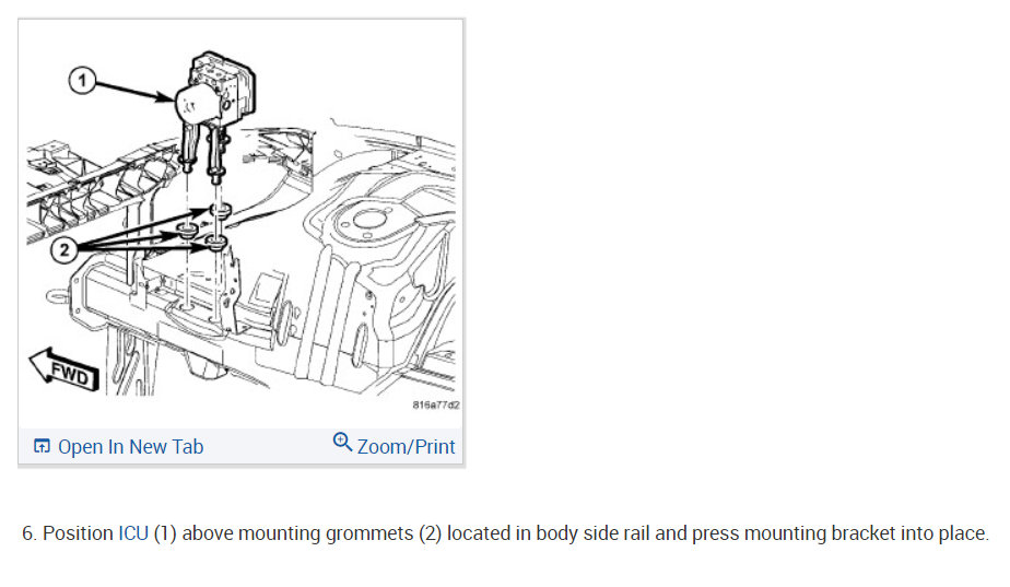

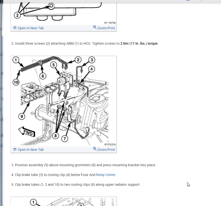

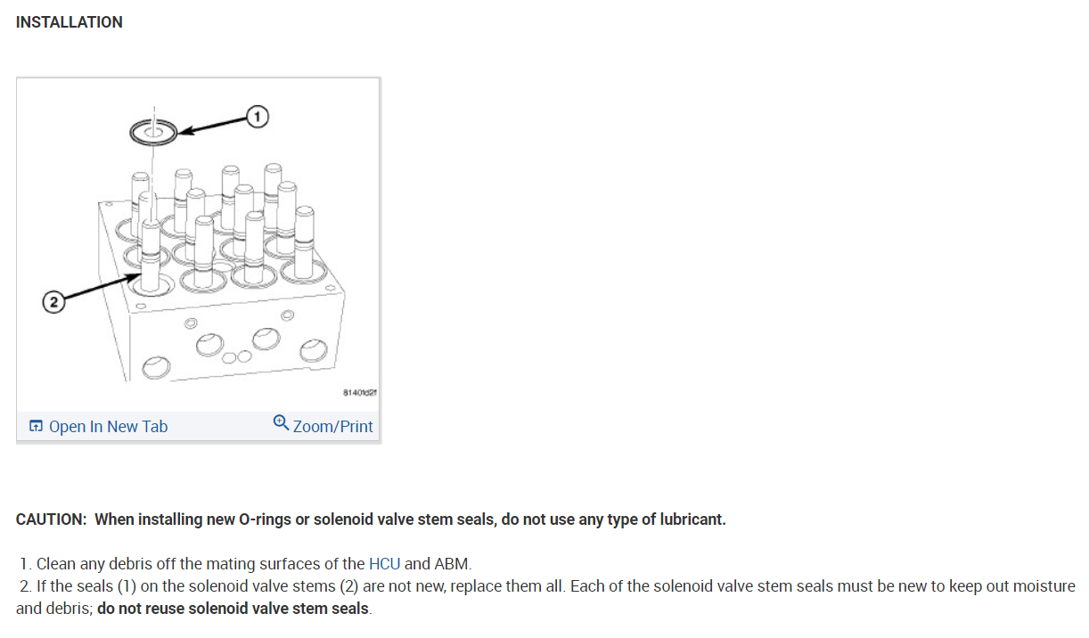

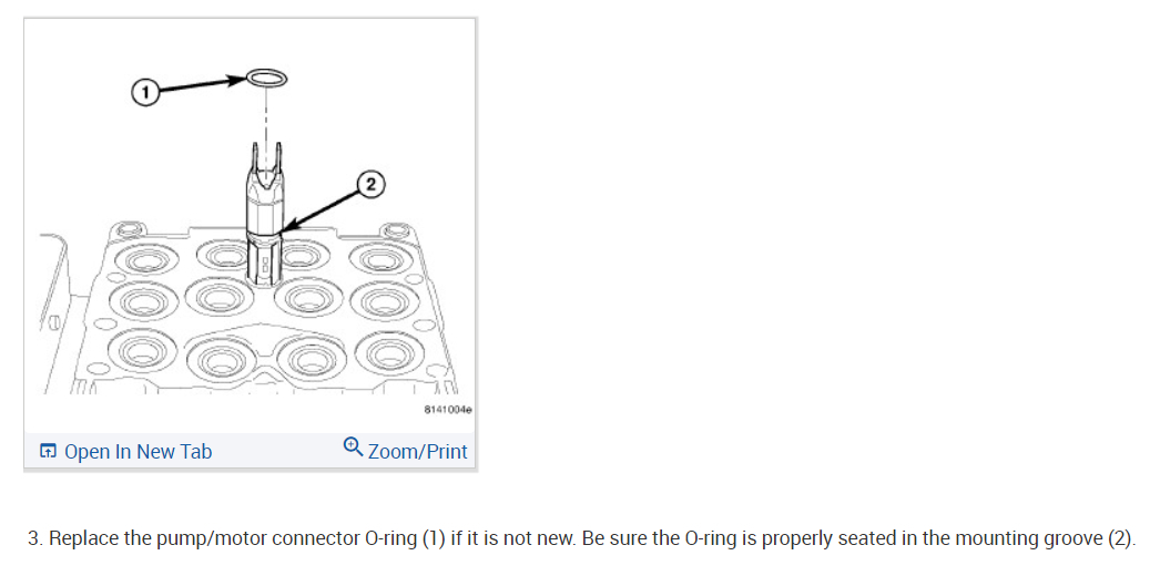

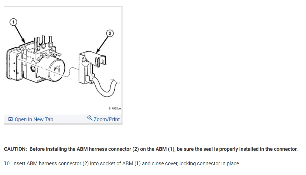

Here are a couple guides that will help with this. The first is on how to scan for ABS codes and the second is to help with replacing the module.
https://youtu.be/rTtAnsOlZU4
https://www.2carpros.com/articles/how-to-replace-a-abs-controller
Below you will find the process from the manual on how to replace this. Please run through this info and we can go from there. Thanks
