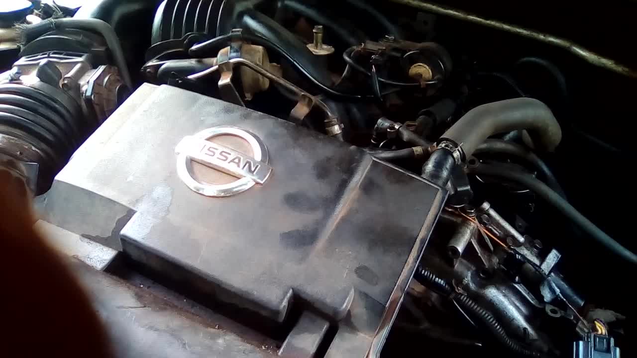

The camshaft actuator can make the engine make a noise and do go out, but can you please shoot a quick video with your phone so I can hear the noise? That way I can tell for sure what's going on. You can upload it here with your response.

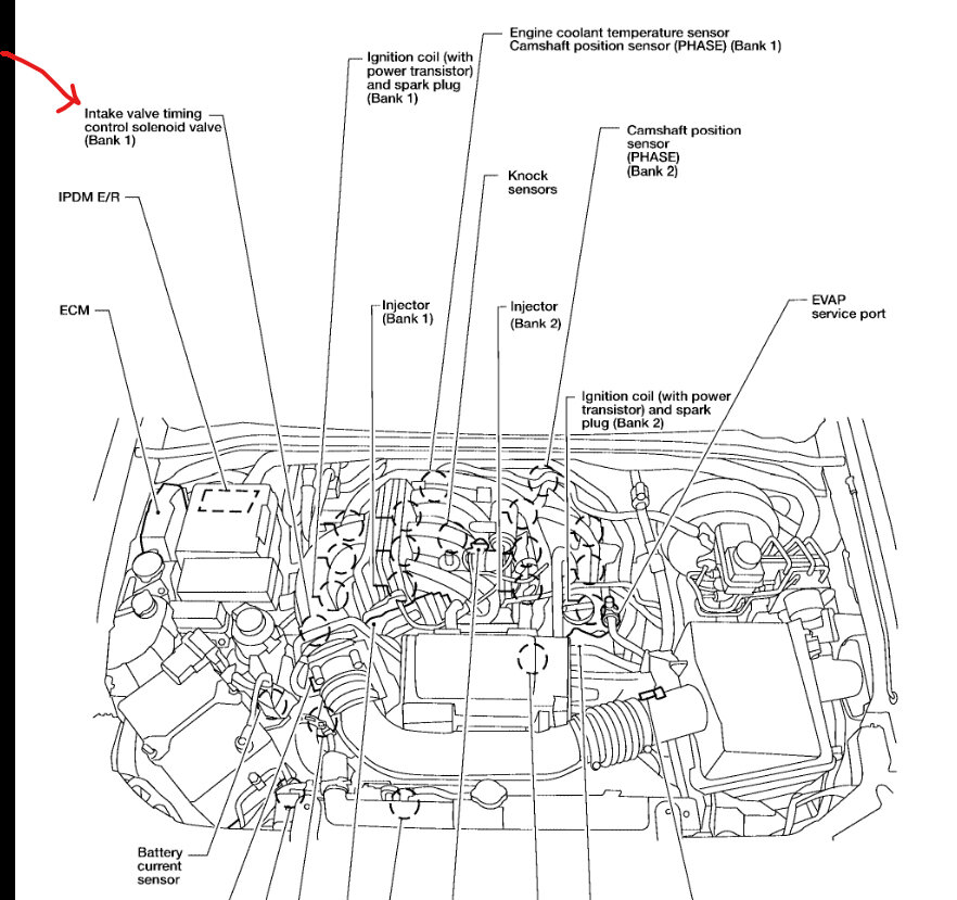

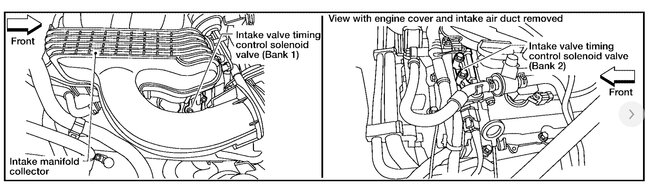

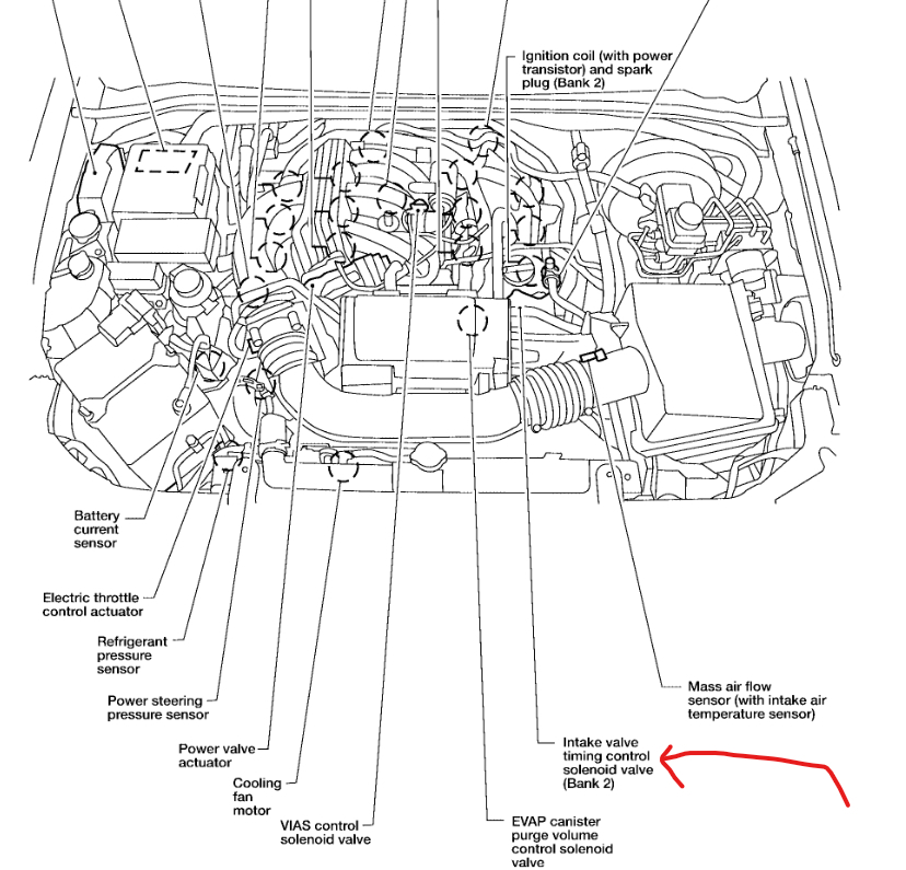

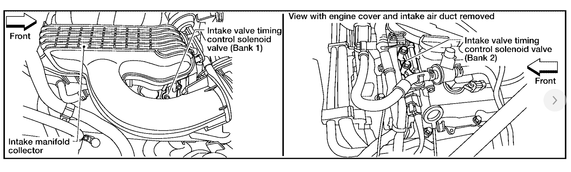

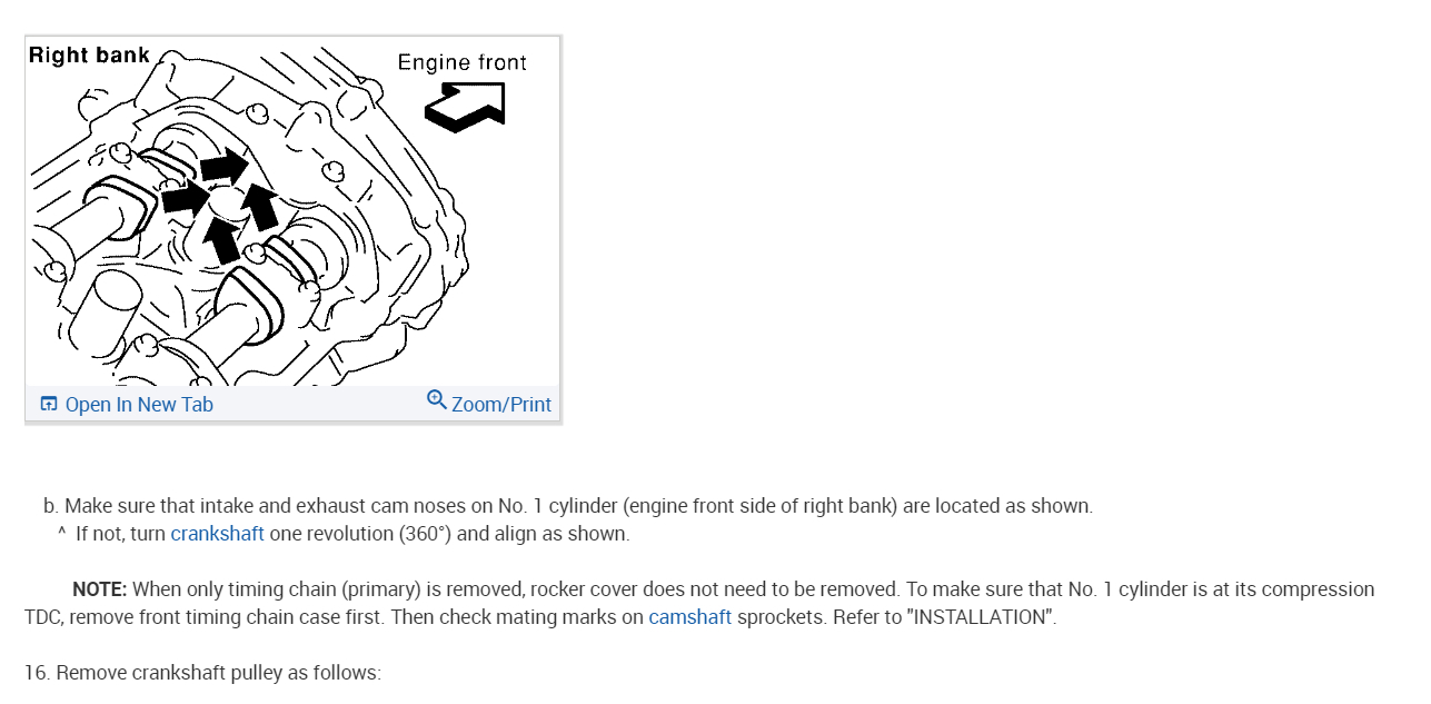

Let it be known that if the timing chains are off, they will make noise as well. Here are the camshaft timing oil control valves to make sure you replaced the correct one. Check out the images (below). Please let us know what happens.
Aug 16, 2023 at 12:18 PM
MALLYBOY
  • 329 POSTS
Yes, that was what I replaced, how do I reset the camshaft actuator to be moderate i.e. not being over advance or over retarded but moderate?

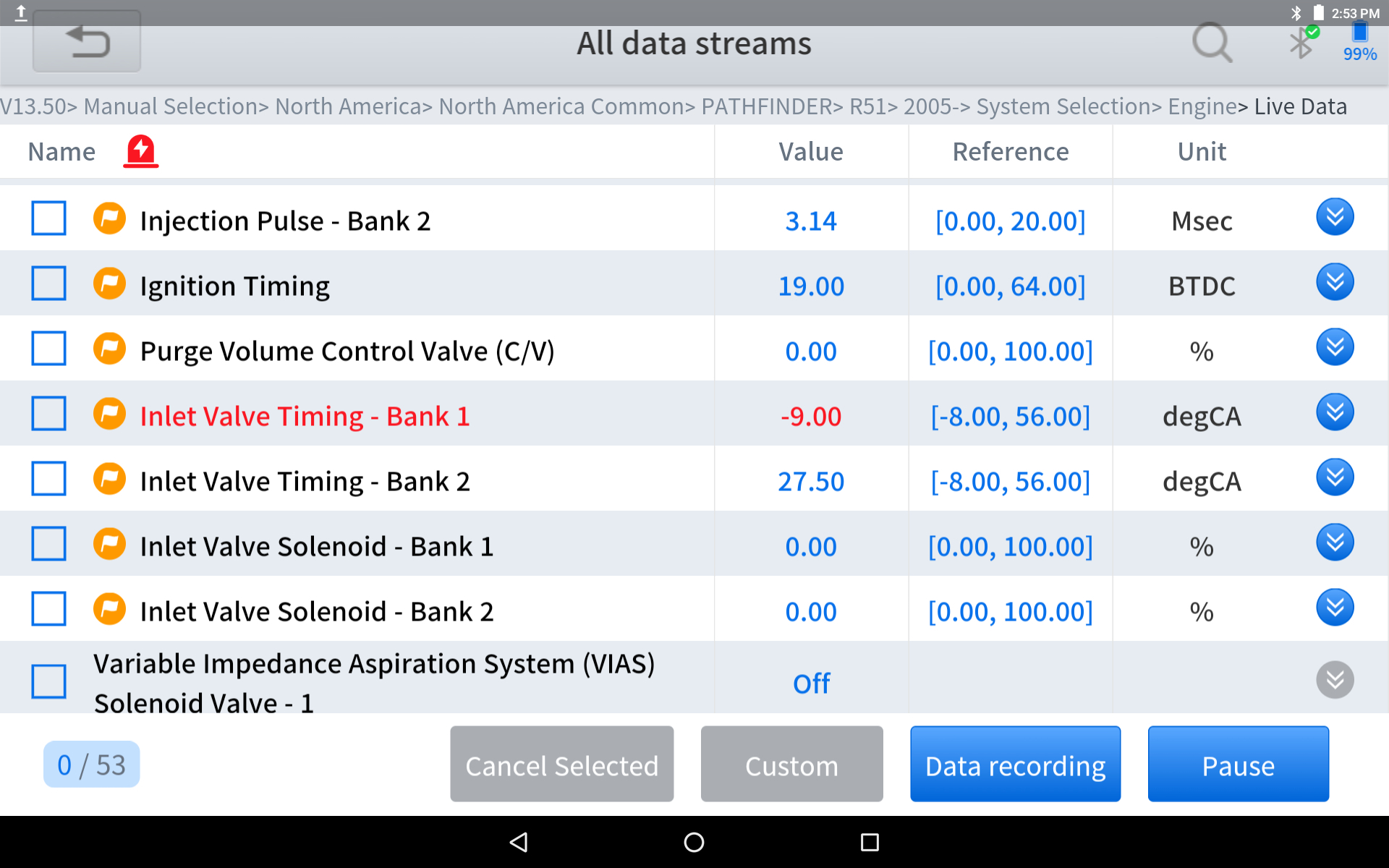

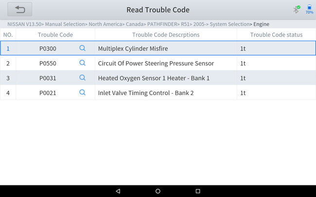

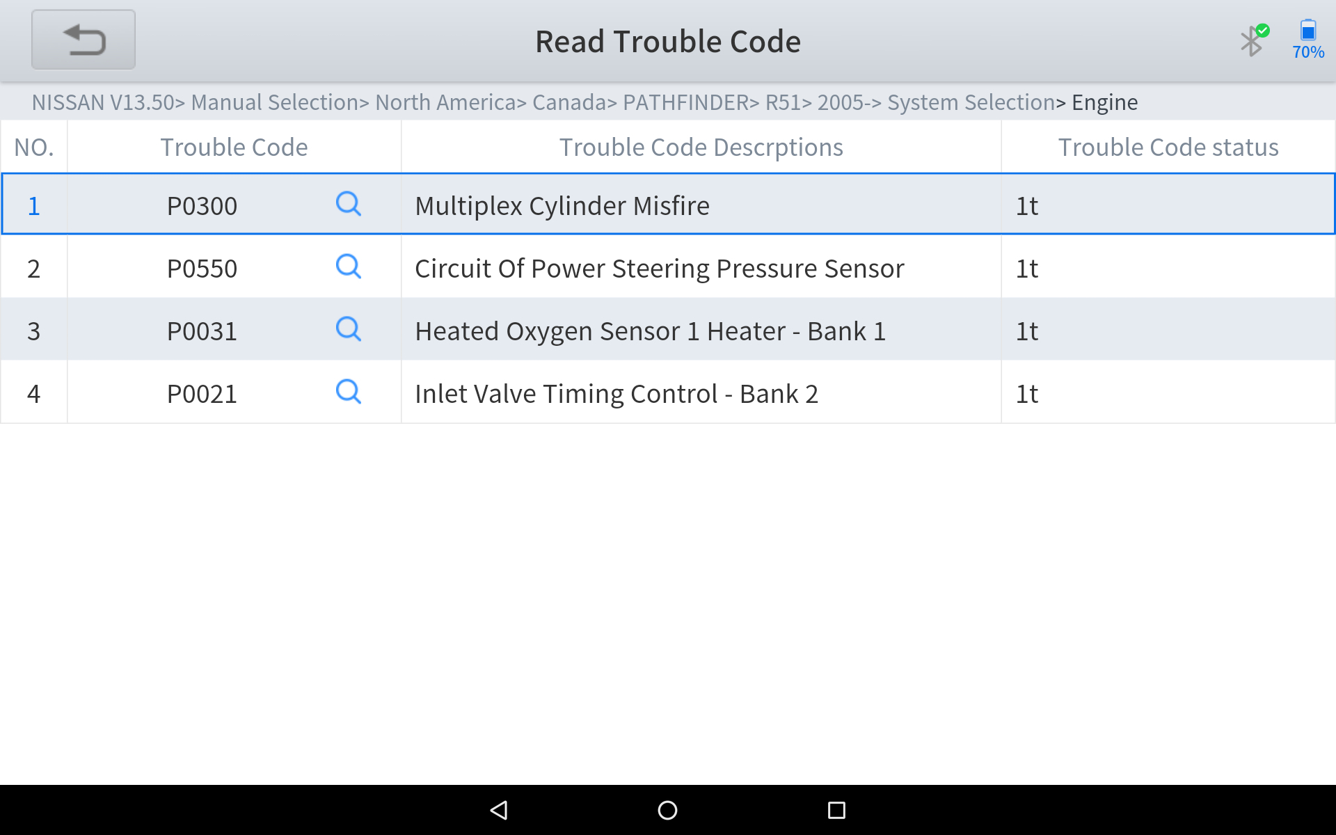

I have replaced used actuator but the noise still remains, I replaced used cylinder head but still remain, I serviced the replaced actuator and put back, it still remains with P0021, from the live data of inlet valve bank 1 and 2, is it that timing is not correct or the oil control valve or the ECM?
I have shot the video, I uploaded the video, the screenshot of live data and screenshot of fault code that return.

The engine noise seems like the timing chain guide is broken or you have a broken piston. Also, the P0021: timing over-advanced or system performance (Bank 2) seems like the camshaft timing is off. Can you please recheck it?

Did you take time to review the Live Data Streaming I sent to you to see whether the inlet valve timing -9(-8.00;56) bank 1 and bank 2 27.56(-8.00;56) are not corresponding?
Also, the P0021: timing over-advanced or system performance (Bank 2) seems like the camshaft timing is off. Did you mean rechecking the timing marks on engine to see whether it all aligned with chain marks? If yes, I will tell you that I have checked that more than 5times using timing diagram from all data repair software.

Yes, I noticed the -9 that's why I wanted you to recheck the timing. Have you done a compression test? If the engine is not good the readings will never be correct. The engine noise has me concerned as well, are the camshaft lobes okay?

That -9 is for inlet valve timing bank 1, which is not showing fault code, Then the (-8.00,56) is the correct valve timing parameter inlet valve bank 1 n'2.
Therefore, inlet valve timing parameter for bank2 is 27.50 but showing fault code while bank1 is -9 but not showing fault code, which one is correct among the two?

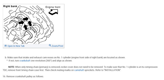

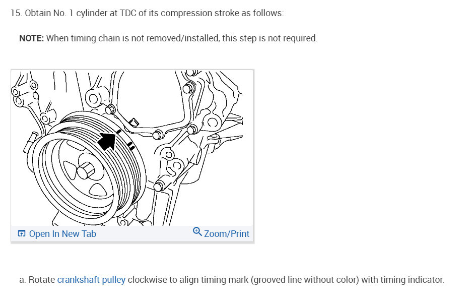

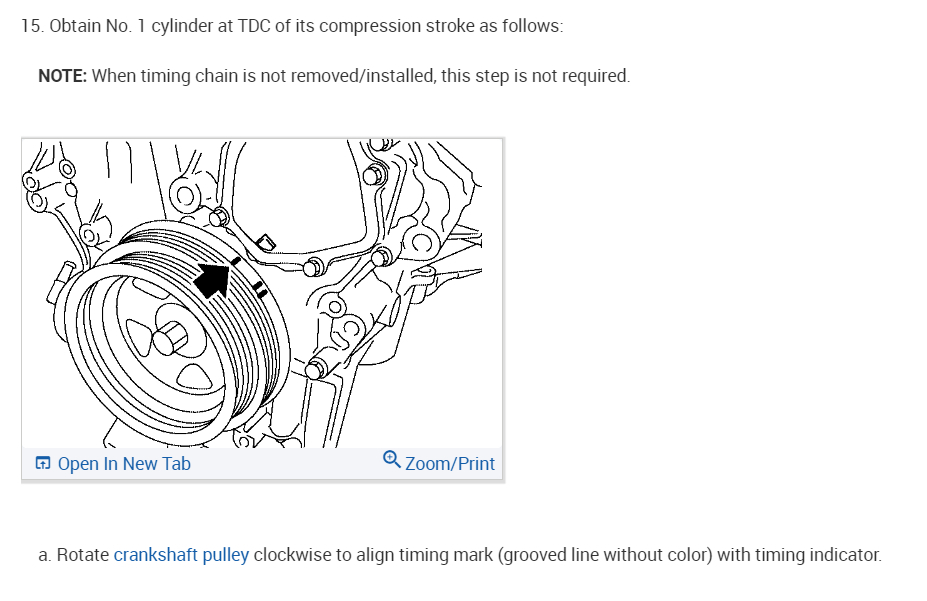

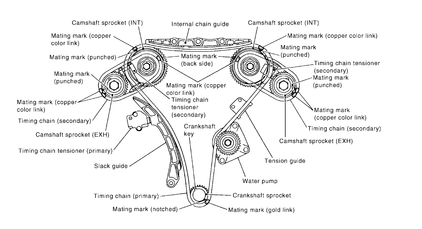

Can you please send me a detailed timing diagram starting from oil pump mark to crankshaft sprocket key to chain mark and cylinder head marks?
Aug 22, 2023 at 12:47 AM
  • 54,840 POSTS
Sure, here you go. Check out the images (below). Please let us know what you find.
Aug 22, 2023 at 11:46 AM
MALLYBOY
  • 329 POSTS
I have taken time to recheck it and notice that the mark on the oil pump housing misaligned from crankshaft key and also exhaust camshaft bank1 deviates from top cylinder mark. If I align the gold mating mark on the chain to crankshaft sprocket mark, it will misalign but if I used teeth before the crankshaft sprocket mating mark to chain, it will align, what do you suggest?

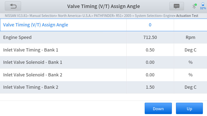

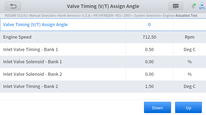

So far so good, I interchange the VVT Actuator from bank2 to bank1 and P0021 changes to P0011. I replaced the VVT actuator for bank1 and that fault code disappeared, but the rattling noise reduced remaining small.
Then the valve parameters for inlet valve timing bank1 drop from -9 to 0.5CA and bank2 drop from 27.50CA to 1.50CA.
Therefore, I still need to replace VVT actuator for bank2 and see if these valve parameters will correspond to 0.5 CA (camshaft angle) and eliminate the small noise remaining.
I attached the screenshot of live data of valve parameters after VVT actuator replacement bank1.

Thanks for getting back to us on this, you are correct the bank2, so you need to replace VVT actuator.
