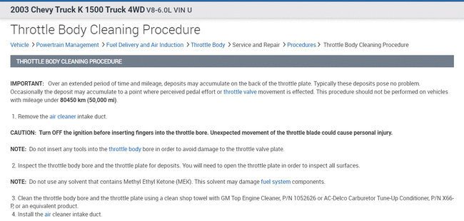

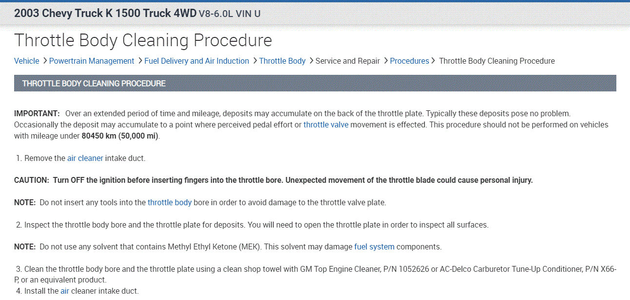

  • 110,244 POSTS
Yes, it will relearn by itself.
Also, here is a link that explains in general how to service a throttle body.
I attached the directions from my manual below. They are vague. LOL
See pic.
