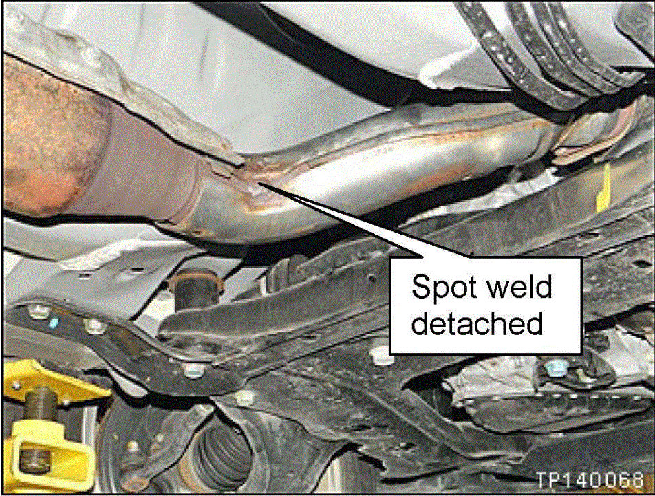

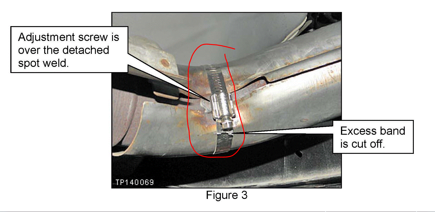

Commonly, it is a heat shield on the exhaust system. The spot welds break allowing it to rattle. Also, it could be the internals in the catalytic converter has come loose.
Here is what to try. Take a rubber mallet and tap on the exhaust to see if you can recreate the noise. If you can, have a helper locate where it is coming from.
Now, I attached two pics below. A short while back, there was a technical service bulletin regarding a heat shield weld breaking and causing noise. The first pic shows the affected heat shield, and pic 2 shows how Nissan recommends repairing it. The pipe is under the vehicle approximately where your feet would be above in the driver's seat.

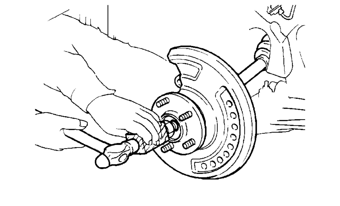

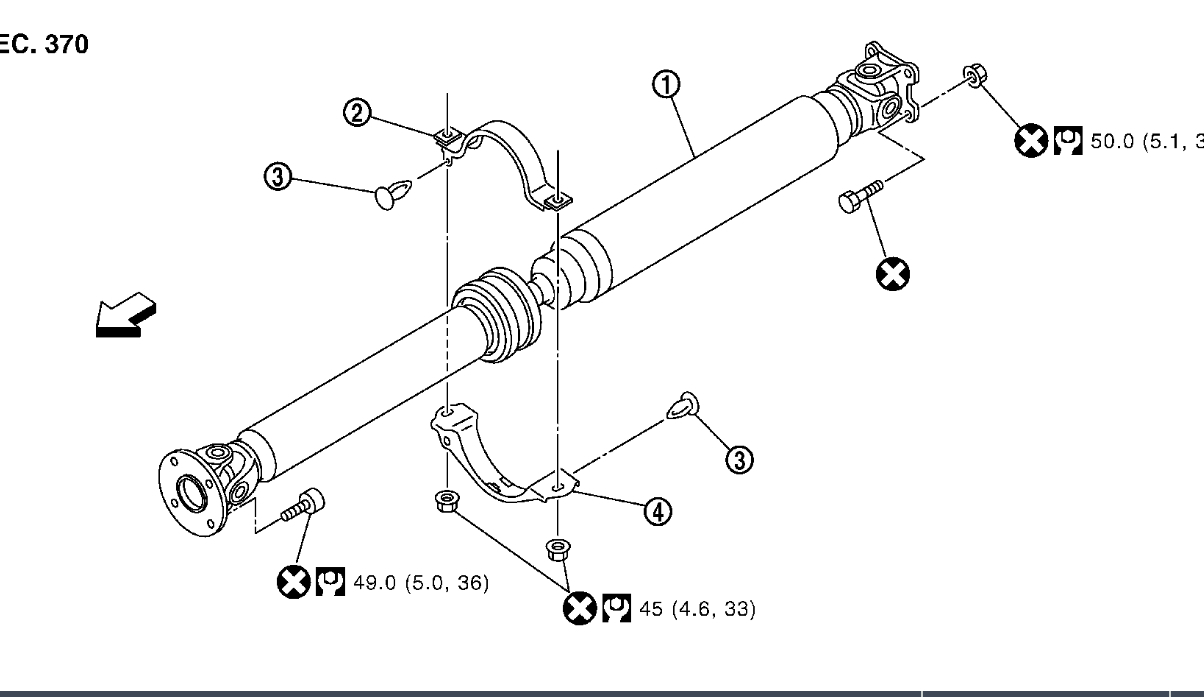

A noise that will come and go at different speeds could be a wheel bearing, C/V joint or propeller shaft. The vehicle should be placed on a hoist or jack stands and check with a mechanics stethoscope.
Note: tire balance can cause a vibration at different speeds also and if severe enough can cause a noise also. If you can record the noise and attach it to the post we could maybe pinpoint it. I'm attaching repair guides and views of propeller shaft and drive axle below. let us know if this is helpful or if you need more info.
