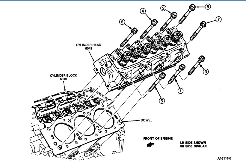

Did the 3.0L Vulcan engine found in the 1994 Ranger have torque-to-yield head bolts or were they "standard" head bolts?
1994 FORD RANGER
150,000 MILES • 3.0L • V6 • 4WD • MANUAL
BLAZ85
  • 54 POSTS
I am trying to help a friend with his "beater" truck and have a question concerning the head bolts.
Did the 3.0L Vulcan engine found in the 1994 Ranger have torque-to-yield head bolts or were they "standard" head bolts? What I am trying to find out is it really necessary to replace the existing bolts since it is just a "beater"?
Also, could you provide the torque specifications for both cases?

I looked up replacement in the manual and there is a two-step process, so I have to call them torque to yield.
If you look at the attached pic, it provides the process.
Let me know if this helps
See pics below. Pic 1 is the torque and pic 2 provides the sequence.

That's what I thought, just hoping for "standard" bolts to avoid the extra cost. New TTY bolts it shall be.
