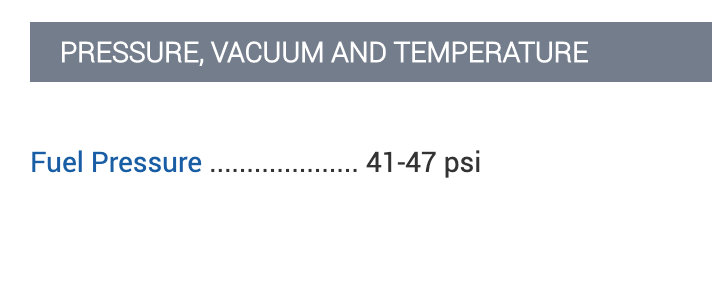

If you can access a fuel gauge you will need to route the gauge so that you can see it from inside the car and then monitor the fuel pressure.
Fuel pressure should be 41-47psi
Let us know which you are missing and we can run you though checking the system.

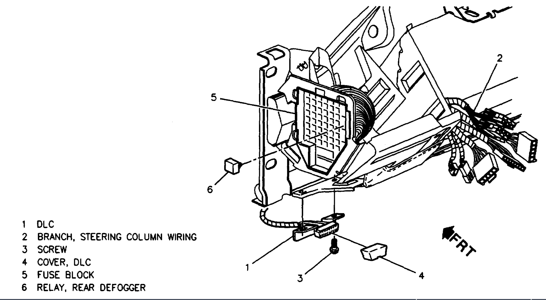

Have you already checked for engine management fault codes?
I would advise this is a good starting point if not done already.
Guide below:
The OBD II port is shown in the picture attached, labeled as the DLC.
