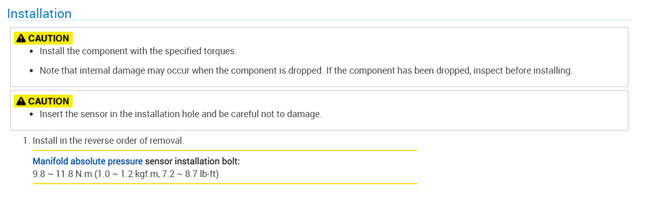

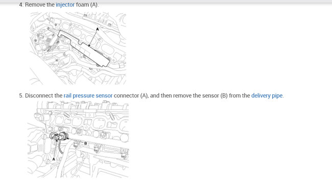

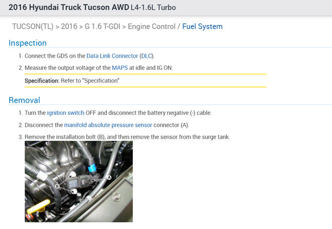

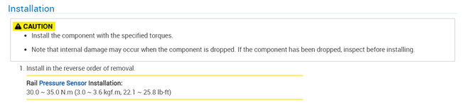

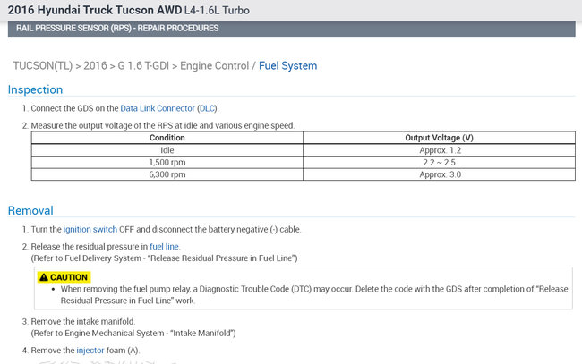

I have seen both the fuel pressure sensor and the MAP sensor cause this problem which is the value of the sensor changes a little which affects the fuel mixture, when this happens it is not enough to give a trouble code for the sensor just the results of the failure which is the multiple misfire codes. I would try the MAP sensor fist here is the location of both sensors in the images below. Please let us know what happens.
