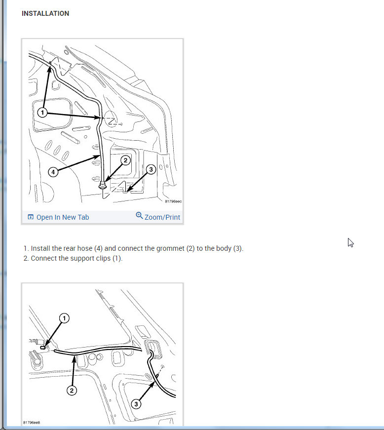

Whenever it rains the passenger side floor will get wet. Water seems to coming in underneath the plastic trim along the the floor where the door closes. The door itself stays dry and all other areas remain dry as well. It is just the carpet. The problem seems to have gotten worse the last few months. It does not matter if I am driving or if the jeep is parked, the carpet will get soaked with a good hard rain. Any help is much appreciated!
Nov 25, 2014 at 9:33 AM

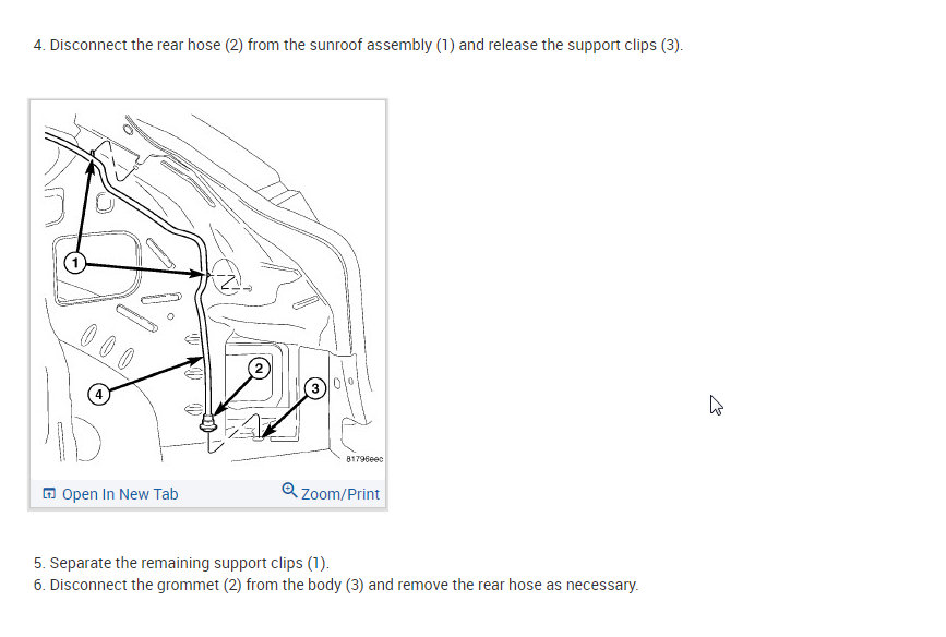

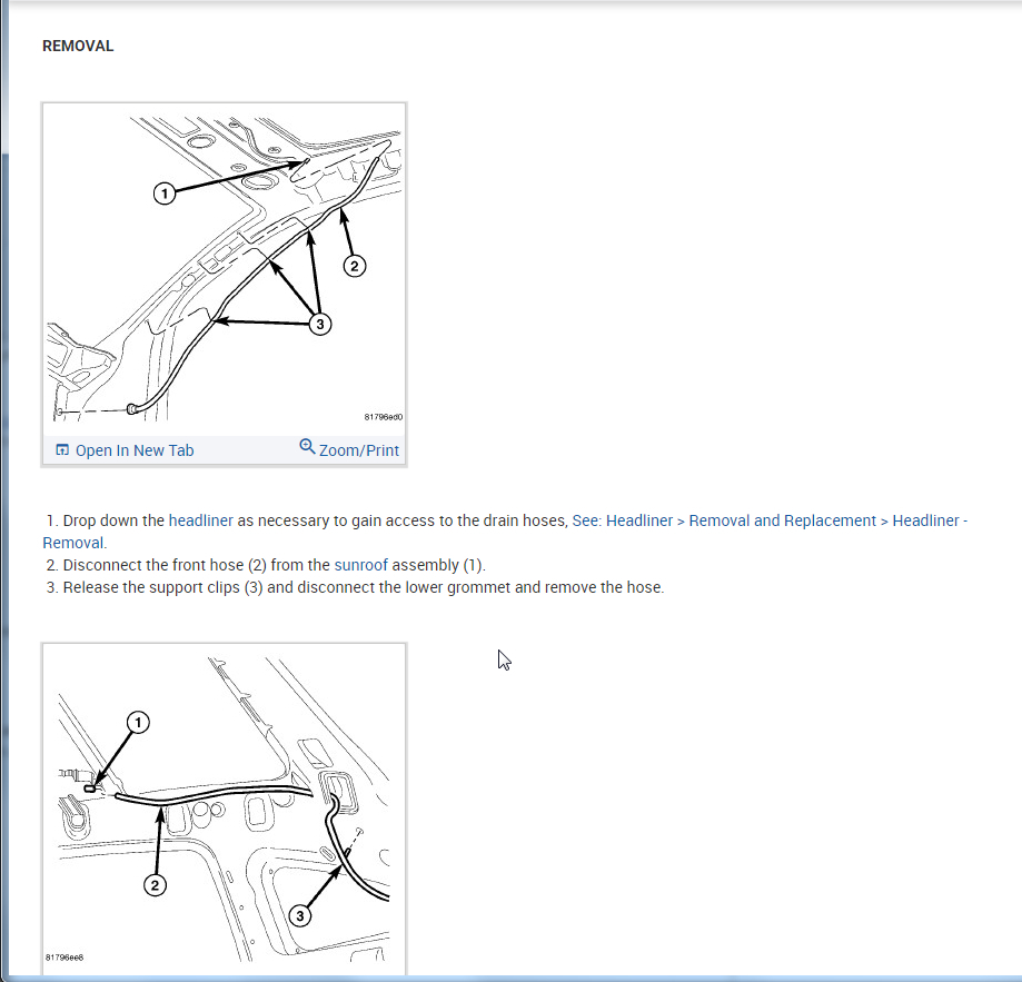

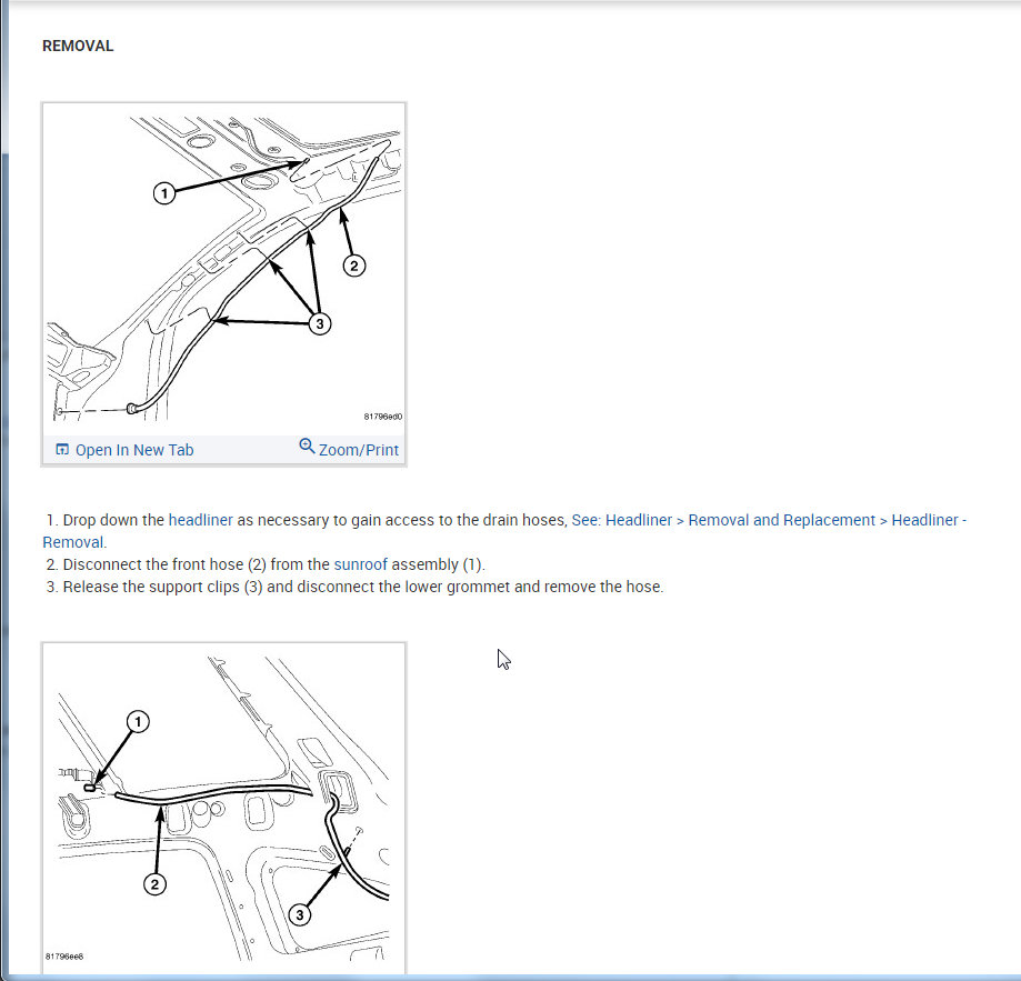

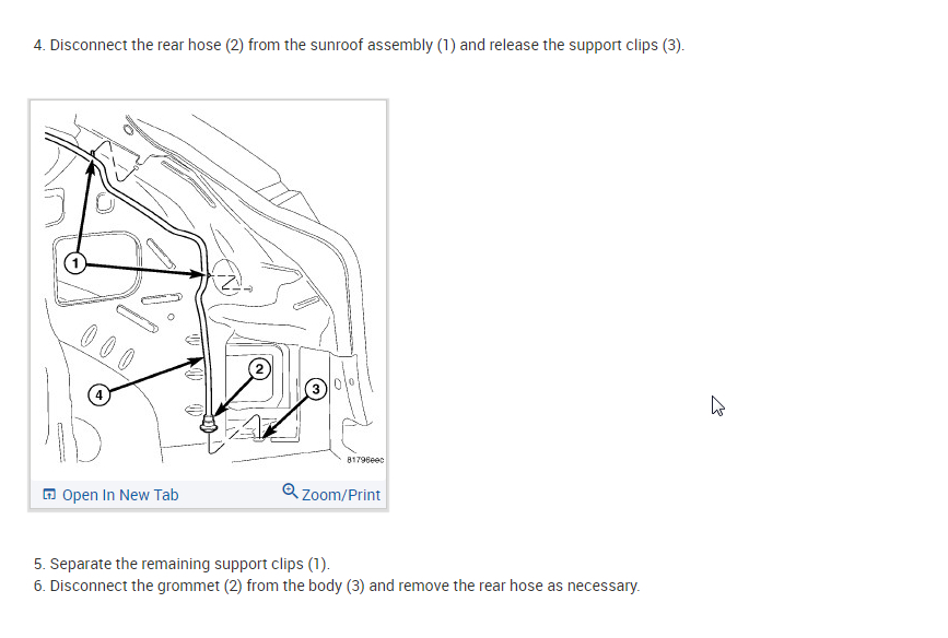

I suspect you have a sun roof and if you do then most likely the front drain tube on that side is leaking. It runs down the A pillar and connects to a grommet on the front firewall of the vehicle.
I attached the process below on how to replace this. I suspect you can reconnect it but I would suggest just replacing it if it is not found to be unhooked as you have a split in the line somewhere.
Let us know if you have questions. Thanks
