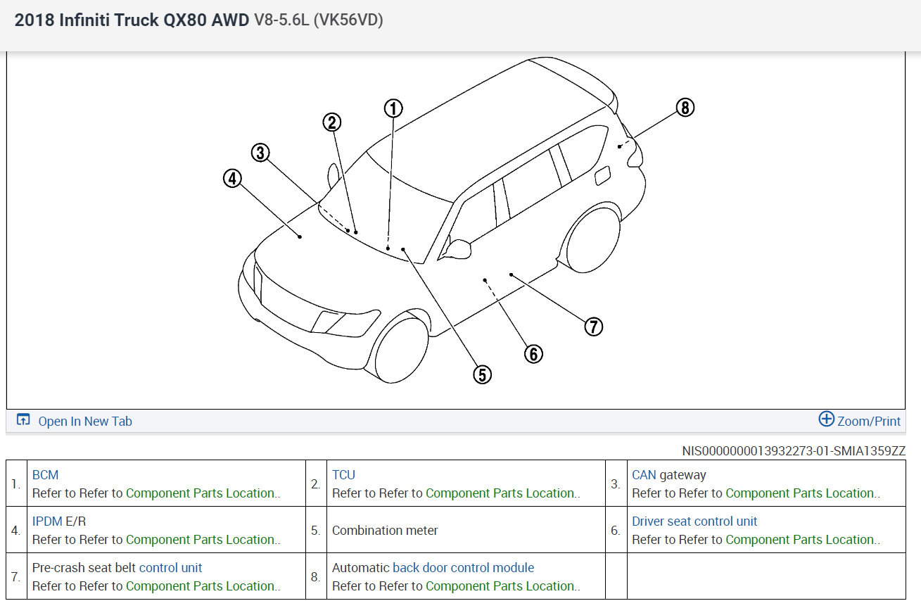

The car will not power on after leaving the sunroof open and it rained?
2018 INFINITI QX80
76,000 MILES
JONES112M
My car won’t power on after I left my sunroof open over night.
Aug 21, 2024 at 5:26 PM
  • 54,832 POSTS

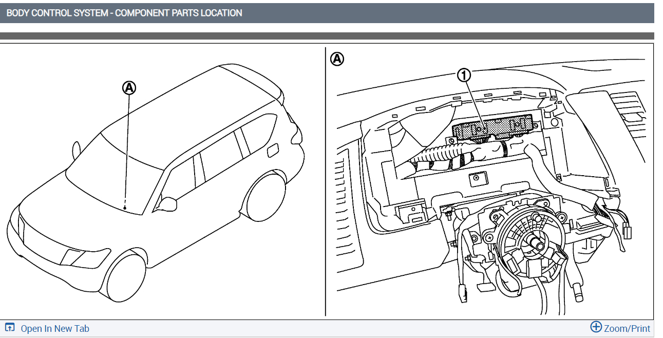

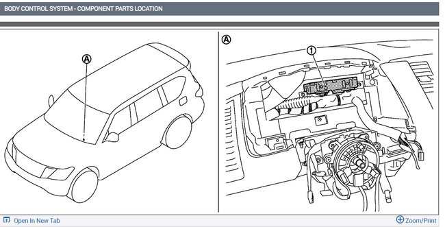

Yep, electronics do not like that at all. Can you please upload a video of what's going on so I can see? Do any lights come on? We need more information to help you. From what I can see the BCM may have got wet. We should run a CAN scan to see which codes come up to be sure that is the problem. You can get a CAN scanner (Controller Area Network) which will work on most cars from Amazon.
https://youtu.be/u-4syLc-ifQ
Here is the location of the BCM so you can check it out. Check out the images (below). Please upload pictures or videos in your response of any problems so we can see what to help you with.
