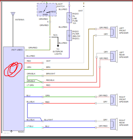

The cassette receiver stereo without a plug on the bask. The wire colors are, red, black, light green, light blue, green, green/black, blue, blue/black, and blue/red. Nowhere on the internet can I fined this combination. Can someone please tell me what the colors go to?

Hello, I am Danny.
I have attached a picture of your vehicle's radio wiring diagram. I circled the radio in red. Hope this helps and thanks for using 2CarPros.
