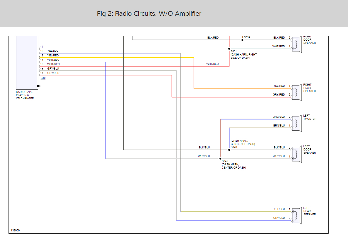

I have checked all fuses and wiring. I have power to radio and radio will not stay on. In fact when I push the button in to turn it on it seems to go off. I thought the radio was bad and replaced it with a new used radio that is 100% working. I put it in and have the same thing happen. Not sure where to go next.

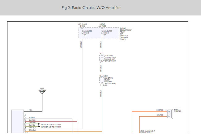

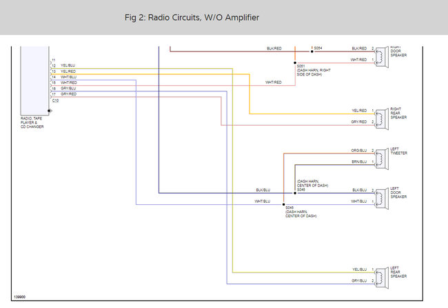

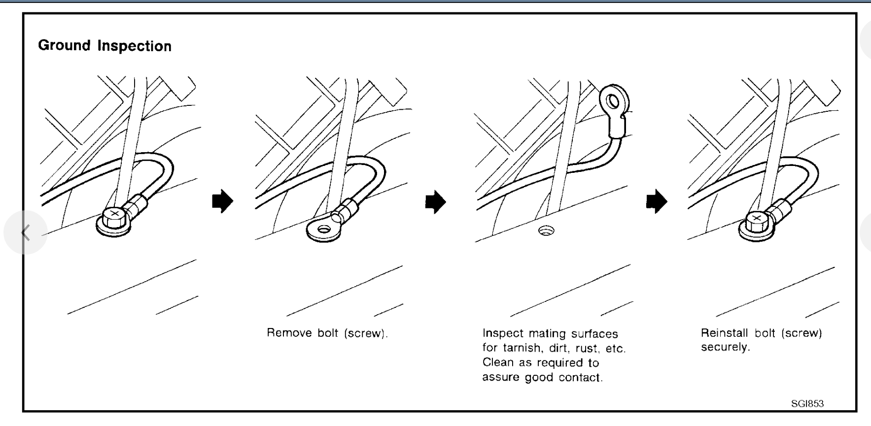

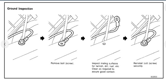

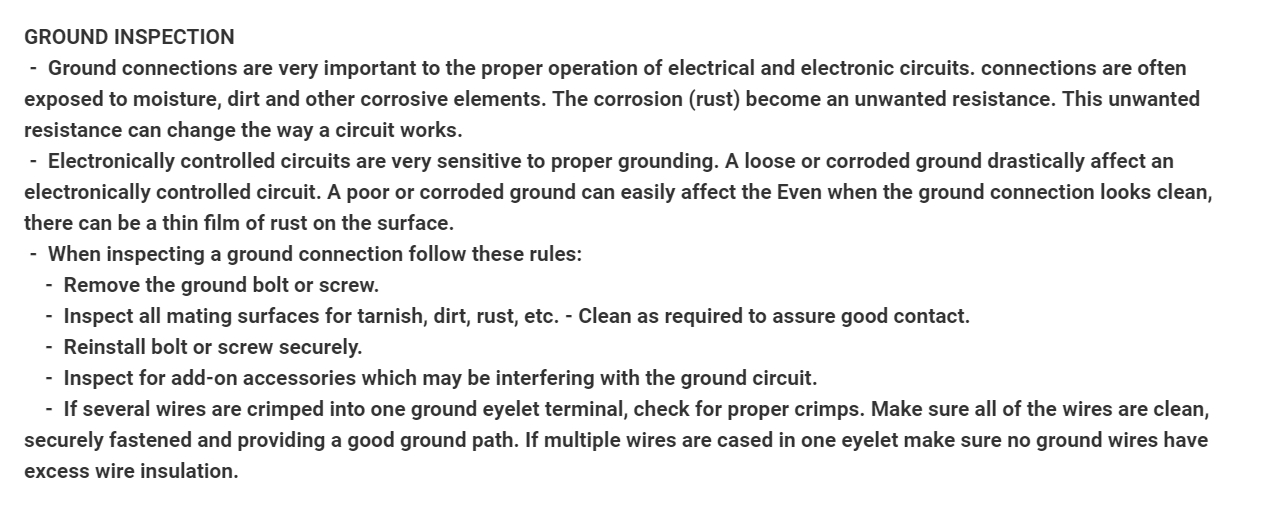

In the diagrams down below I have included a wiring diagram for your vehicle's radio. I would double check the ground for the radio. It appears to not be a wire but possibly a mounting screw/bolt to hold it in place. Make sure that the ground is clean, tight, corrosion free, and making good metal to metal contact. I have included a guide for inspecting grounds in the diagrams down below for you as well. Please let us know what you are able to find.

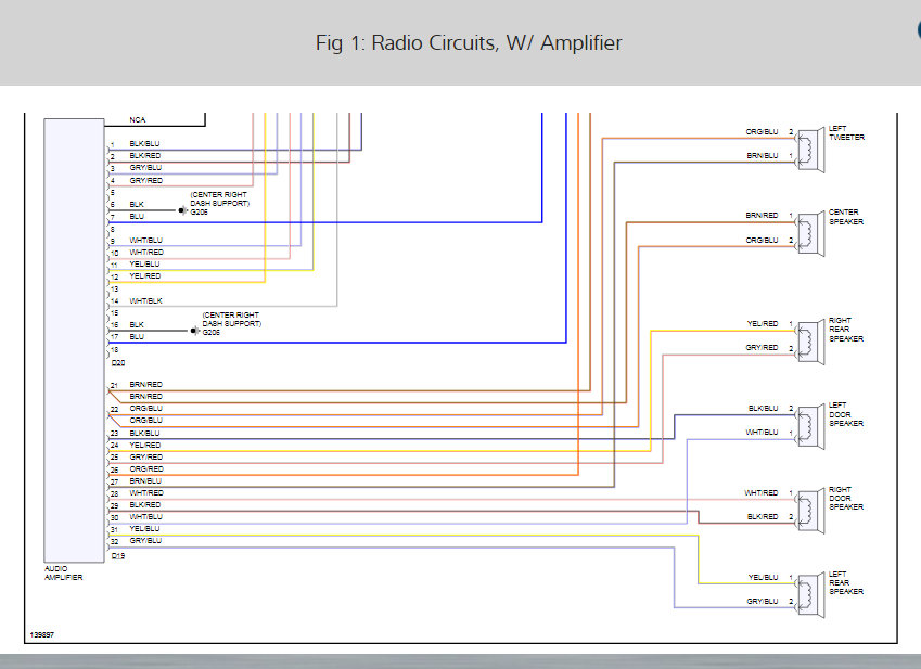

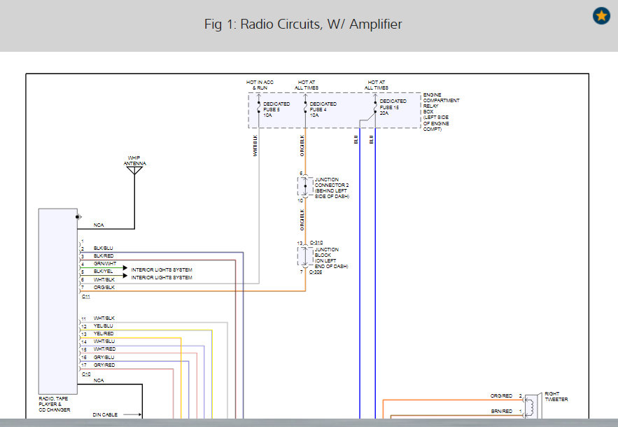

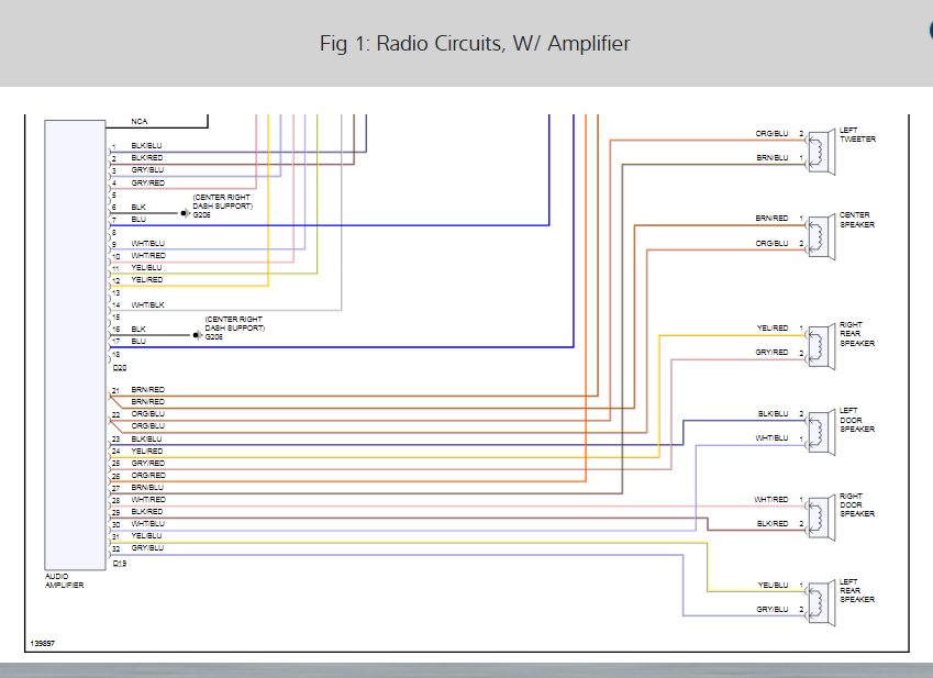

Here are your wiring diagrams for your stereo with an amplifier. Please use these wiring diagrams to diagnose your stereo's problem and get back to us with what you are able to find out.
Thanks,
Alex
2CarPros
Jul 22, 2019 at 10:31 AM
ERNEST BUCK
I think you forgot to include the wireing diagram
Jul 22, 2019 at 11:48 AM
SCGRANTURISMO
  • 4,897 POSTS
Hello again,
I'm sorry about that. Here is the wiring diagram for you, in the diagrams down below. Please keep us informed as to how things are proceeding, or don't hesitate to ask if you have any other questions.
