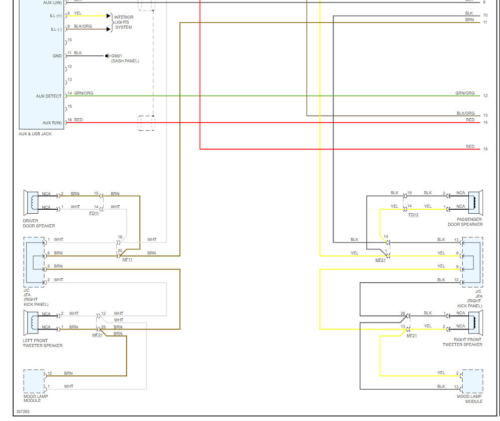

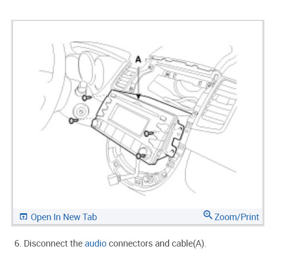

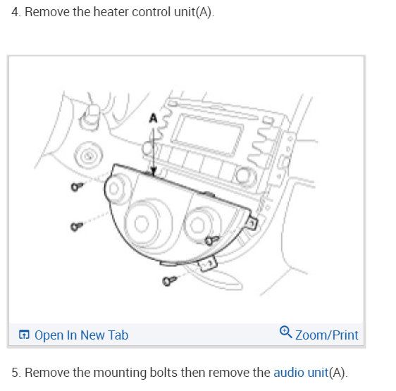

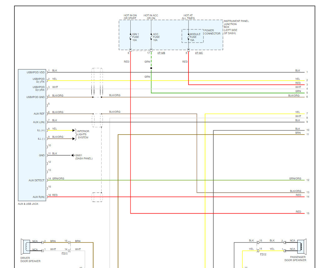

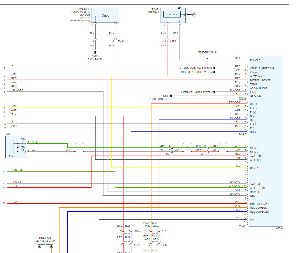

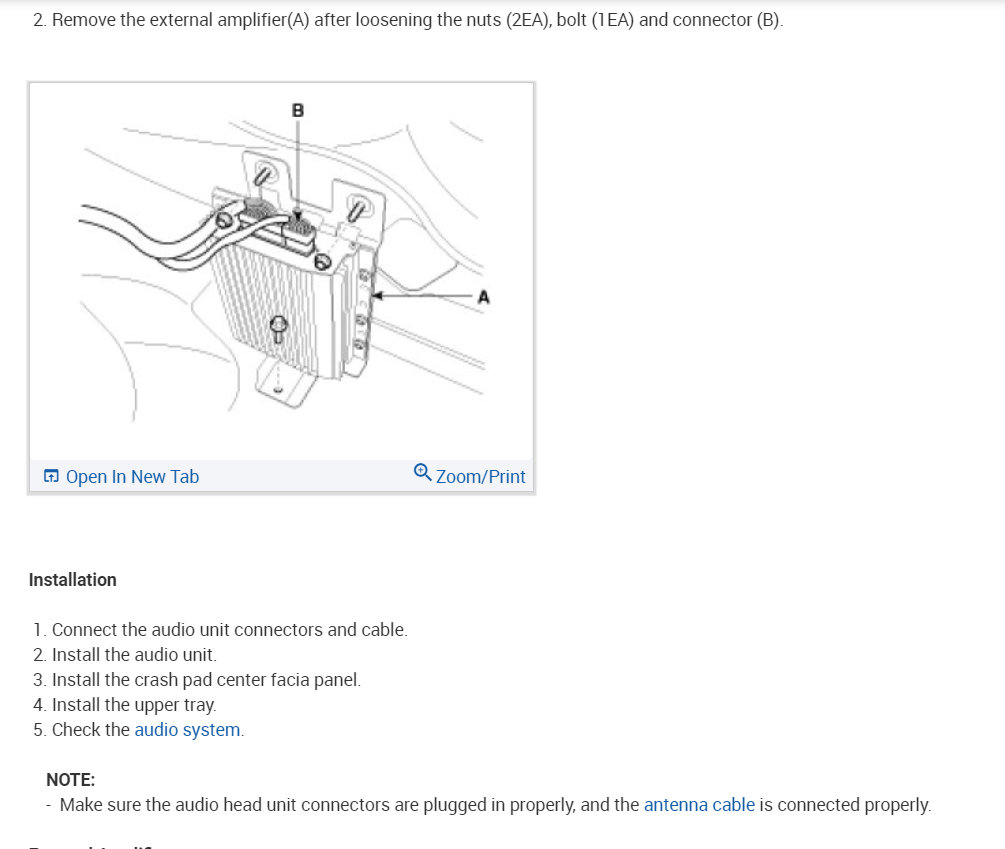

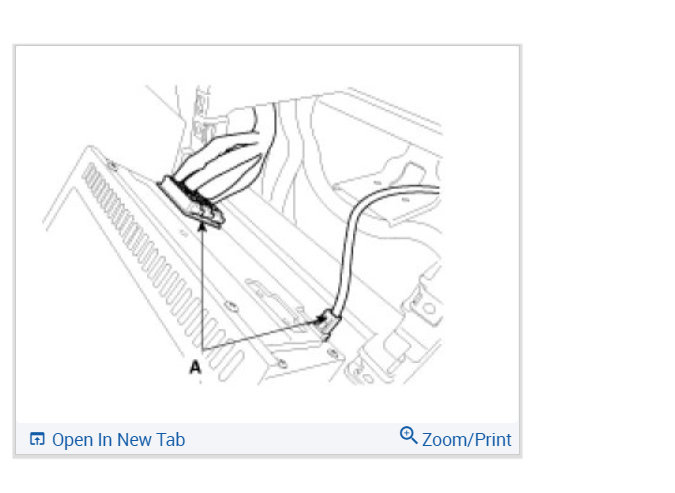

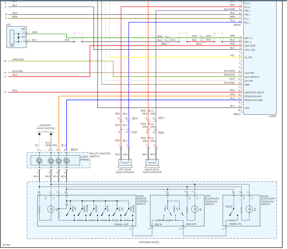

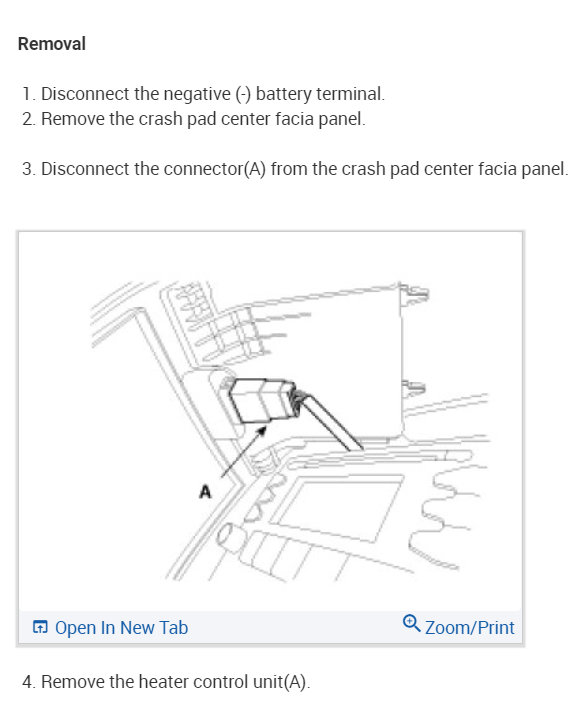

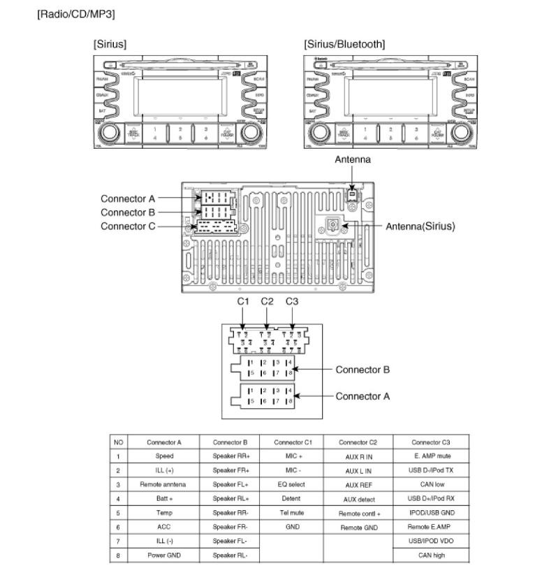

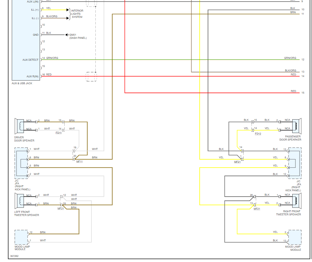

When you turn the radio on does it light up? if so it sounds like the unit has gone bad and needs replacement you can try rebooting it by disconnecting and reconnecting the battery. Here is a video of the job being done on a similar car. Also does this car have an amp? Here are diagrams below for the wiring and how to replace the head unit and amp.
