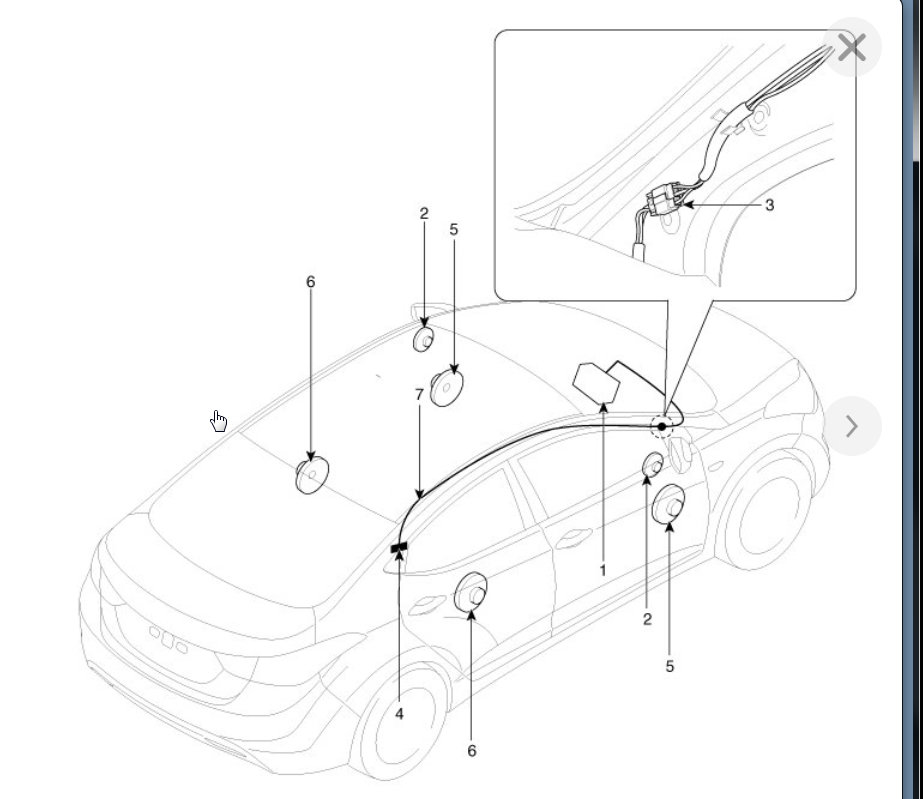

My car CD player works perfect and sounds perfect coming from the speakers but the radio won’t work. Odd times it will play for less than a minute then nothing, my iPhone plugged into the aux connect will work but the sound is fuzzy?
Sep 17, 2020 at 3:22 AM
This is very common on a failing radio unit. Unfortunately we don't have a manual on your vehicle due to it not being offered in the USA. However, this is not much different then the vehicle that is offered here.
Due to the audio working on other inputs that shows the speakers and amp are working properly. So that leaves the radio. If it were me, I would replace the radio and retest the issue.
Sorry we can't offer specifics but I am confident that is where the issue is. Thanks
