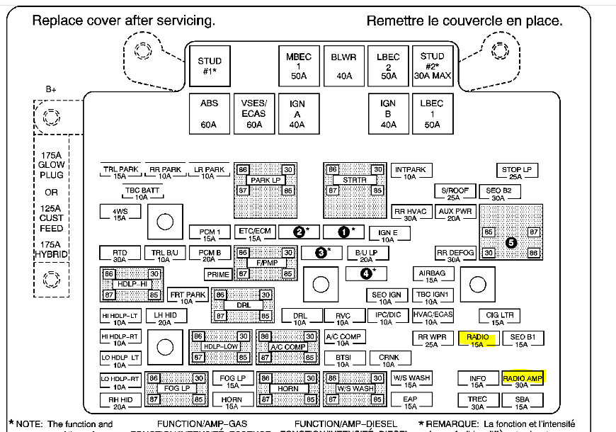

So, I was trying to install an aftermarket radio. I got everything wired and went to plug it in. Some sparks shot from one of the wires for about a second and then stopped. The radio did not work. I then plugged in the factory radio, and it wouldn't work either. I'm sure it's not receiving any power, but how do I diagnose what's wrong/how do I fix it?
Aug 22, 2023 at 11:56 AM
  • 110,240 POSTS

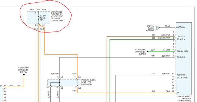

It sounds like a fuse may have failed. I'm not sure which system this came with, but I think the best place to start is by checking the radio fuse. There is also an optional amp fuse. Both fuses are in the under-hood fuse box. See pics below.
When checking the fuse, it is important to check its condition. Also, it is important to confirm there is power to and from it.
Here is a link explaining how that is done:
Do this and let me know what you find. Also, if you know the wire color that sparked, it may help me.

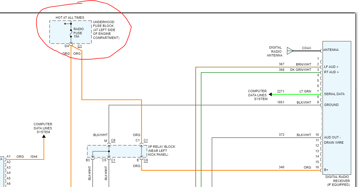

Did you confirm there is power to and from the fuse? Also, if the fuse is good and has power, we need to see if the power gets to the radio.
Let me know if you checked power. Please bear with me. Not knowing what wire sparked makes it very difficult to tell you exactly what to check. I'm trying. LOL
However, if the radios no longer get power, I still suspect the fuse itself is faulty or we lost power to and from it. If it was a different wire, the radio fuse would still likely be good and the radio would get power.
If you check out the link I attached above, it explains how to check for power.
