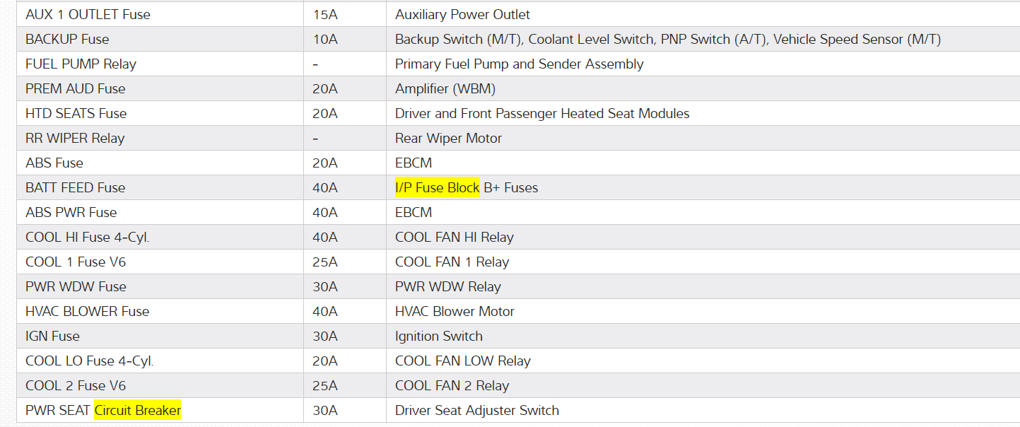

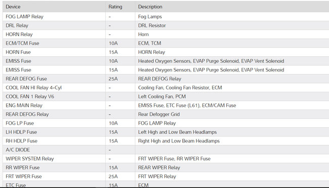

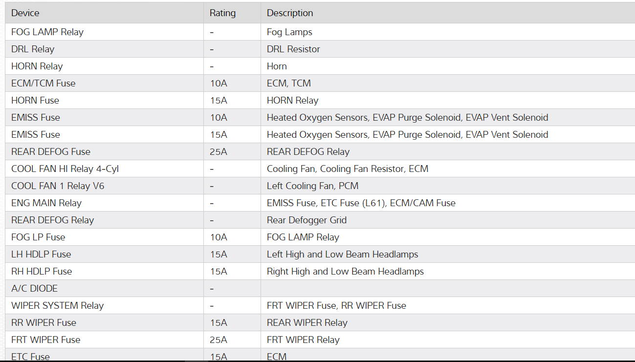

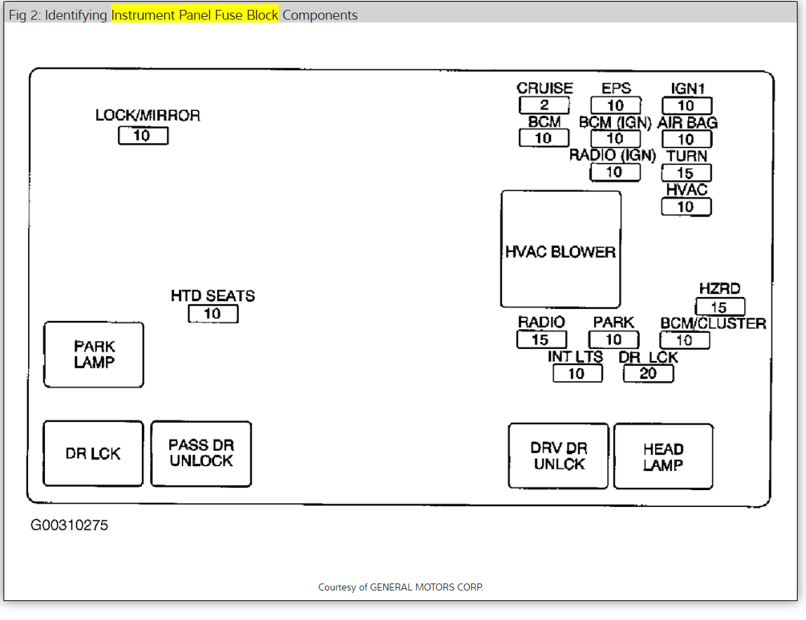

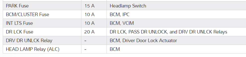

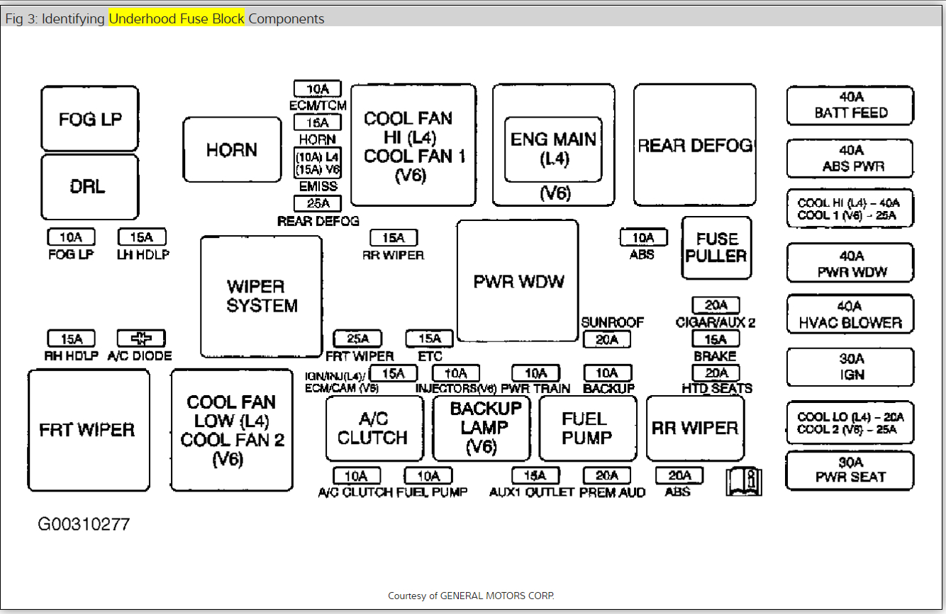

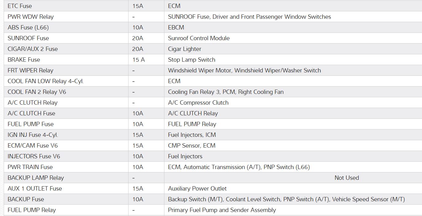

At first the radio had no light then I gave it a flick and it came on, once I turn the vehicle off it has been off ever since. also, my daytime running lights sometimes work and sometimes do not and I am not sure why. please advise. thank you.
Mar 31, 2018 at 8:50 PM
  • 54,832 POSTS

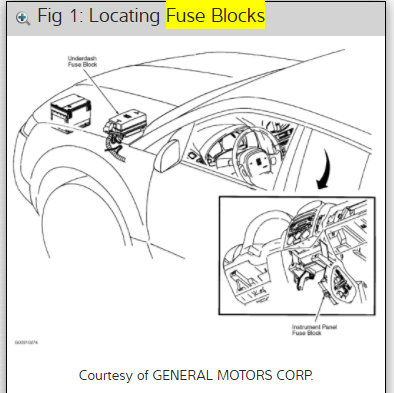

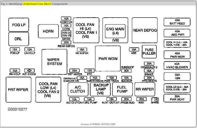

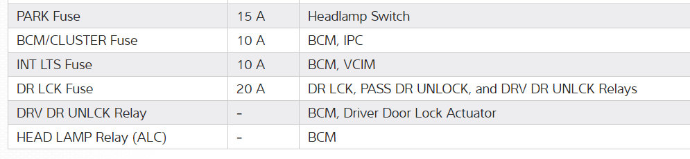

this sounds like two different problems. first, the radio light sounds like it is out and needs to be replaced is it LCD? As far as the DRL you have a relay that needs to be checked. Here is a guide to help you:
