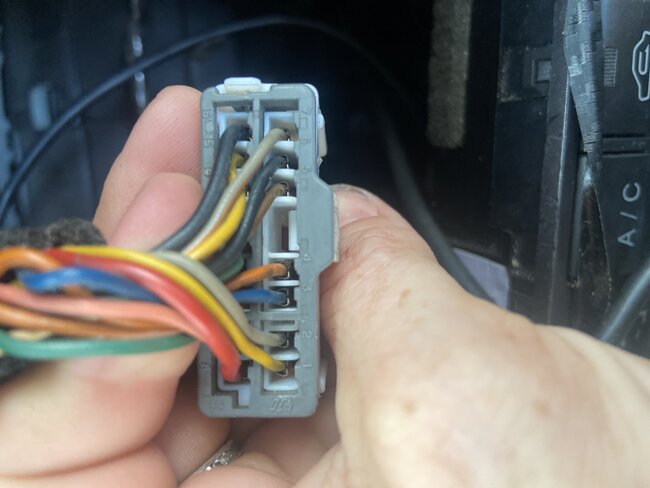

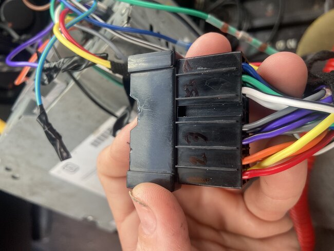

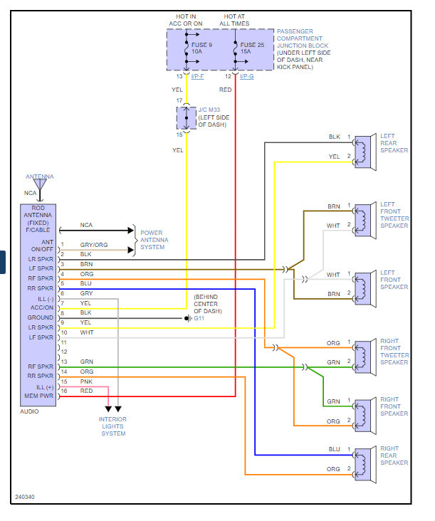

I'm in need of a correct dash radio harness diagram for a 2006 Hyundai Elantra. I'm installing a aftermarket Kenwood Radio DDX367BT and a Metra 99-07 connecter Harness. I have the wiring diagram for the radio and the Metra but every form i find has mismatched info. My drivers side front speaker isn't working. The passenger side front is predominantly louder then the other 3. I just need the correct color coded wiring diagram for the dash car harness please
Thank you
Jan 28, 2023 at 12:42 PM
  • 55,224 POSTS

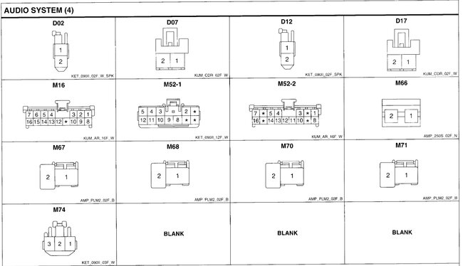

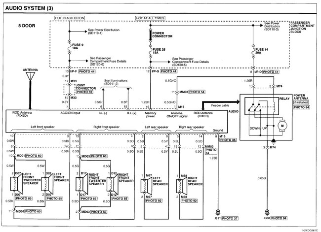

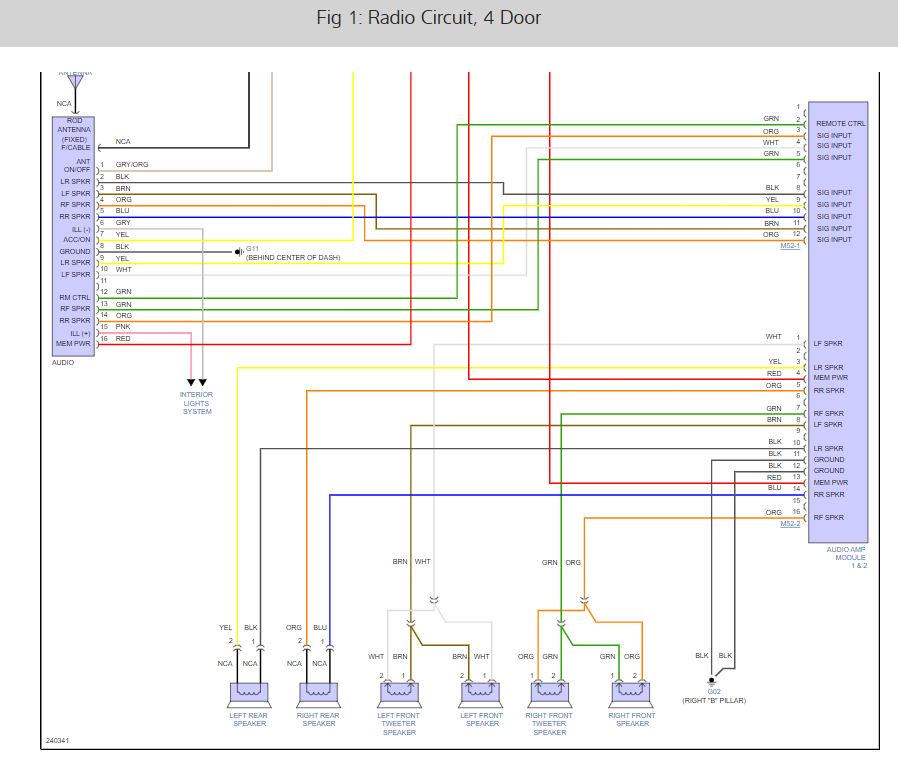

Sure, here is the radio wiring for the 4 and 5 door systems, I have also included a guide on how to test the wiring connections.
Check out the images (below). Please let us know if you need anything else to get the problem fixed.

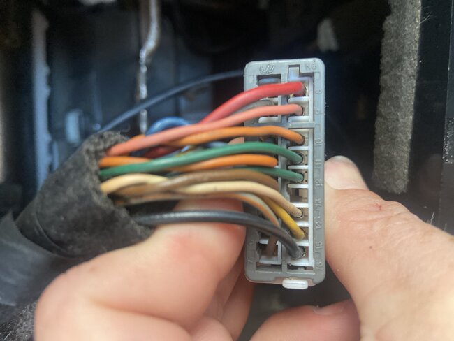

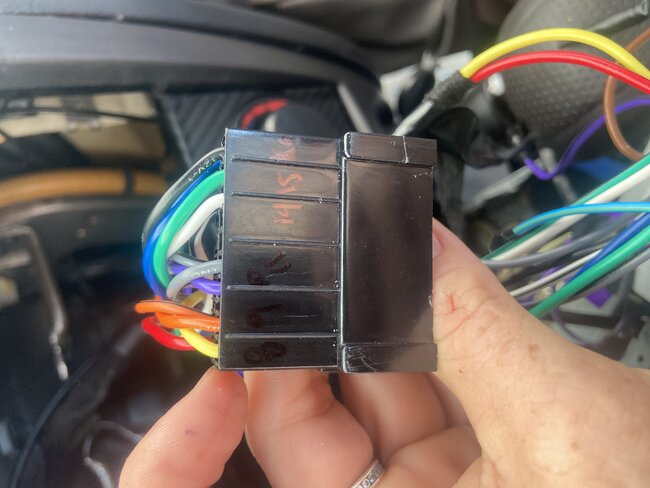

The wiring guide I have for a 2006 Elantra is completely wrong on my end. I have a 16-pin connector. Pin 1 is Yellow, pin 2 grey/bc blk, 3 blue, 4 orange/blk, 5 brown, 6 black (thin wire) pin 7 grey/orange
I only have power on the first pin and grounded pins on the radio side “1,2,5,8,9,14,16” weak ground on 14. This is radio harness car off, car on-12v only to pin 1. How does that pave a positive reading and a negative one when cars off? This is the thin yellow wire.
The radio is a ddx276bt. Sorry, I mistyped it the first time.

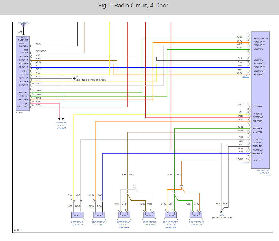

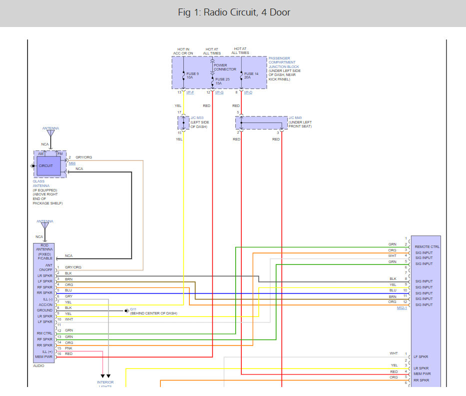

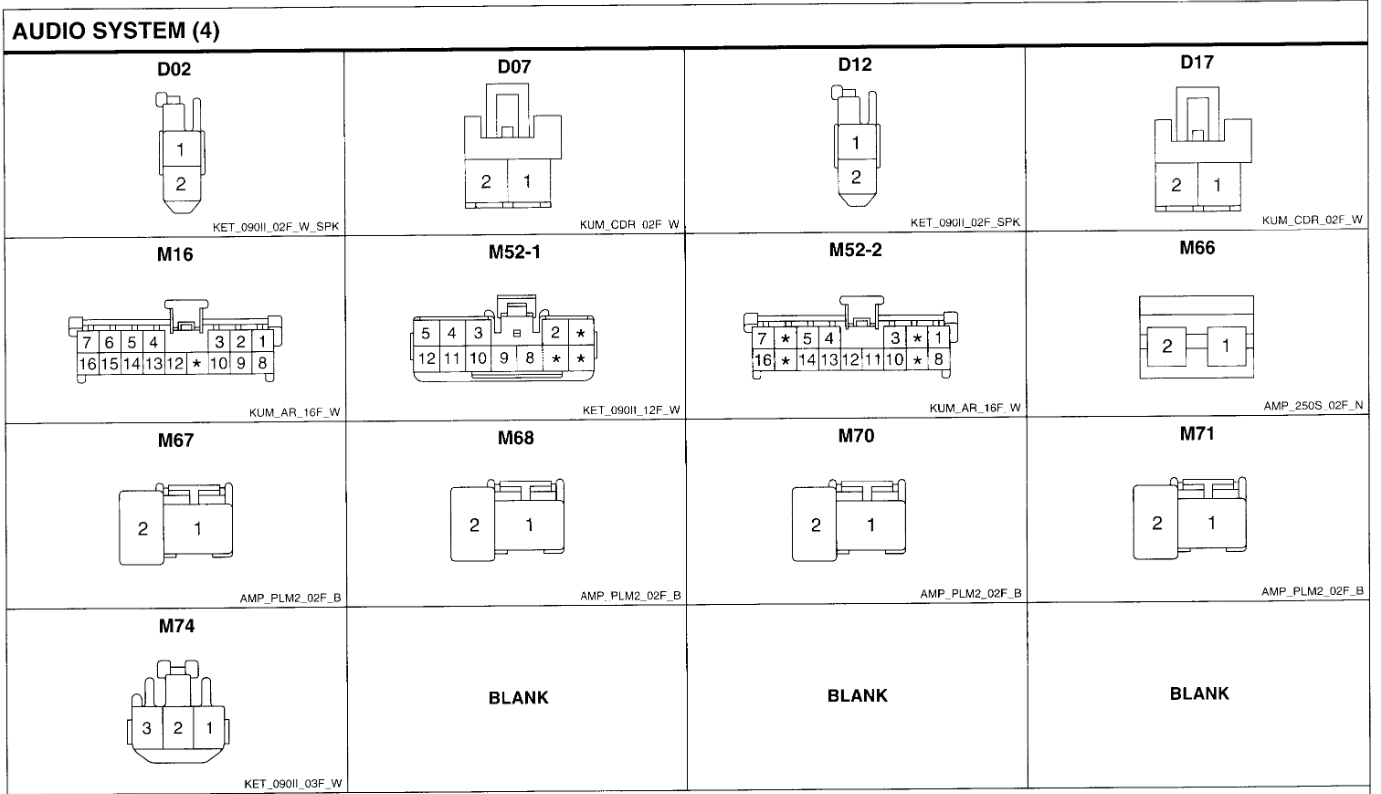

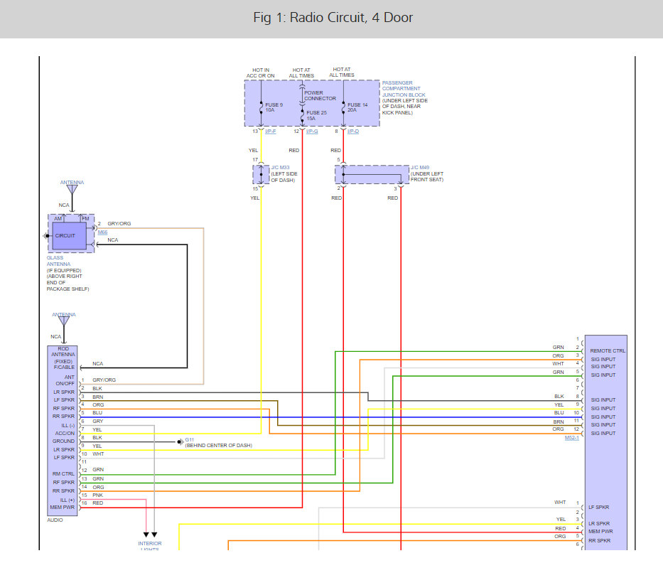

Can you please explain "How does that pave a positive reading and a negative one when cars off?" Also here are other wiring diagrams that might work better, also is this a euro car? This wiring diagram has 16 pins. Check out the images (below). Please let us know what happens.
Jun 20, 2023 at 8:26 AM
GAILEY2006
  • 8 POSTS
Yea, it helped a ton. Thank you!
I got that part figured out, but I now have another problem related to the issue. The yellow ACC wire caught fire. I’m trying to trace it to replace it but I’m trying to figure out where the other end of the wire is. If you look in the last image. There’s a photo 52 where the Acc leads. Is that the fuse within the interior fuse box or is what I’m looking for located behind the dash boards requiring removal?
