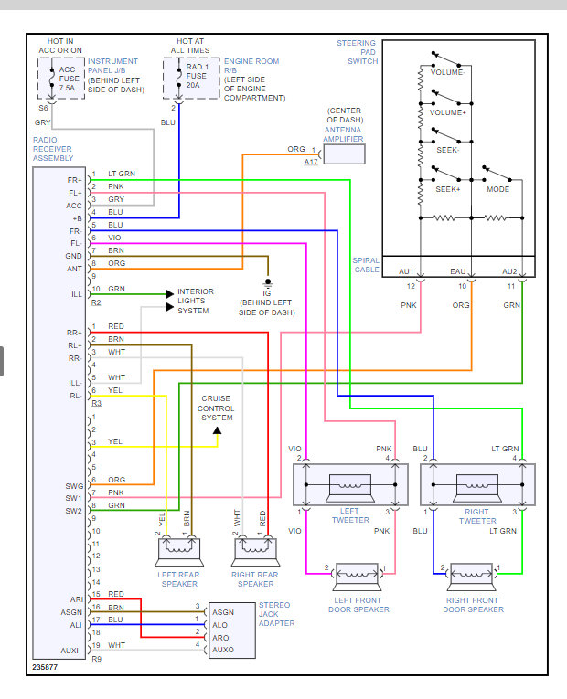

Im not a mechanic by any means, so any help will be accepted and I'll be grateful.. I bought my 2005 scion TC (used) with an after market radio installed and with no sound. The radio is fully functional... Behind the radio when i pulled it out i found one harness/bracket of wires connected and a bunch of loose wires. I figured maybe this was ok and decided that the speakers were blown or no longer in the car, so I ordered speakers and amp and me and a friend installed them (mainly him). the amp has power and it is all ran/connected/wired correctly to my knowledge, But still no sound. So if anyone could help I would be very grateful. And I've checked all fuses connected directly to amp and radio (HU) itself but not the ones in the cars fuse box??? I've read and asked around and most answers are i need to fix the radio harness/bracket or find a way to connect the rest of the "Loose wires". I can figure out details of radio(HU)/amp/speakers when and if needed.

Keep in mind, even thought the radio turns on and appears to be working, there may be no output from it. Basically, there is no signal from it to the speakers. Even with a new amp and speakers, if you have no signal, it won't work.
Since this is an aftermarket stereo, I will not have any type of wiring schematic to follow. Therefore, I need you to remove the stereo and take it to an audio shop and have them check if there is any output from the radio. That is the only way we will know if it works.

I understand. I feel that there is just no output from the radio. Here are the wiring schematic for it in the diagrams below and a guide to help test it.

No i don't, unfortunately. I have reason to believe that the cause is the fact that there is only one wire harness connected to the back of the HU when i believe there should be 2, considering all of the loose wires (where harness #2 should be) the old owner of the car must have messed up the wiring before i purchased the vehicle and now im stuck with a mess.

Most likely you're right. Usually there is one plug for the power supply and another for the speakers. However, if you wired an amp to it, then you had to wire to the speakers and there had to be an output from the radio.
Tell me the exact brand and model of the radio. I have a great friend that owns a stereo shop. Maybe he can guide me. I can't guarantee anything, but it won't hurt to stop and see him. Let me know.

Just installed new HU sony (cdx-gt66upw), HAVE SOUND NOW! But have new problems... Amp doesnt go off with car, and subs aren't pushing sound, only car speakers???? and amp remote doesnt have power?

It sounds like you supplied power to the amp from a constant hot fuse. Just switch the power supply to a keyed fuse. That way it will shut off with the key.
As far as the subs, are you certain they are wired properly? Does the amp make a difference through the car speakers?
