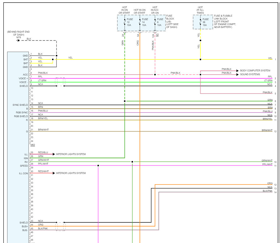

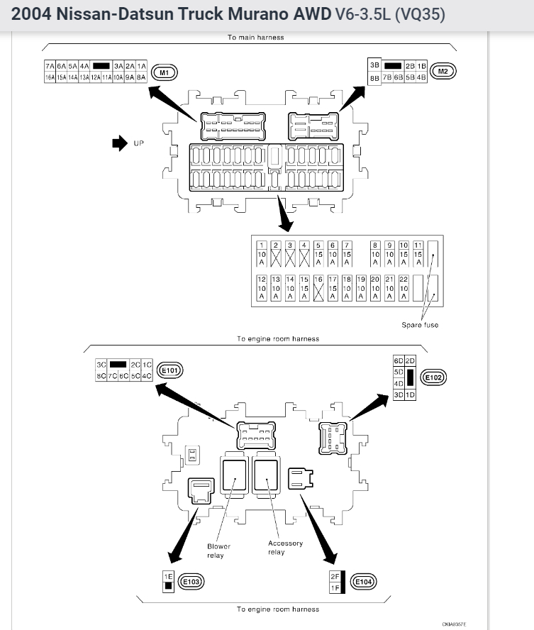

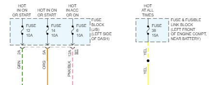

As I said in my last post, I just bought the vehicle listed above. It has a stock radio, and a GPS display screen. When I bought it, neither was working. I figured it's no big deal, it's probably just a fuse, however I cannot find any fuse or fuse location for them. Anyone know what I need to do to get them to turn on?
Oct 14, 2023 at 1:07 PM
  • 55,721 POSTS

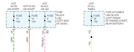

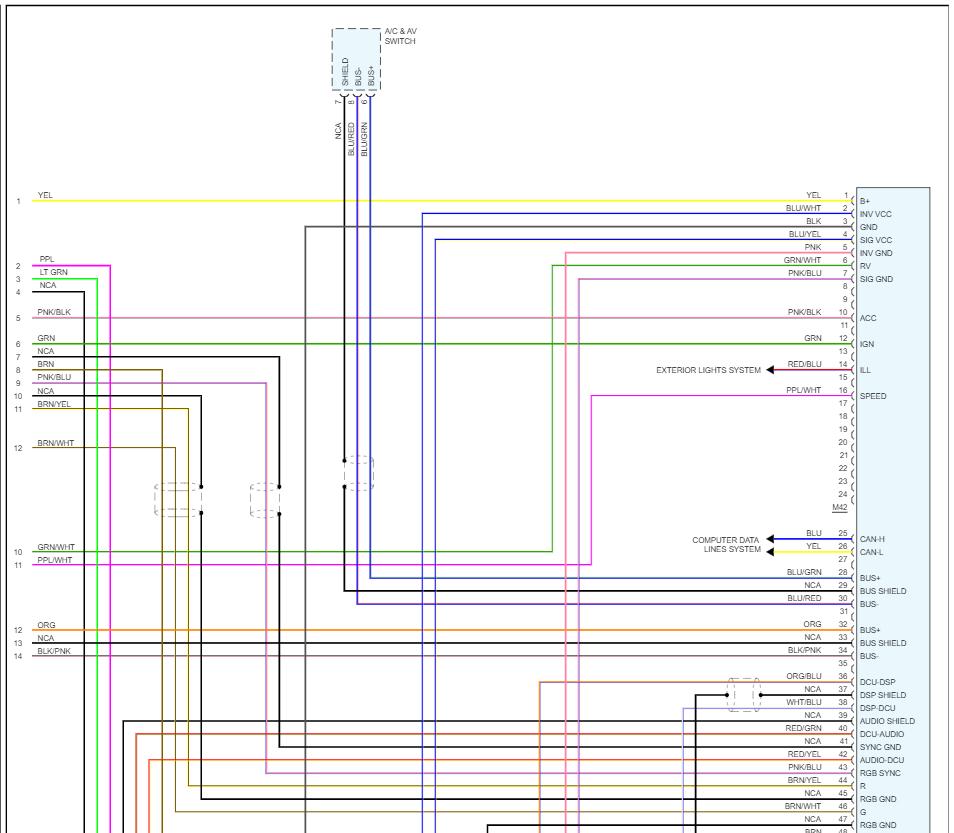

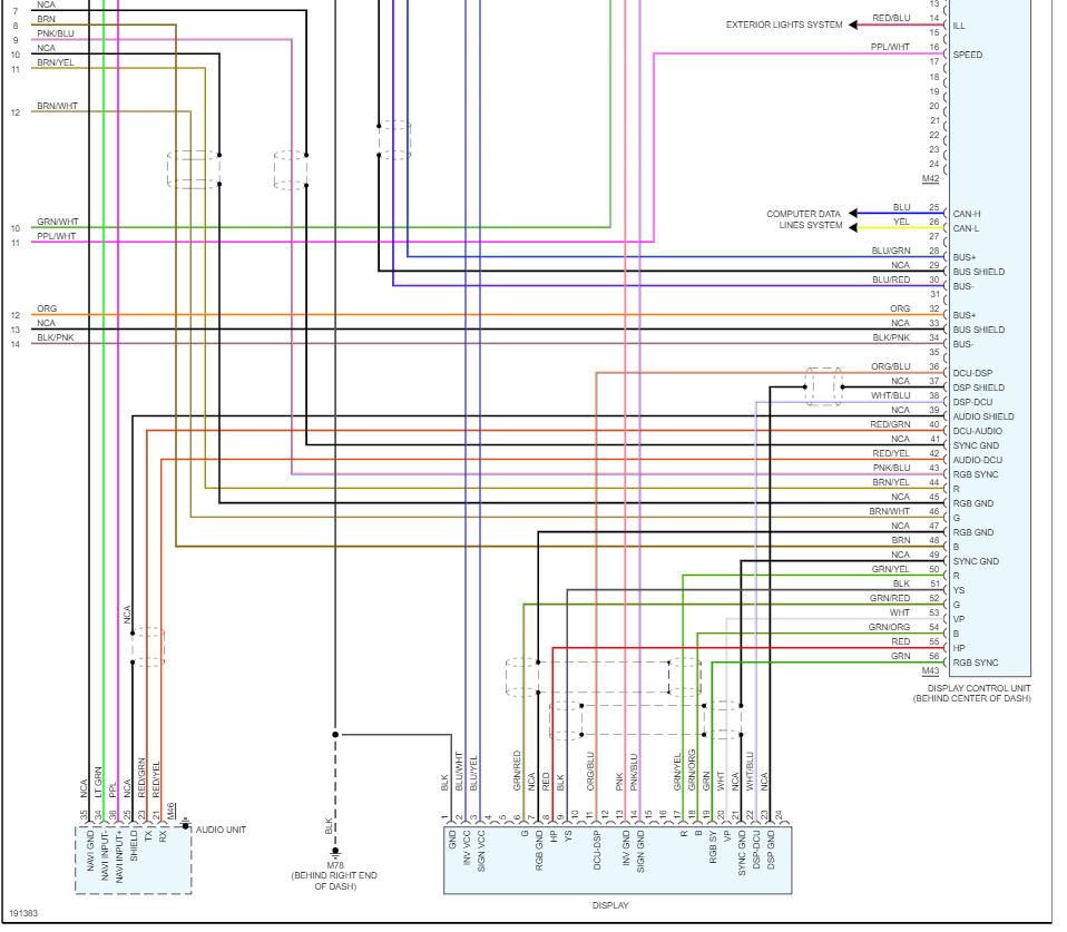

Sure, here is the fuse location and identifications for the radio and GPS display, FYI the unified meter is wired into the system as well. This guide can help us check the fuses, please check the fuses with the key/system on:

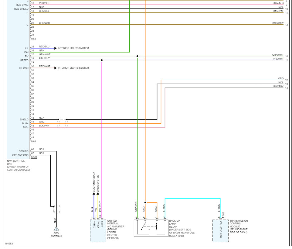

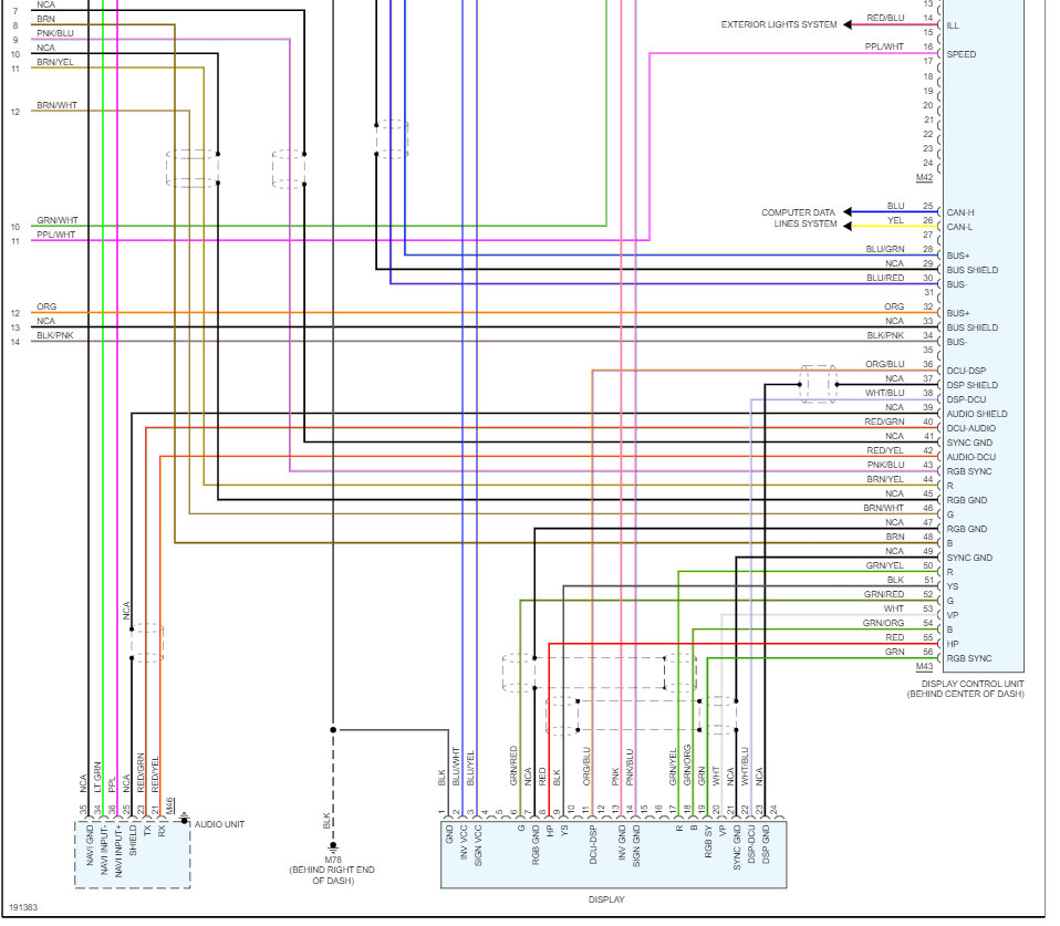

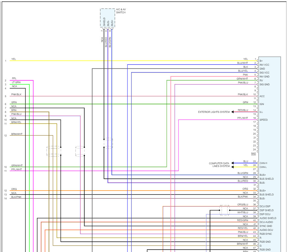

Here are the complete wiring diagrams as well so you can see how the systems work. Check out the images (below). Please let us know how it goes.
