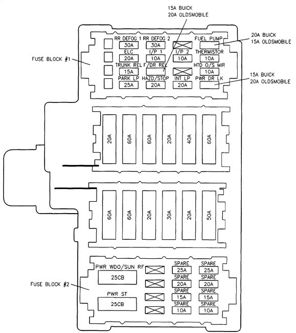

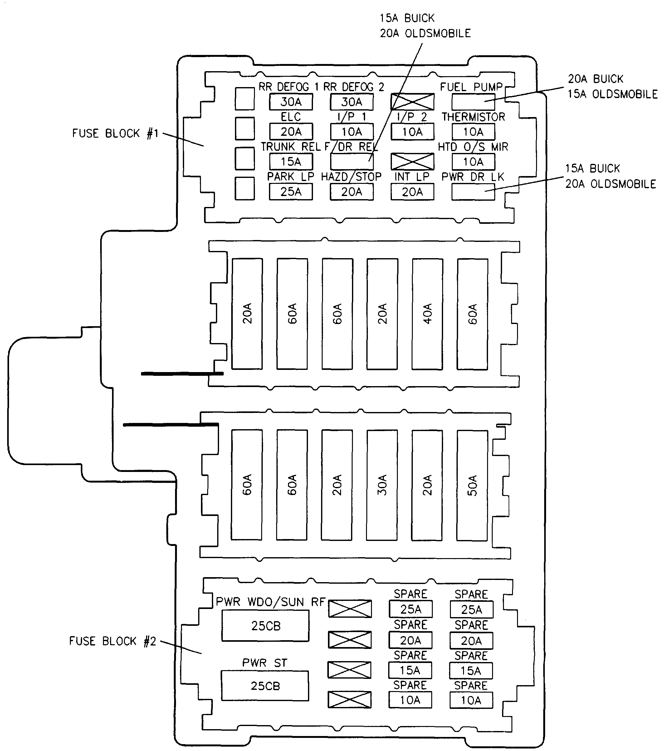

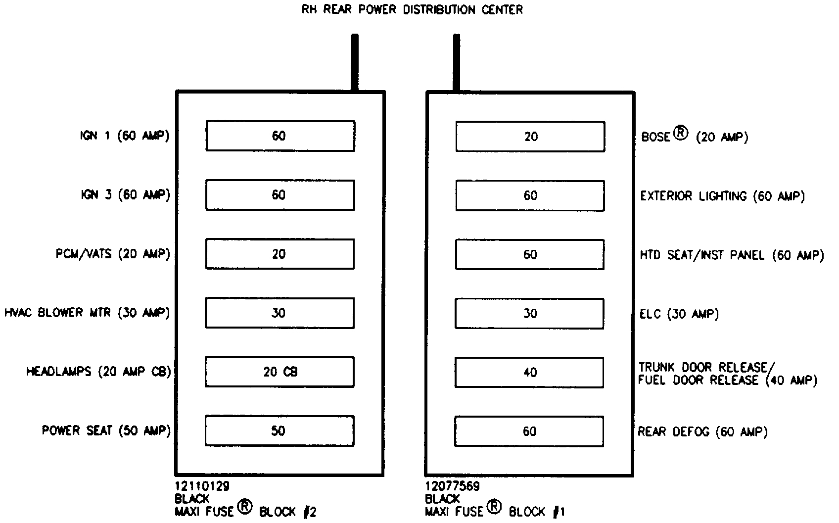

Hello and welcome to 2CarPros. While there's no specific information that sheds light on what's going on here, I'd mention that there are more than one fuse to check in this case. I'm including diagrams of the two interior fuse boxes (one is in the instrument panel/dash) and the other is under the back seat, on the passenger side (just pull up from under the seat, along the front edge and it will pop right out).
Looking at the first image below, check the fuses for IGN 1, IGN 3, and HTD SEAT/INST PANEL. I don't *think* that these ones will be the issue, but it only takes a second to check them. Looking at the second image, check fuses I/P 1 and I/P 2. Looking at the third image, check RADIO, IGN 1, IGN 3, AUX PWR, and C/LTR (sometimes GM puts other things on this circuit along with the lighter).

I checked the fuses and all of them seem to be fine. Another thing I noticed today was the steering wheel controls for the fan and temperature aren't working. Of course I can't tell if the radio controls are working or not being that I can't get the radio on. So now its the steering wheel controls, radio, and date on the driver information center that aren't working. I really appreciate you helping me try to fix this issue. It's my sons first car that's he's only had for a week now and understandably is kind of upset over this. I've had many cars before with issues and was always able to find some type of information on the internet but not this time. Thank you so much for your help!

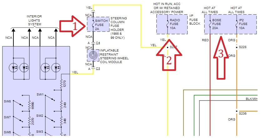

Maybe this could help?
This is a partial choppage from the radio wire diagram from "Prodemand"
Here's all the fuses it shows along with locations.
Seems there is a loner fuse segregated all by itself.
I'm guessing that its in an old style tubular holder or maybe a rubber square version with a rubber cap (probably with a tether to prevent loss)
Check out my "1" arrow in the diagram below.

OMG it is fixed. I went and got a tester and it landed up being a fuse. It was one of the i/p ones. You were right, it looked like there was nothing wrong with it. Thank you so much to both of you.
