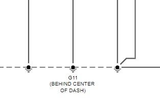

Hello, I have the vehicle listed above GT model that has just now reached 100,000 miles. A couple months ago my car started doing this odd thing where the radio would cut out and then turn back on in about a second. This progressively got worse to where the radio would cut out, and so would the air, and then all the gauges (gas, rpm, speed, temperature) would all drop for about a second and then immediately go right back to where they were. It would mainly do this while in park, and rarely does it while I’m driving, however whenever it does it while I’m driving the car still drives fine. It stopped for a couple weeks but has now come back, and gets worse. Every time I’m parked for a while then the radio and air will cut out, if I have my headlights on they will flicker/cut out, and then the gauges will drop then rise then drop again and then everything will be fine for a second and it’ll start its cycle again. I took it to the local car parts store and they hooked it up to the machine where it would show any codes wrong with it and nothing popped up. Has anyone experienced this or know what this might be? Please help!

It sounds like there may be a weak ground. I checked schematics and found that ground 11 seems to be tied together with the radio, instrument gauges, and the multi function switch for the headlights. The ground is centered behind the dash. All wires going to it will be black. I would start by checking to make sure there are no damaged, loose, or corroded wires at that point.
Here are a couple links you may find helpful:
I attached a portion of the schematic for you to see. Let me know if this helps of if you have questions.

That fixed it, thank you so much!
