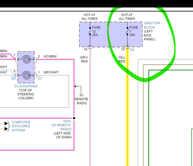

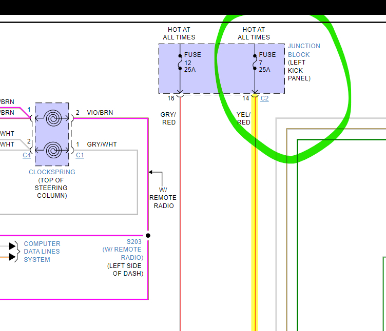

My radio sound will not stay up. When I turn it up, it goes back down and says low. I went and got a new radio installed and the mechanic said I might have to get a new amplifier? I don't know for sure if that is correct but I’m holding there’s an easier way to solve this and maybe I could fix it myself?? Is it a fuse or the amp itself or what?? It’s the factory amp by the way.
Jan 24, 2022 at 2:37 AM
AL514
  • 5,696 POSTS

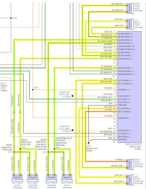

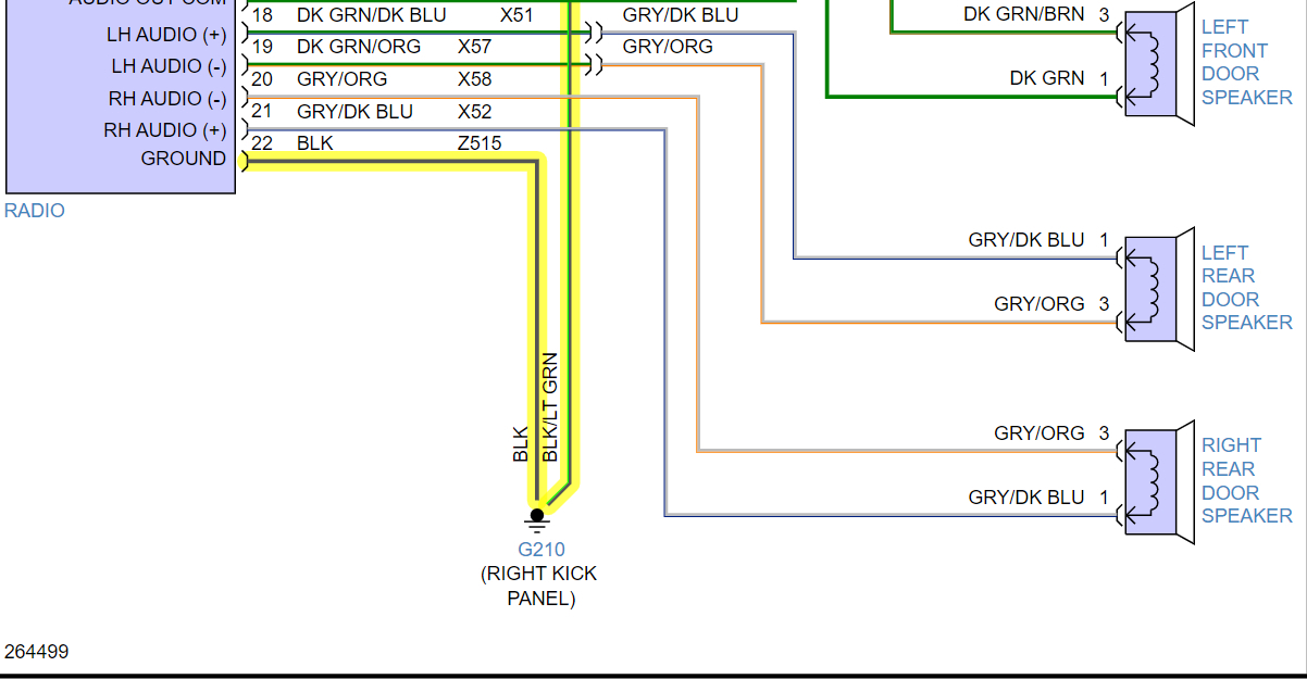

Hello, does this car have the Remote-Control radio system? Unfortunately, your mechanic may be correct, the speakers all come directly out of the amp. Unless some other input is turning the volume down on you. Do you have radio controls on the steering wheel? In the diagrams below, the first one is the Amp Fuse, and the second one is the speaker wiring coming from the Amp. I will post any additional information as I come by it.

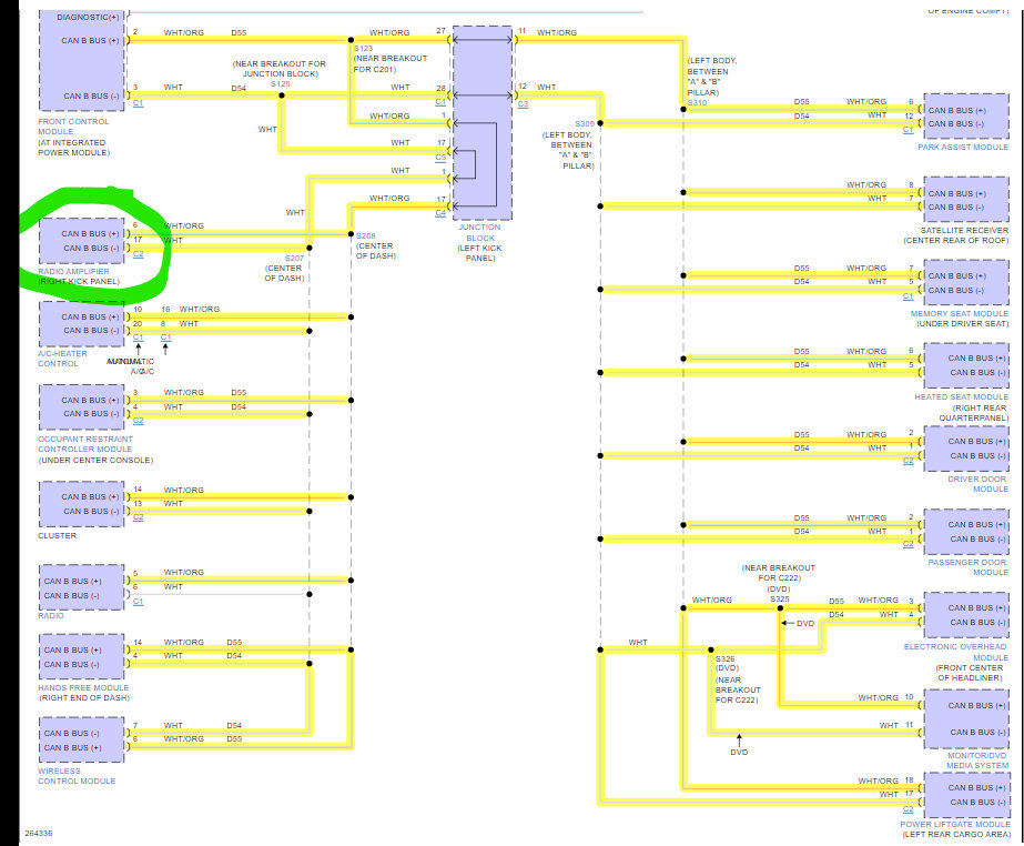

Does this have a DVD system as well? If you can turn off any voice control or remote systems that may help. This system is pretty complex. The radio and amp are on the CAN bus network. That means they could be receiving signals from any module on that network.

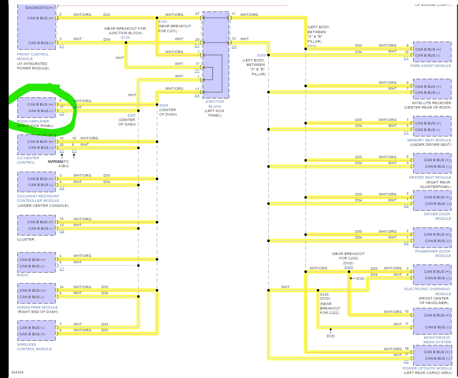

The third diagram is the network it's on. I would think that if it was an Amp failure, it wouldn't just turn down the sound on you, I would think you wouldn't have any sound at all.

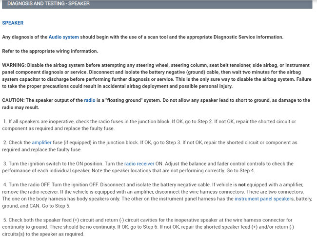

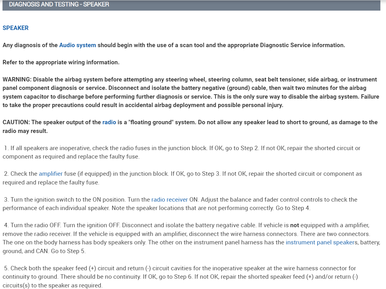

The only tests there are for a "No Response" condition from the Amp. Which is only checking the 2 power feeds to the Amp.

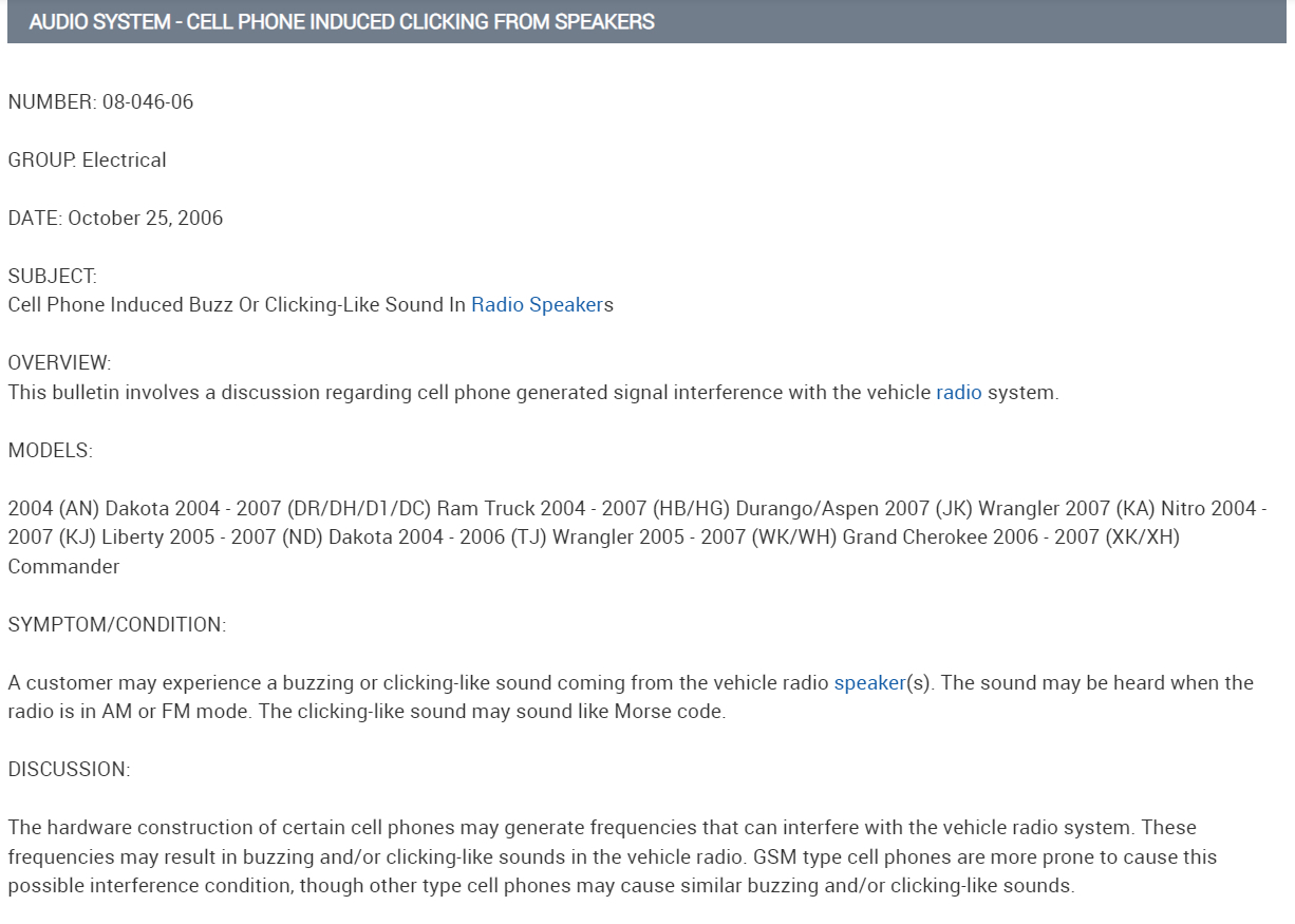

The diagnostics page for the Radio/Amp system states to start by using a Scan tool to check the communications for the Radio circuit, so this is probably not just a blown fuse issue. It also states that a cell phone can interfere with the wireless system.

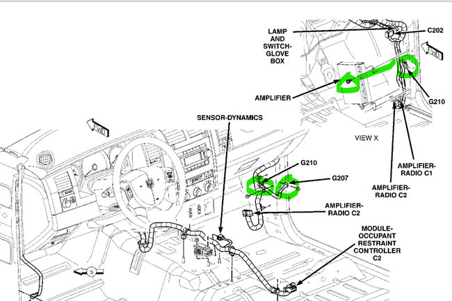

I was looking through some information last night, do you use the Bluetooth option to talk on your phone while you're driving? Where you would hear the person, you are talking to through the speaker system on the vehicle. Or possibly the GPS system threw the Bluetooth and receive directions through the radio speakers? There are a couple Ground locations you can check. Under the passenger side lower kick panel, this is where the Amp is located also. It's worth checking that there's no loose Grounds or connections at the Amp itself.
