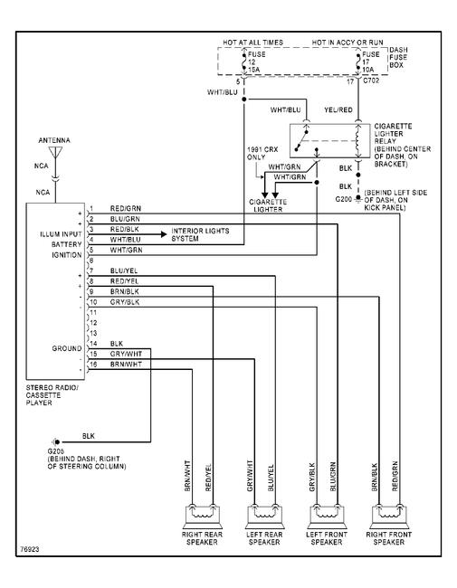

Would it be possible that u have the schematic for the radio cable for this car, cause I search but when I looked in the web it says a yellow cable for the ignition but there's no yellow cable. I GOT THE 1.5 HONDA CIVIC 91 LX SOHC. Thank you

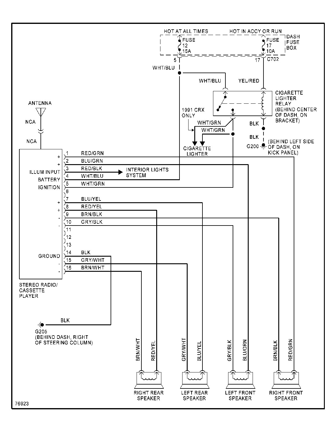

THIS IS SUPPOSED TO BE FOR YOUR EXACT VEHICLE. OUT OF "MITCHELL I"
LEMME KNOW IF THIS HELPS
