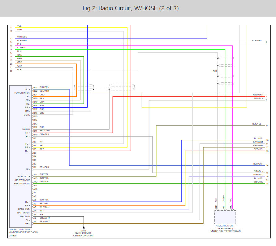

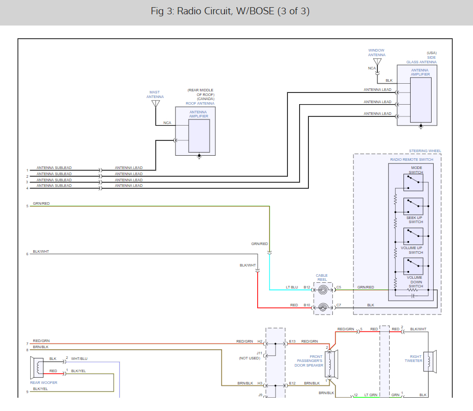

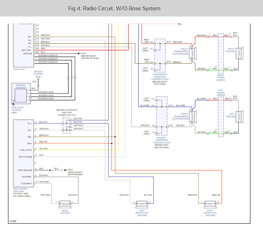

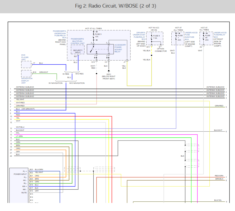

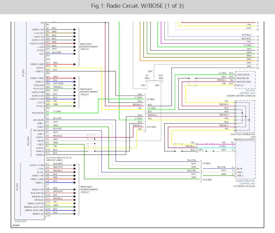

Touch screen radio installed; the guy that installed it I guess they didn't do it right and one of the wiring harnesses ended up melting. so I rewired everything back same color to same color and went to plug into factory radio and it wouldn't work but it worked when it came out. I checked all the fuses are good.
Sep 27, 2020 at 10:37 AM
DANNY L
  • 5,648 POSTS
Hello, I'm Danny.

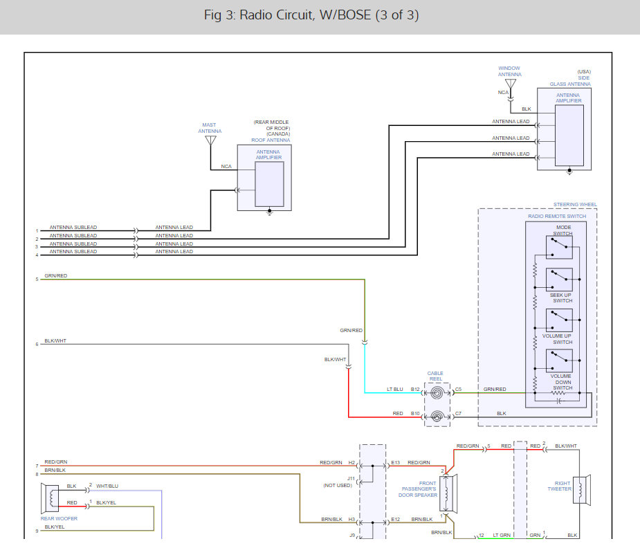

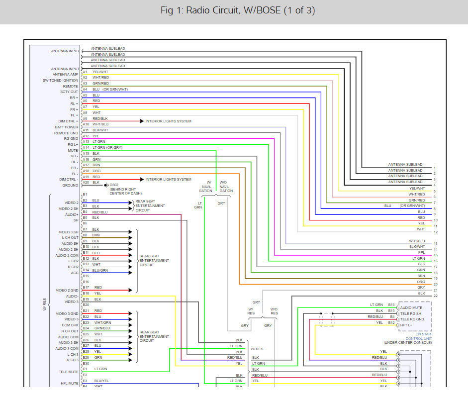

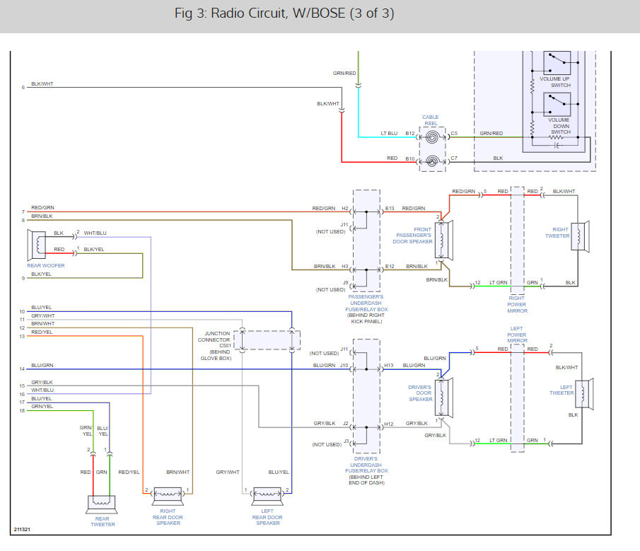

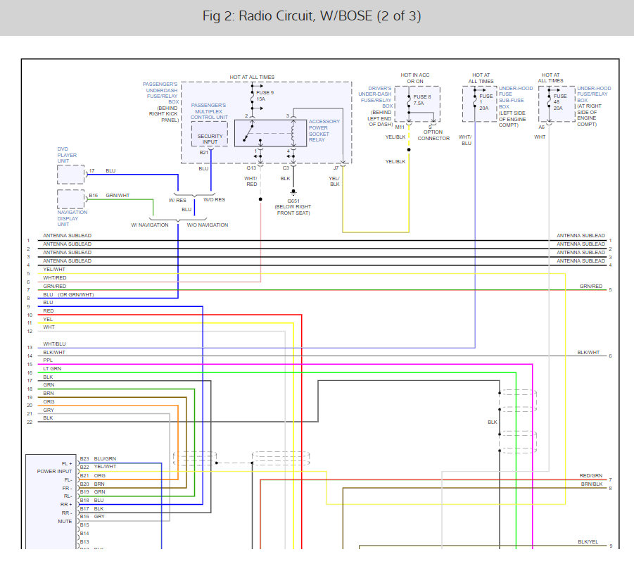

Just a quick question first. What is the brand and model touch screen radio you installed? Here is a wiring diagram to compare the wiring harnesses to make them compatible. Let us know and we'll go from there. Here are the radio wiring diagrams (below) and a guide to help test the system.

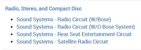

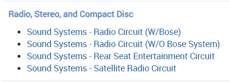

DANNY L
  • 5,648 POSTS
Hello again.
Also, I've attached a picture below of the different stereo systems that were available in your Acura. Can you let me which one you have so I can attach a wiring diagram for you. Hope this helps and thanks again for using 2CarPros.
Danny-

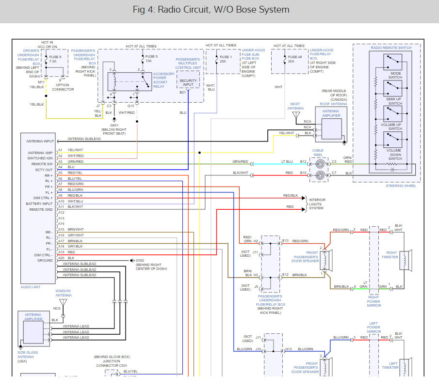

Mine has XM satellite radio.

Never mind I found the problem. I was reading a story in one of the parts y'all were helping someone else and in there y'all had some diagrams to y'all sent to this person and I started looking at them and it showed other fuses and it happened to be one for the right rear system on one of my fuse box under the hood.

Sep 28, 2020 at 4:10 AM
  • 55,399 POSTS
I have updated the post to include radio wiring (above).
