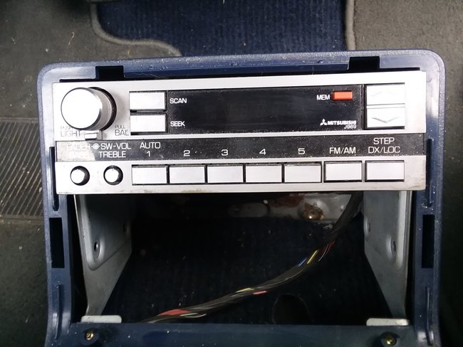

What other stock radios with CD player will fit my car?

Do you have a model number of the old radio? If that car uses Chrysler's common black and gray seven pin plugs, you can use a newer Chrysler radio up to at least the 1999 models, and up to 2003 models from full-size vans, but we also have to look at the mounting ears. One style was real common, but there are two other versions that mount differently.
If your car has a Mitsubishi radio, there was no original equipment model with a CD player. I might be able to suggest something if you tell me the dimensions of the opening in the dash.

Model J969 Mitsubishi opening 1x7/8"×6×1/4".

Dandy photo. You're going to have to go to an aftermarket radio. Most of them are a standard size that matches your radio.
