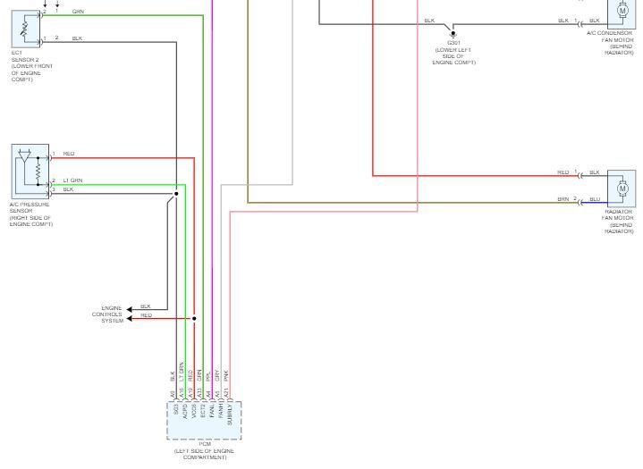

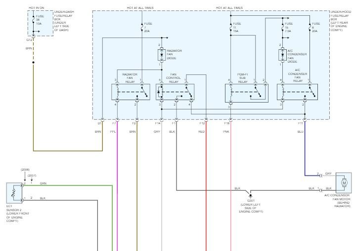

Okay, after overheating damaged radiator, heater core. I went in and replaced everything I could with the cooling system due my car's mileage (over 350,000). Replaced radiator, heater core, water pump, thermostat/gasket, two temperature sensors, but car is still overheating. The only things I did not replace are the cooling fans, because these were easy to verify that they work. They both turn on with AC on. I have tried cross connecting the temperature switch connection with paper clip and fans do not turn on. I have checked relays and fuses, they seem okay. Not sure that I checked the correct ones though. All the diagrams I have found are for the normal Honda Civic and not the Hybrid. What are the specific fuses and rRelays associated with the heating system in my Honda Civic Hybrid? Thanks, Ray

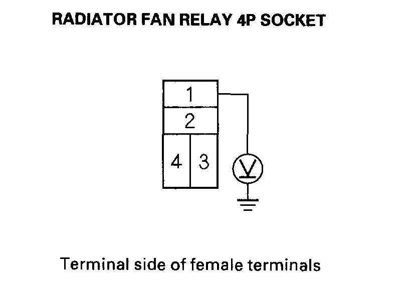

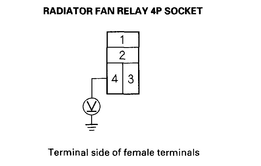

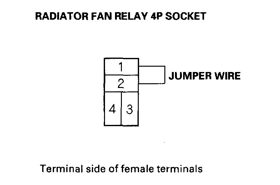

I have attached five pictures below. Pictures 1 and 2 show the wiring schematic for the hybrid. The remaining pictures correlate with the following testing and inspecting directions.

3. Measure the voltage between radiator fan relay 4P socket terminal No. 1 and body ground.
Is there battery voltage?
YES - Go to step 4.
NO - Repair for an open in the wire between radiator fan relay 4P socket terminal No. 1 and the under-hood fuse/relay box.
4. Connect radiator fan relay 4P socket terminals No. 1 and No. 2 with a jumper wire.
Does the radiator fan run at high speed?
YES - Go to step 5.
NO - Repair for an open in the wire between radiator fan relay 4P socket terminal No. 2 and radiator fan motor 2P connector terminal No. 2.
5. Turn the ignition switch ON (II).
6. Measure voltage between radiator fan relay 4P socket terminal No. 4 and body ground.
YES - Repair for an open in the wire between radiator fan relay 4P socket terminal No. 3 and powertrain control module (PCM) connector terminal A5.
NO - Repair for an open in the wire between radiator fan relay 4P socket terminal No. 4 and the under-dash fuse/relay box.

I hope this helps. I had to cut the schematic picture in half (hence two pictures) because of its size. It is for the hybrid model.
I hope this helps.
