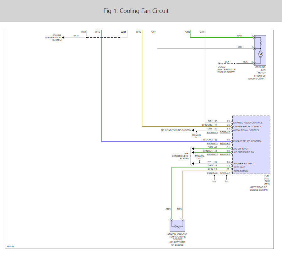

I replaced relay and water cooler sensor. I connect 12 volts direct fan work. Relay contact I put jumber fan working. AC on fan working. When I run engine overheating not run fan automatically. Because that time relay coil supply not reached why I do not know. My car eon era+ model. Radiator fan and condenser fan are same one. So I can run car AC on condition without overheat engine. But cool season, also I need on AC this make low mileage. Please help me early as possible.

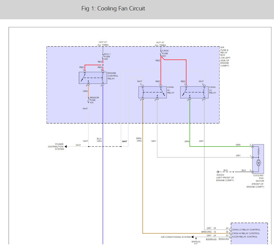

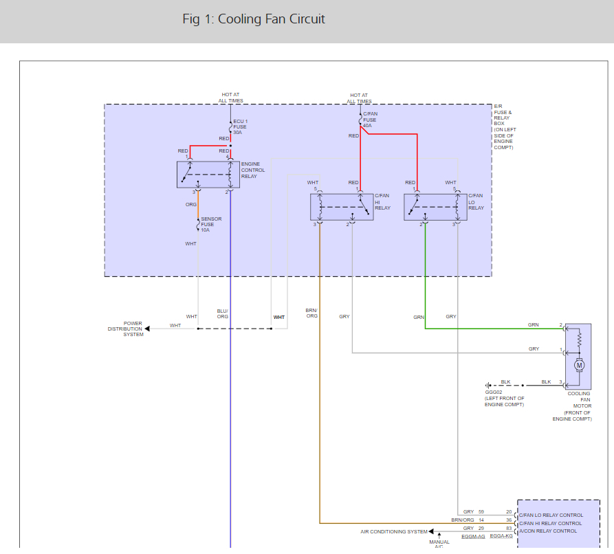

There are two relays that run the system you should test both. Here is a guide to help and the wiring diagrams to help you see how the system works. There is the fan motor, temperature sensor, relays and PCM.
and

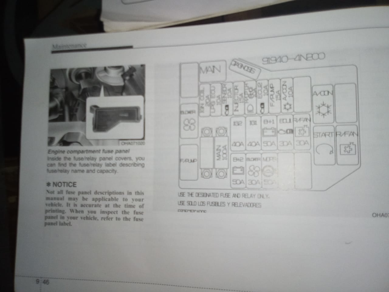

I changed already radiator fan, AC/ relay, water cooler sensor and checked fuse everything normal. Problem same like running. Now I need to change only ECU. Please give me the advice.

Radiator fan relay I changed but relay coil supply not reached when I short relays. No contact fan run normally I think one relay only control this radiator fan. Please help.

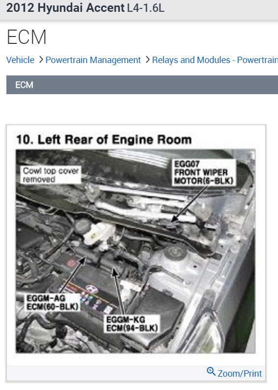

It sounds like sensor fuse 10 is out. Can you check it? Also, if you checked the wiring and everything is good I would say the PCM driver that runs the fans is out which happens. Here is the location of the PCM you will need to have it programmed at a shop which should run about $130.00 US.
