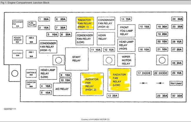

Hello LISTER89,
I am including a diagram of the under-hood fuse and relay panel and have highlighted the radiator fan relays. Are these the relays you removed?

LISTER89
  • 14 POSTS
Didn't see the top one before. I started by removing the top one, then the bottom left. When I removed the bottom right, it turned off. So, I plugged back in the top one and the bottom left only. And it stayed off. Only when I plug in the bottom right one again does it turn back on immediately. Does this mean it's a bad relay?

BRENDON S
  • 653 POSTS
Good morning, LISTER89,
It sounds that way to me but let's verify just to make sure. Take the bottom left and put it in the bottom right position and see if the fans stay off. They should be the same relay and should have the same part number stamped on it.
If the fan stays off, then it's the relay.
Let me know what happens.
