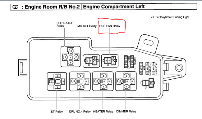

Radiator fan always on even when cold. I thought it was only supposed to turn on when gets to a certain temperature.

No, it is on even when A/C is off.

Okay, then either we have a short to power or there is an issue with a relay, or a faulty coolant temperature sensor.
Lets start by checking if there is a short to power. I need you to remove the fan relay to see if the fan turns off. If it does, then I need you to check the relay.
Here is a link that explains how to check a relay:
The relay is in the under hood fuse/relay box. I attached a pic to help you locate it.
Let me know the results.

Okay, I remove the fan relay fuse then started the car fan stayed on. Okay, put finger on relay fuse had someone else started I felt a click. And I remove the fuse started the engine and fan still ran.

Ignore that last message I was holding the wrong relay. I found the right relay felt no clicking pulled it out and fan still ran. Bought new relay put it in still the same thing happening.

If you are removing the fuse, it shouldn't run. That indicates you have a short to power. When the key is on, another circuit is powering the fan. That is what I believe is happening on your findings.
Check as much of the wiring near the fan and make sure there is nothing wrong or causing this to happen. If you find nothing, then we need to remove one fuse at a time to see when the fan stops. At that point, we will at least know the circuit that is causing the problem. I will then look through schematics to see if I can locate areas where the two systems are close.
