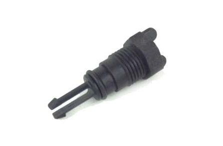

How do i change the radiator drain plug ?

If it's the factory plug design, it unscrews out of the radiator. There is an o-ring that tends to stick in the drain so it may take a small amount of force to pull it free. Then if it's the factory part it should have two retainer prongs.
