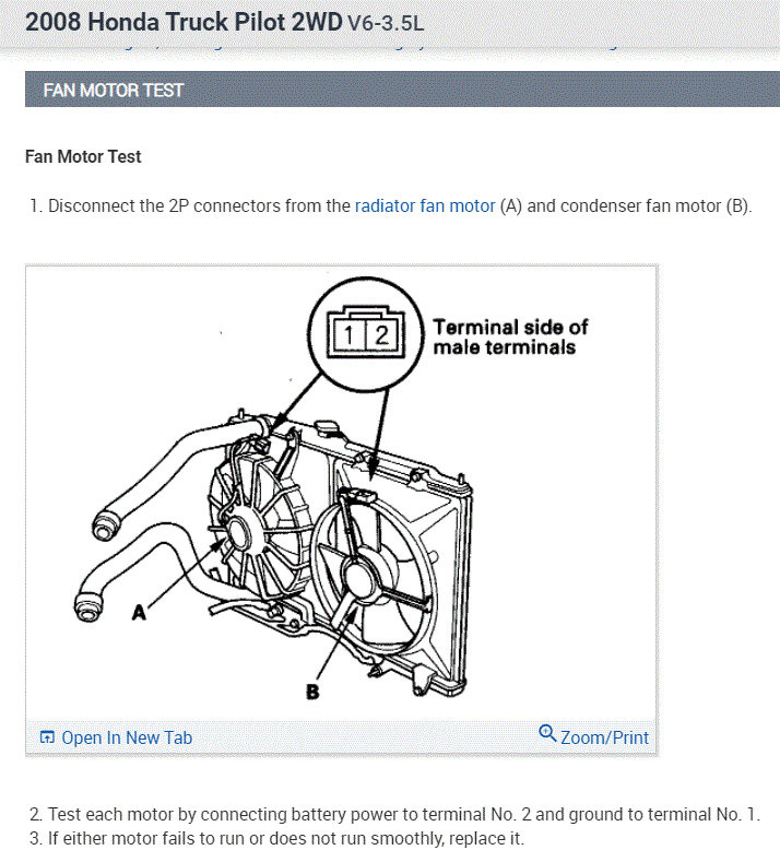

Is the radiator cooling fan motor on the vehicle listed above interchangeable with any other Honda mode?
Nov 12, 2021 at 4:20 PM
  • 110,194 POSTS
I took some time and ran through a few other Honda vehicles and the part numbers are different. The OEM part number for your vehicle is 19030PVJA01. From what I am reading, that is the only vehicle it fits, other than a 2007 Pilot. The one for 2009 is different.

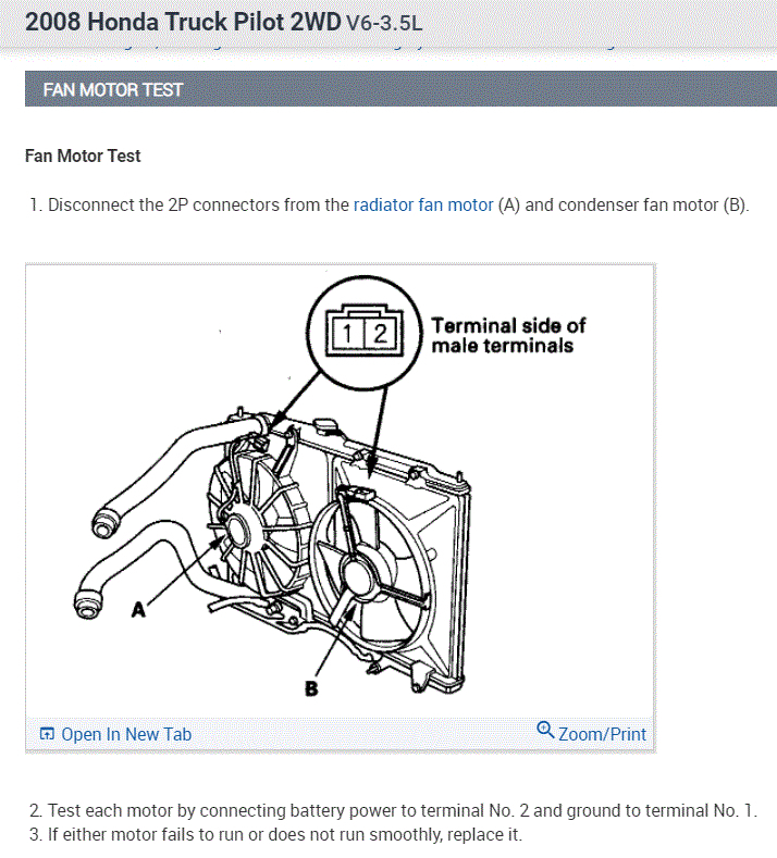

Is the fan not working? Have you checked it to confirm the motor itself is bad? I attached simple directions for testing them. You will just need jumper wires to power it. See directions below.
See pic below.
