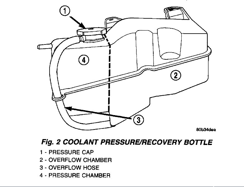

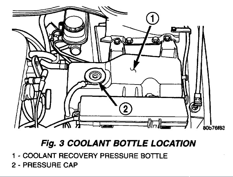

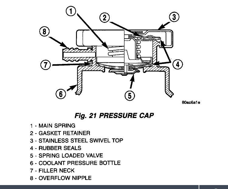

I can't find the radiator cap on my car. I have looked all over the engine compartment. I have the plastic thingy that holds the antifreeze. But where is the cap? I found the battery way down on the bottom of the engine.
Apr 9, 2019 at 9:36 PM
SCGRANTURISMO
  • 4,897 POSTS

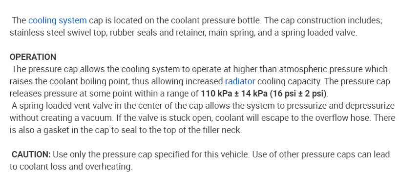

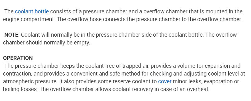

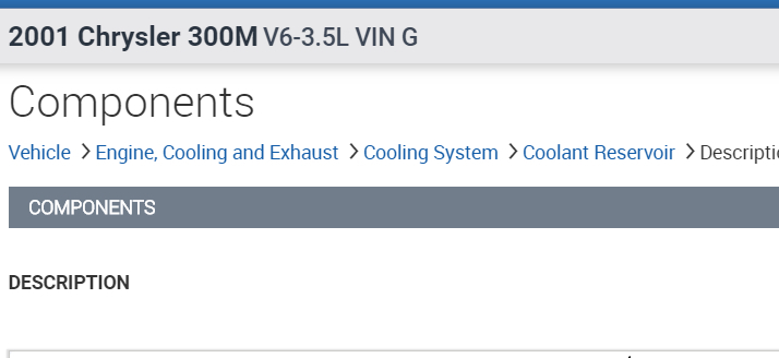

The radiator cap is located on the Coolant Recovery Pressure Bottle. I have included all of this information in the diagrams down below. Please, if have any other vehicle related questions, feel free to ask. That's what we are here for.

ROBINA3557
Oh, I know where it is now. thank you so much.
