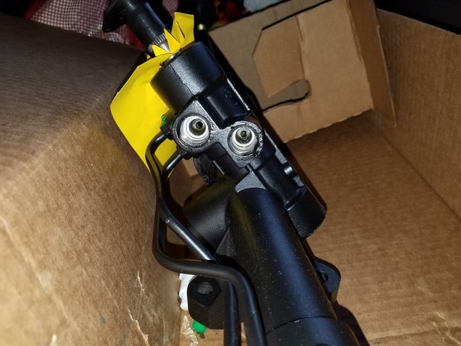

We are having some serious problems with the replacement of the rack and pinion. We have replaced the rack and pinion three times and still not having any luck.
The first one, the holes were too big for the bolts and did not line up properly
The second one, when we tried to bleed it, the seal blew and we had leaking.
The Third one is doing the same as the second and when my dad has tried to start it over to prime, the steering wheel shakes badly from side to side.
Do you know what we need to do?
Has there been a modification in the way the rack and pinion is manufactured in the last ten years?
What can be done about the holes being too big? I wish there were a way my dad could call you.

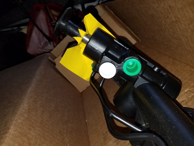

One more thing that should not be overlooked is rebuilt racks come with plugs in the ports to keep dirt out. Those are usually orange, red, or blue plastic cups that are pushed in, but they can also be threaded plastic plugs. I have seen twice where people forgot to remove one of those cups. Some of them do not have the flat strip in the middle for grabbing it. Some have to be picked at with a pick or small screwdriver, then they can be pulled out with a needle nose pliers. It is possible to thread in the soft metal nut on the steel line with those cups still in there. It may sound stupid, but be sure those cups have been removed.

Yes, those seem to be the holes that we are referring to. The cups have been removed and no, it does not sound stupid to ask.

Hello again! Sorry to have been so tardy returning this...a lot has been going on...
If i remember correctly, the original rack & pinion was shaking & leaking.
I do believe my father tested the hose. I will verify that.
He has purchased another rack & pinion, we have already noticed that the holes on this one are different sizes! (Great news, the others were the same) Now, we need to make sure that we don't mix this one up since this part really seems to be correct. Is there any way that you could verify which hole is the high pressure?

Yup. I looked this up last time. The two ports are different sizes. 16 mm and 18 mm, as I recall.
