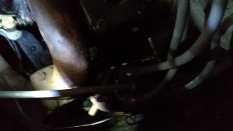

Hi, I have a 1938 American Bantam, it's
The precursor to the military Jeep.
The issue that I'm having is the
solenoid and starter clicks, won't
turn over.
I have a new battery, new plugs, rebuilt starter, new solenoid, new battery cables.
I have had the engine turn over, but not running.
It's very sporadic, I cannot figure out
What the problem is.
Would you have any ideas or do you
Know who has any knowledge in regards to my problem.
Thank you Kenny.

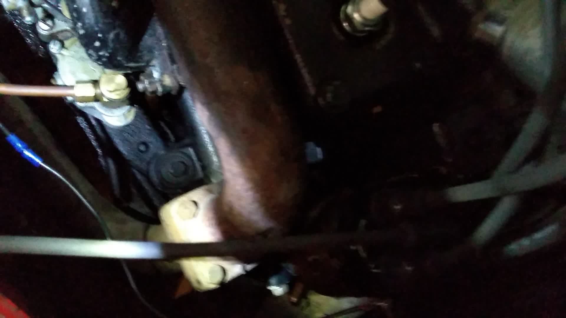

I have another issues that is making me scratch my head. This American Bantam has a one barrel carburetor. The car still won't start, I figured if I use the choke the car will start. The car engine will turn rapidly, but When I use the choke for just a second
the carburetor will leak. The larger issue is the Engine basically locks up and will no longer turn over once the choke is used.
Does this make any sense to you? Any ideas? Can you help me?
Thank you, Kenny
Apr 21, 2020 at 2:25 AM
Yes, it sounds like it is flooding from too much fuel.
Fuel is getting into the cylinders and locking the engine up.Remove the plugs and crank the engine around to get rid of the fuel. Then add a cap of oil into each cylinder to get some compression back.
You will need to rebuild or replace the carburetor.

Hi, I got the car running, finally, miracles do happen.
I'm attaching a short video, hopefully you can view it.
