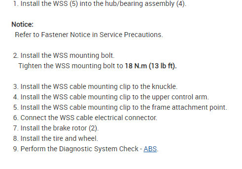

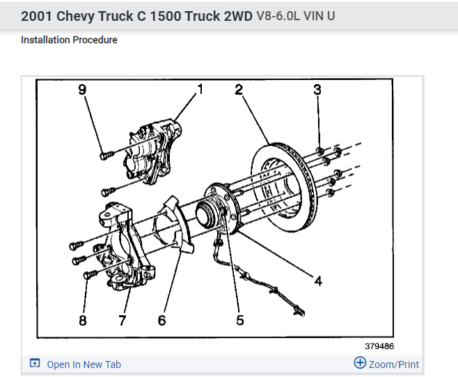

There aren't any shimming procedures for the wheel speed sensors. Once everything has been properly cleaned, it should be at the needed depth when installed and not require any other adjustment.
I attached the installation directions below. Take a look and let me know if that helps. Also, if you found the end of the new sensor is damaged, then it sounds like the toner ring is the likely issue. Let me know.
