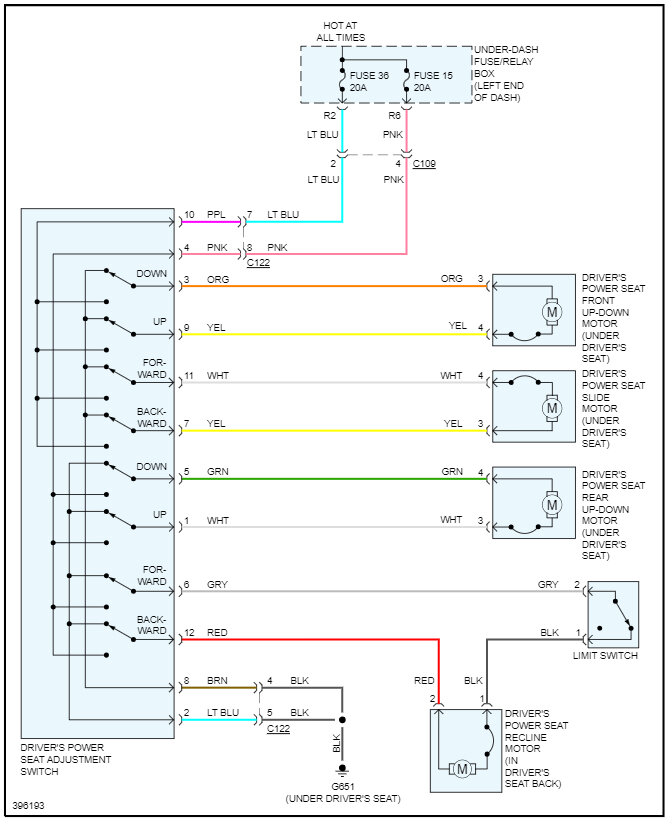

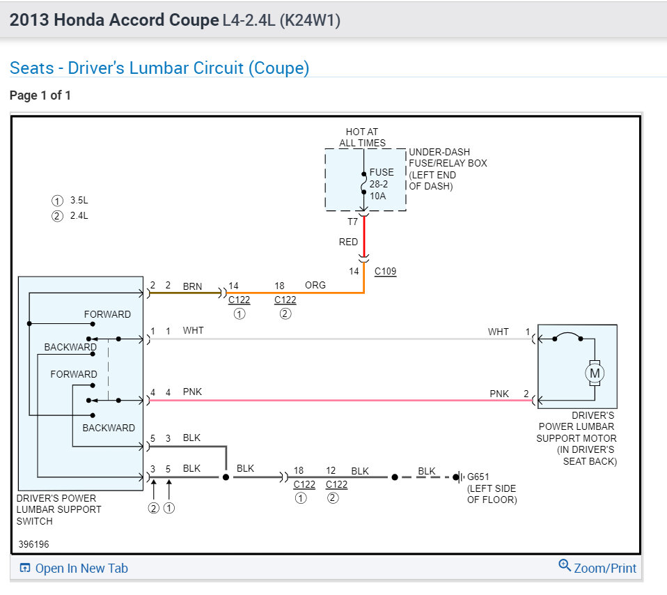

It sounds like the new seat has the lumber and heated seat option and your car doesn't. You might be able to just wire up the basic seat motors though, here is the wiring diagrams so you can see what wires do to where, the colors should match up. Check out the images (below). Please let us know what happens.

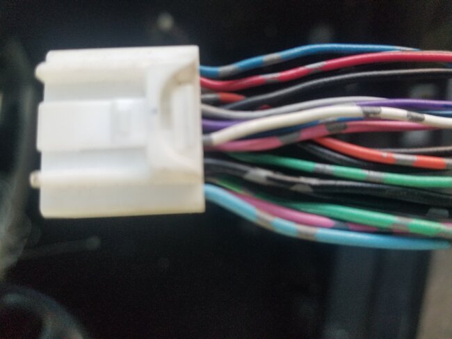

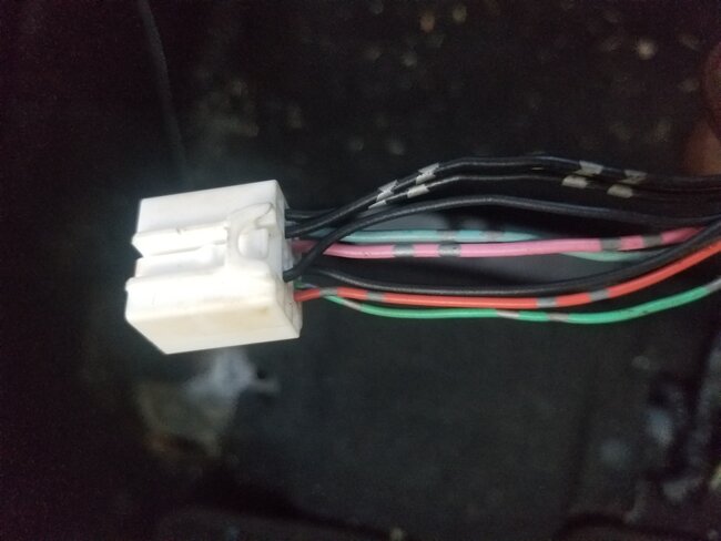

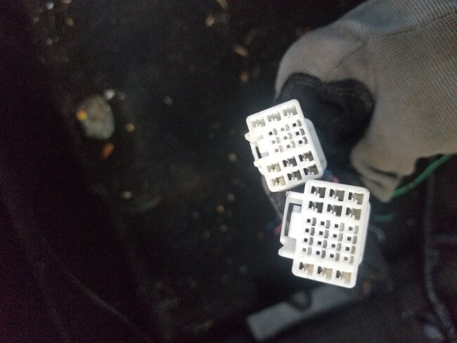

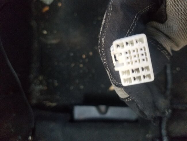

Here is a pic of the wires. First 2 pics are the old ones.
Sep 9, 2023 at 8:54 AM
  • 55,224 POSTS

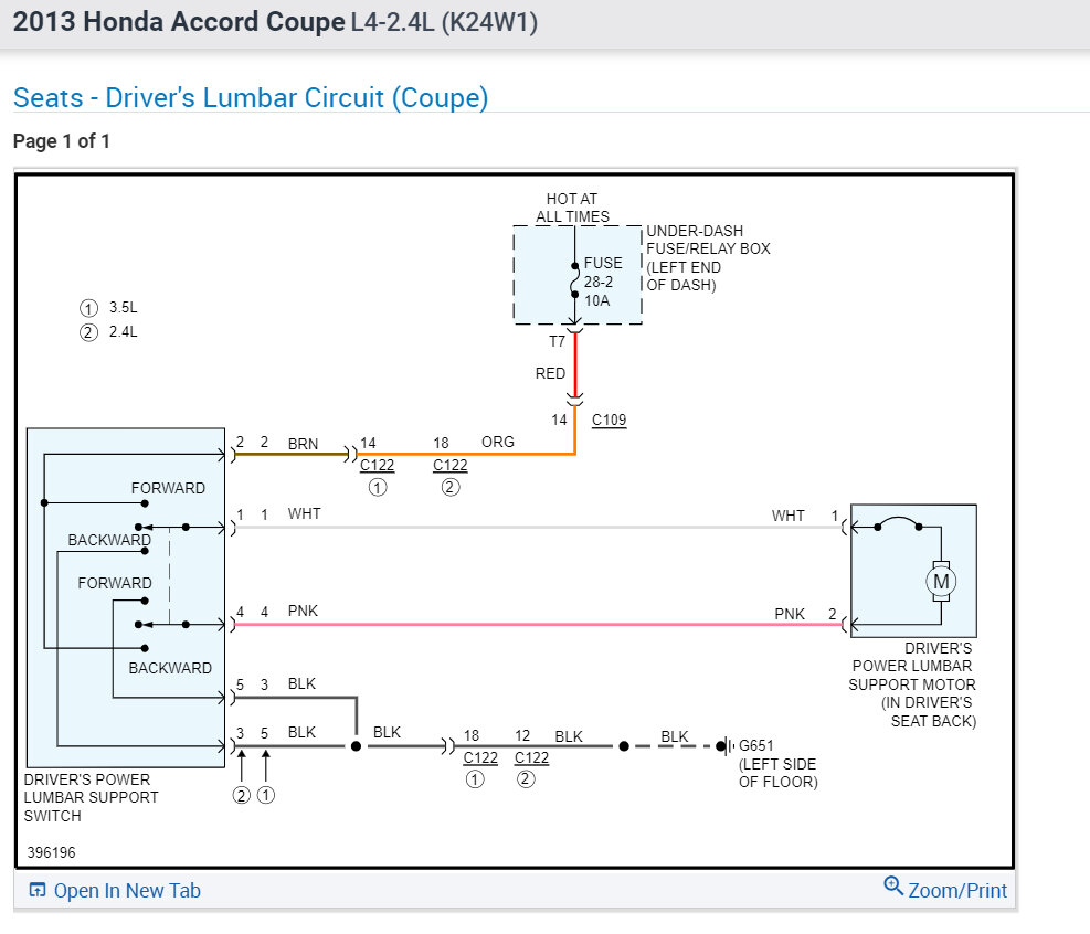

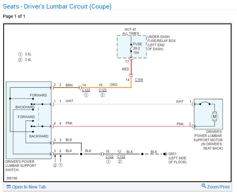

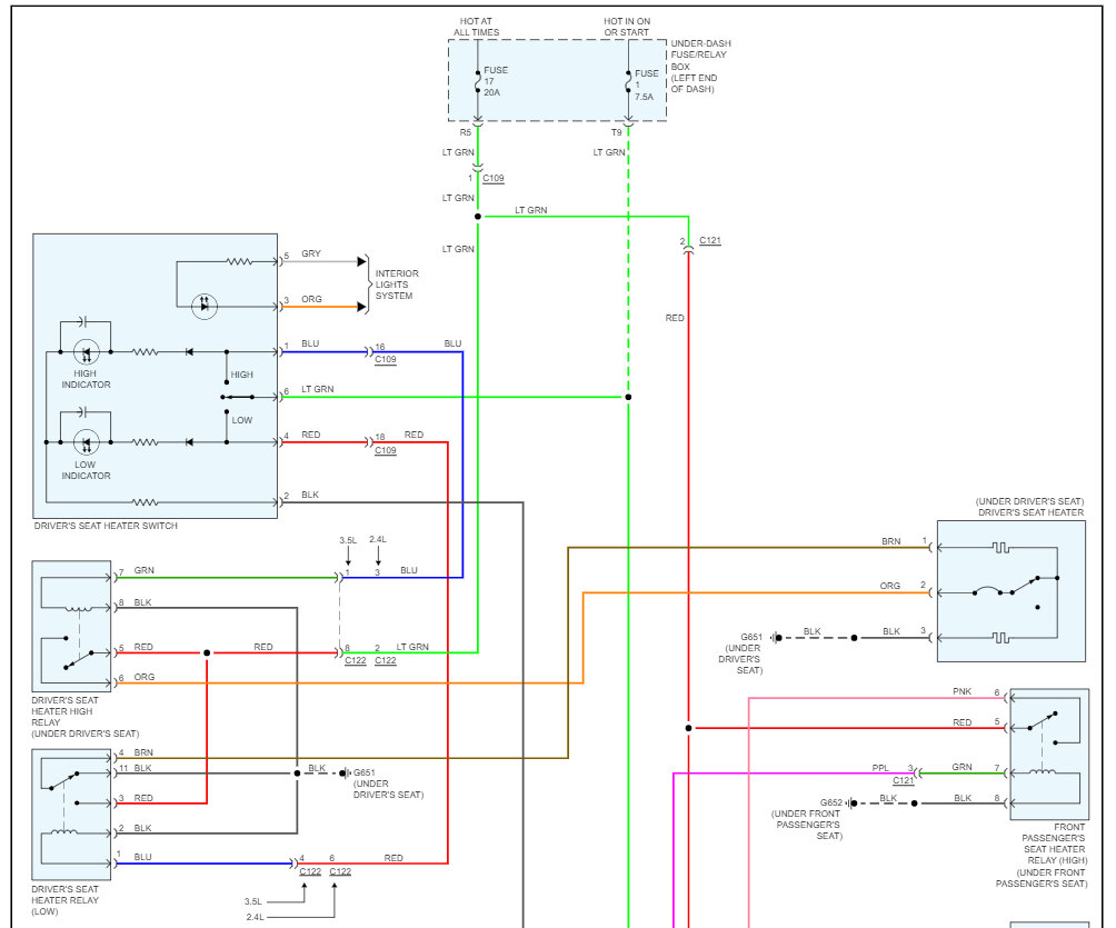

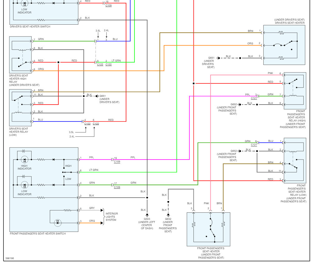

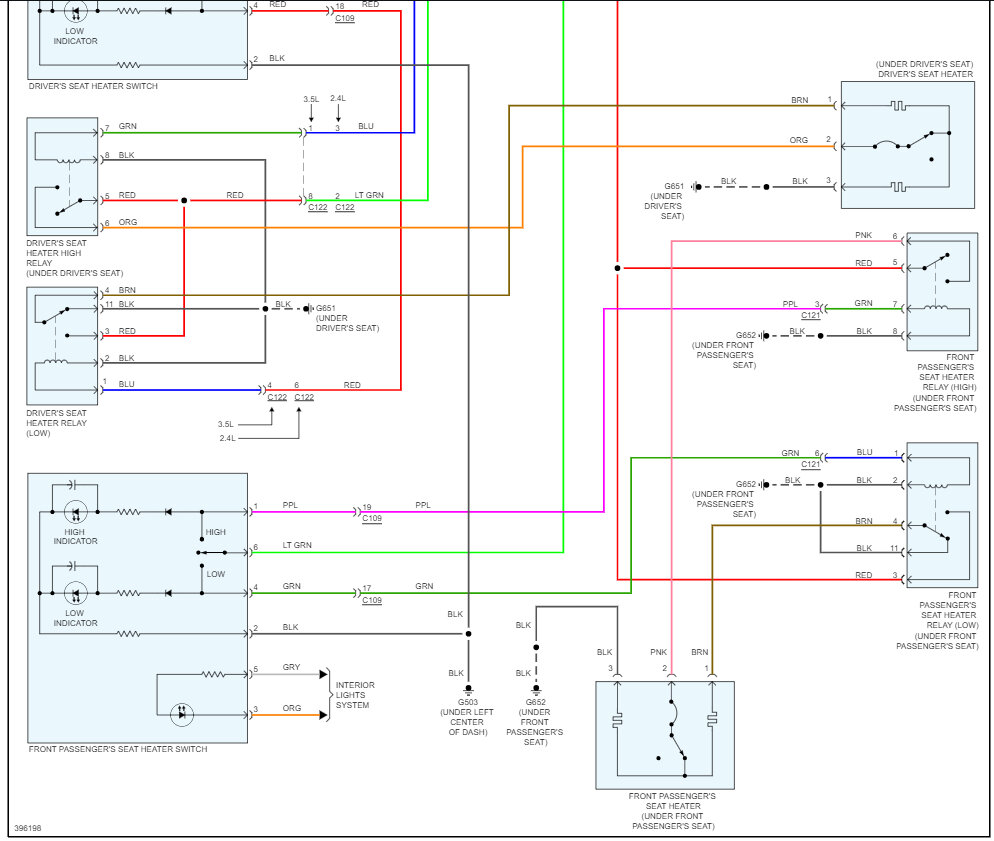

Yep, that is a big difference. The smaller plug looks the same which is good, do the colors match for the smaller plugs? If so, can you just plug in the smaller plug? Also, for the larger plug here are the wiring diagrams in case you want to rig something up to make the control work, or at least some of them. It seems like the larger plug is for the lumbar and heated seat options. Check out the images (below). Please let us know how it goes.

The smaller plug is the driver factory plug which is an exact match for the new passenger seat. I'm only interested in seat movement, nothing more. The diagrams have brown wire and neither of mine do. Pic 1 and 3 are the 2 I want to combine.

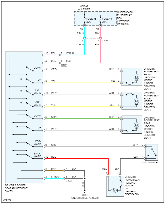

Also, this is for the sedan not the coupe. Do you have the EX sedan front driver seat diagram?

I believe this is the wiring diagram you are looking for.
