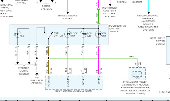

We are trying to obtain a key. The locksmith cannot proceed due to a stuck open push button start switch. We don't know if there is a problem with the push button switch, the key sloth, or something else. Can you assist me with information as to system operation please? Thanks!
Jul 19, 2023 at 2:53 AM
  • 55,395 POSTS

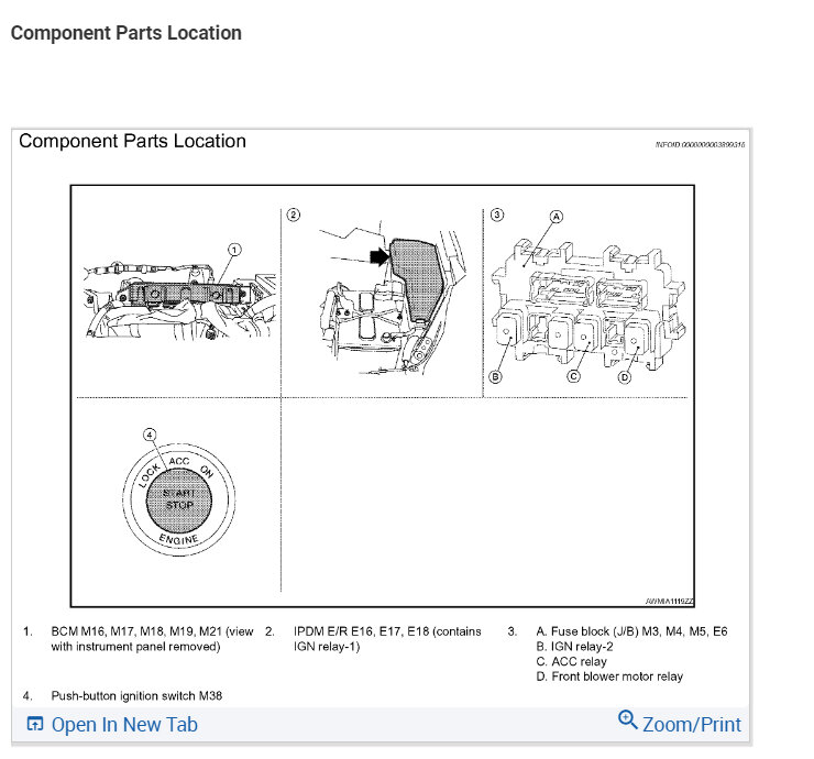

The push button can stay stuck down which means the switch needs to be replaced here are the instructions for the job in the images below. Check out the images (below). Let us know what happens and please upload pictures or videos of the problem so we can see what's going on.
