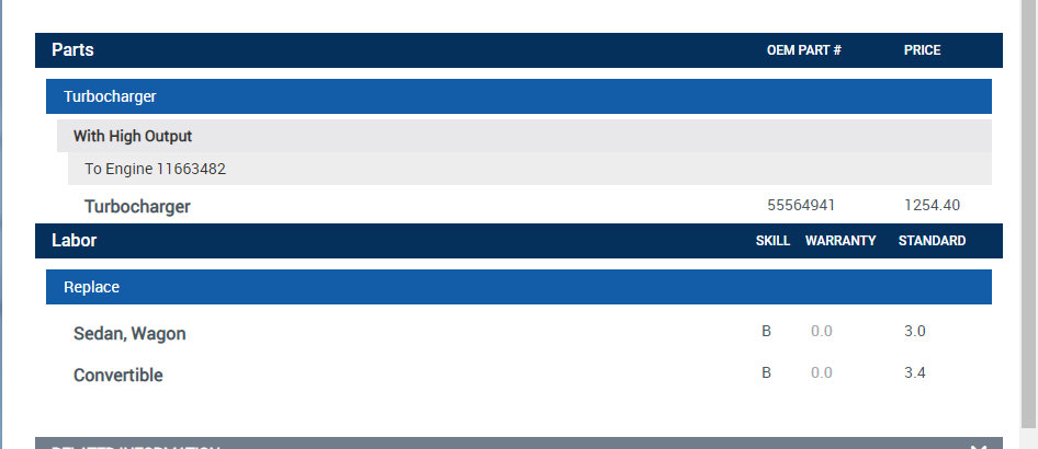

Is it wise to purchase one of these vehicles considering the SAAB corporation is out of business? Parts are surprisingly available nonetheless.
May 6, 2021 at 4:01 AM
I would not worry about the parts availability at this point. Many of the parts are available through other sourcing. When GM bought them in the later years many of the parts became more mainstream and were picked up by the aftermarket.
So the only thing I would worry about is the turbo as that is a costly part that was known to fail. As it sits that is very available but if you are planning on keeping this for another 10 years then it may be an issue.
The part number is attached below.
However, as it stands now, I would not hesitate on buying one of these vehicles as they are reliable and not that hard to work on.
Please let us know if you have other questions. Thanks
