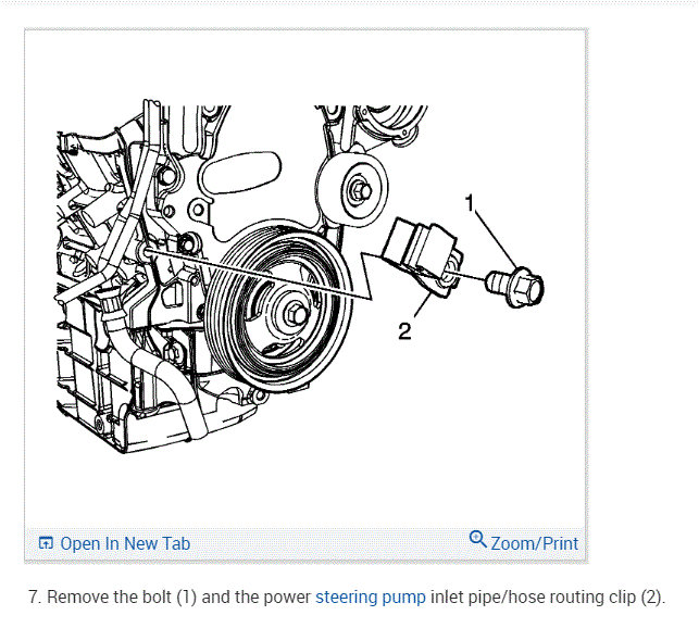

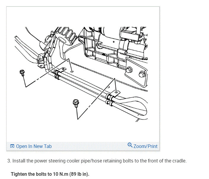

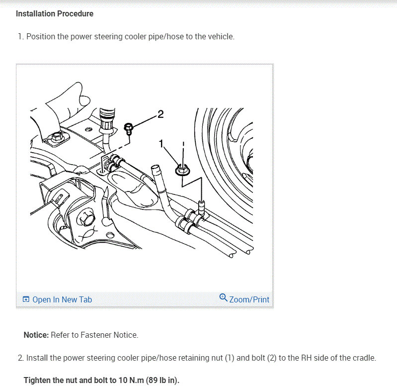

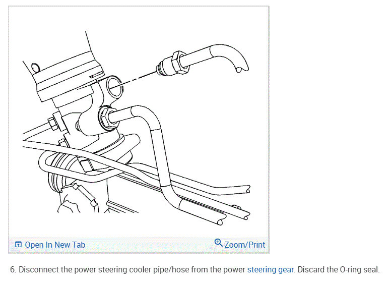

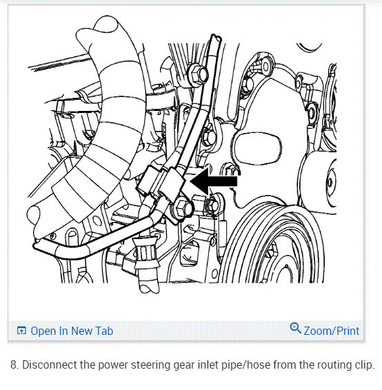

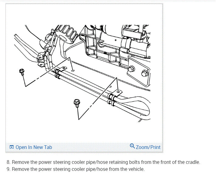

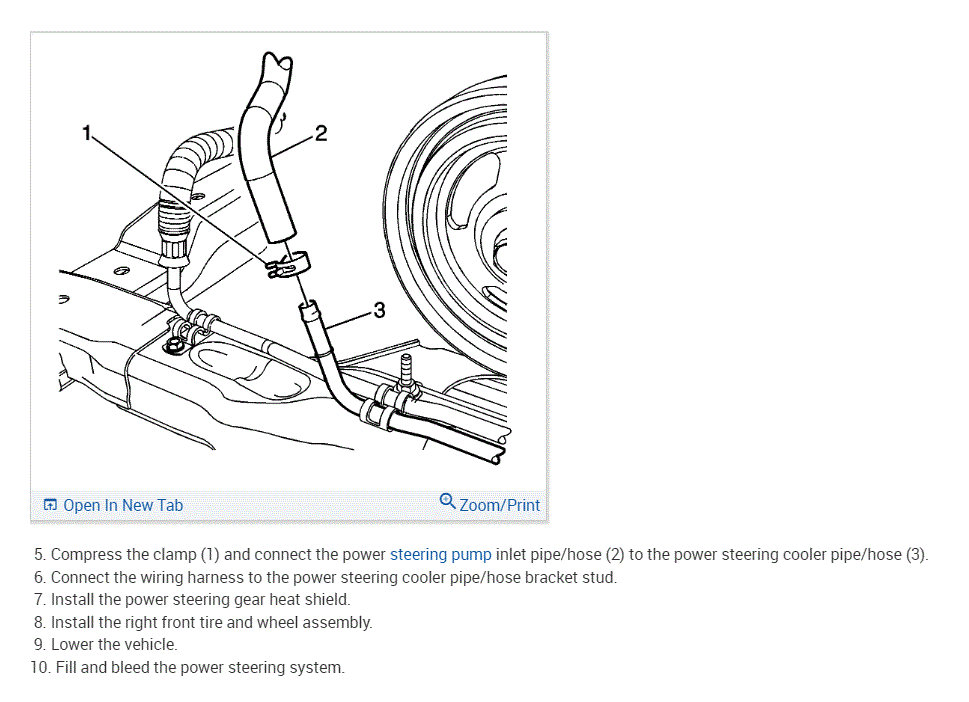

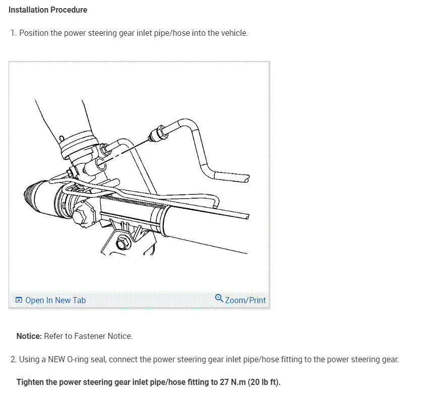

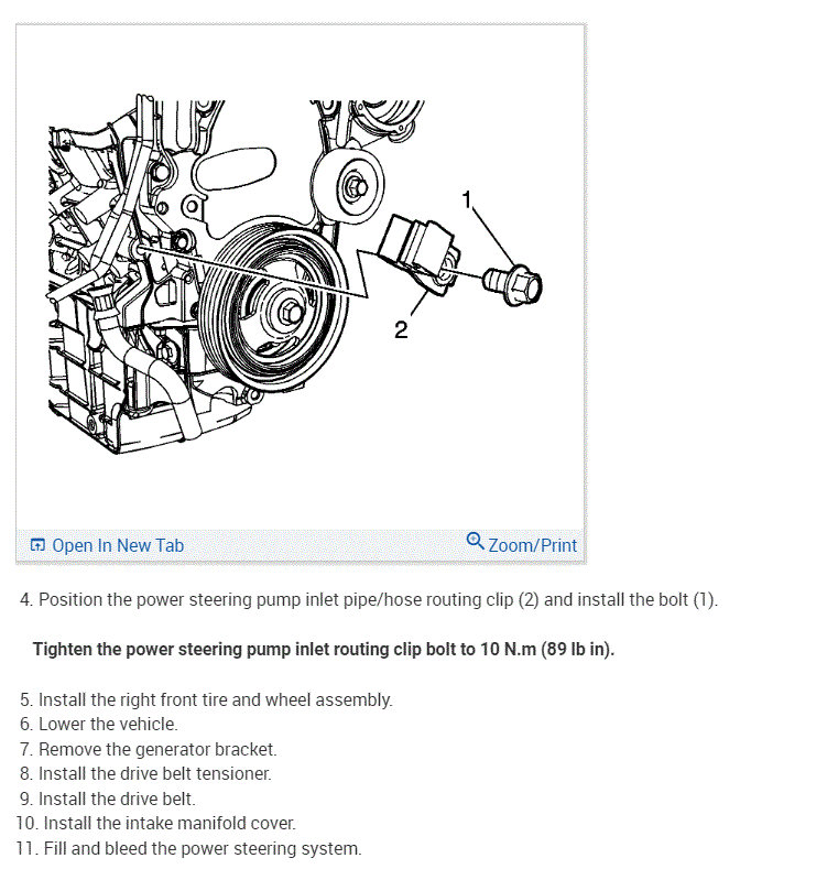

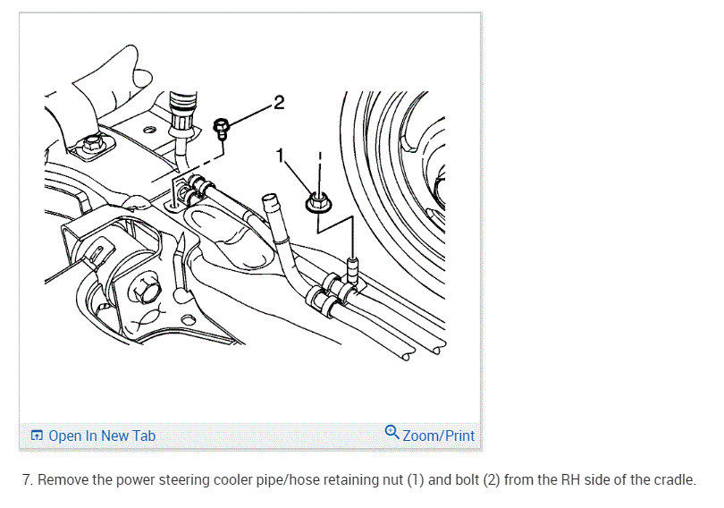

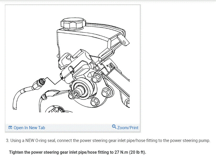

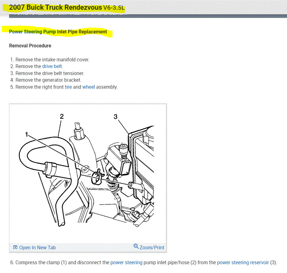

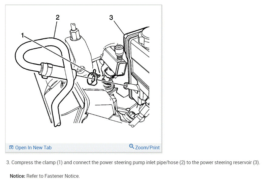

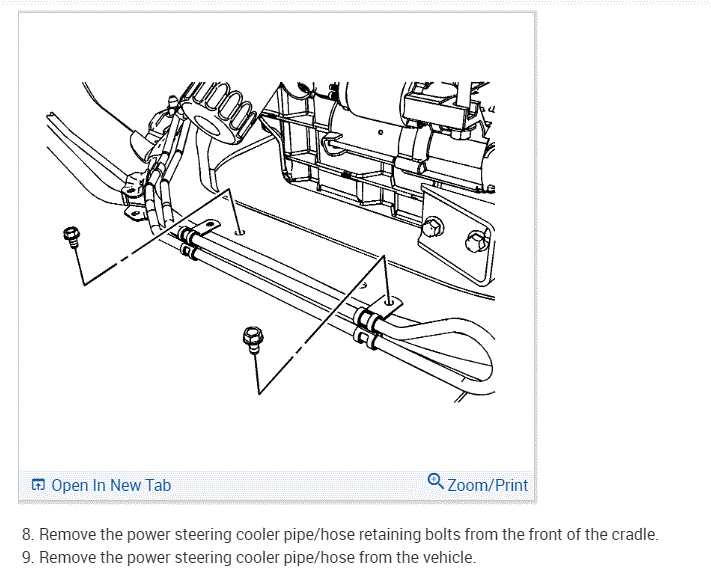

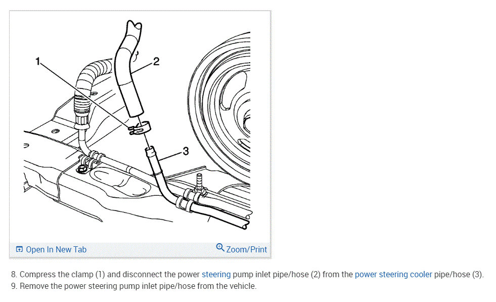

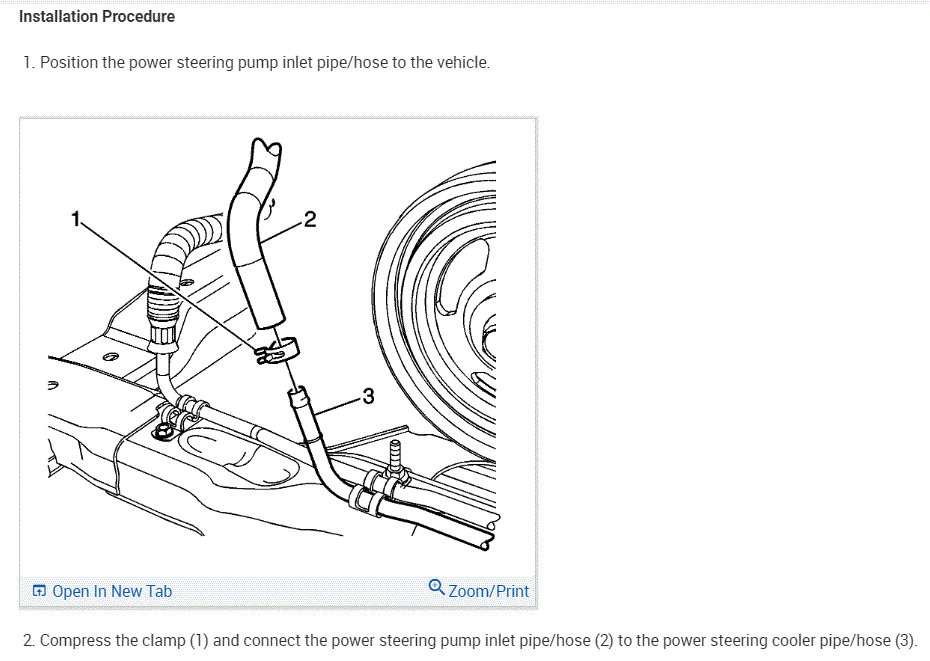

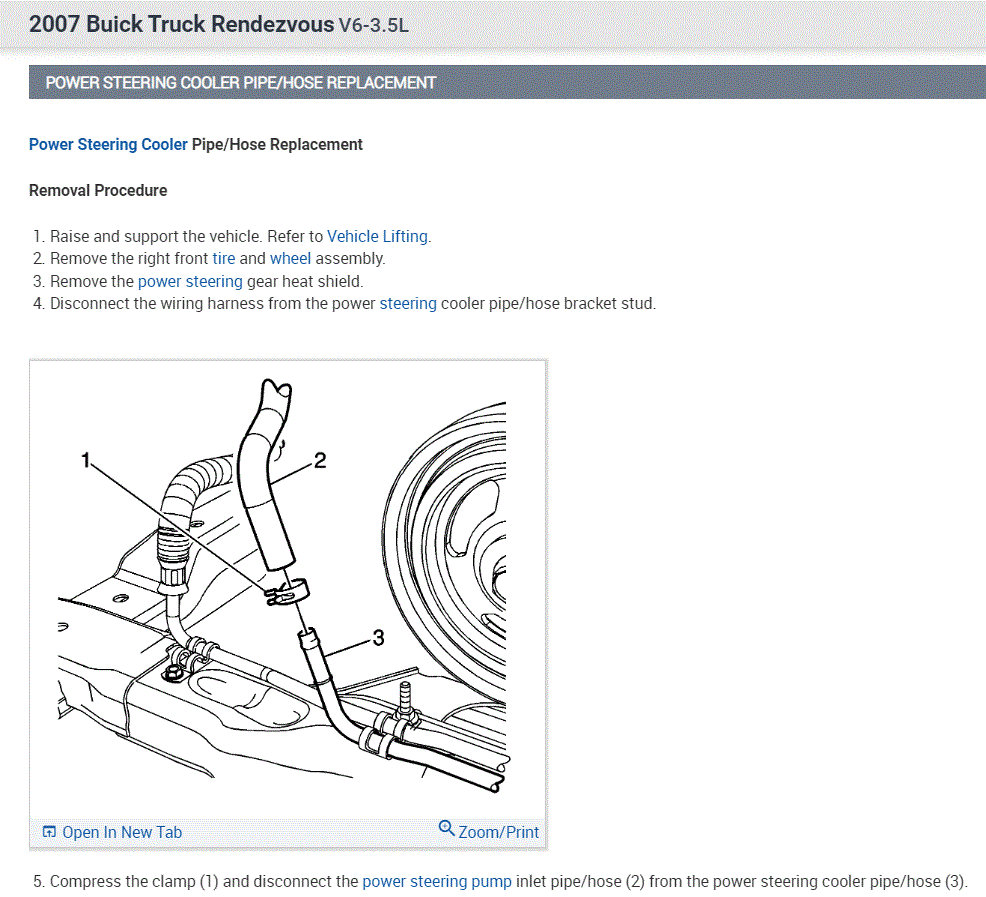

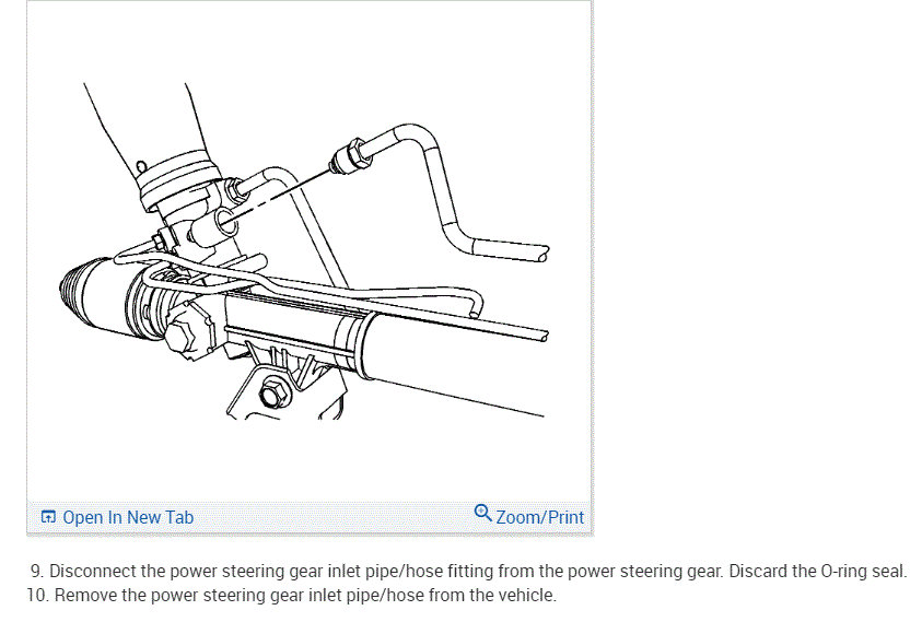

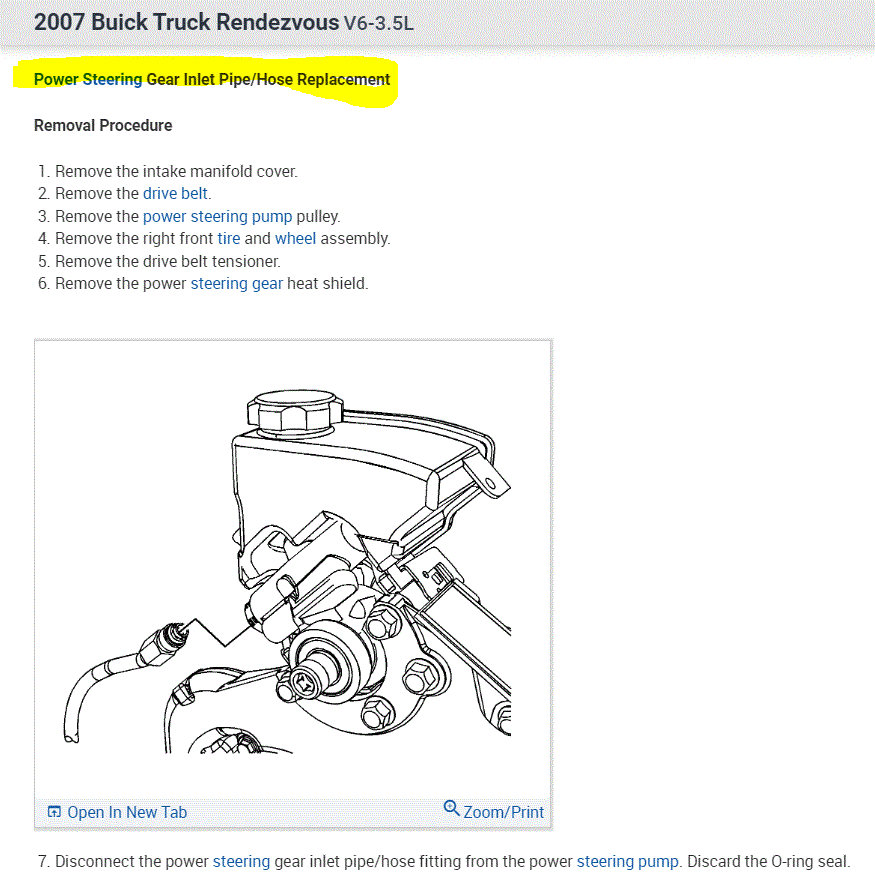

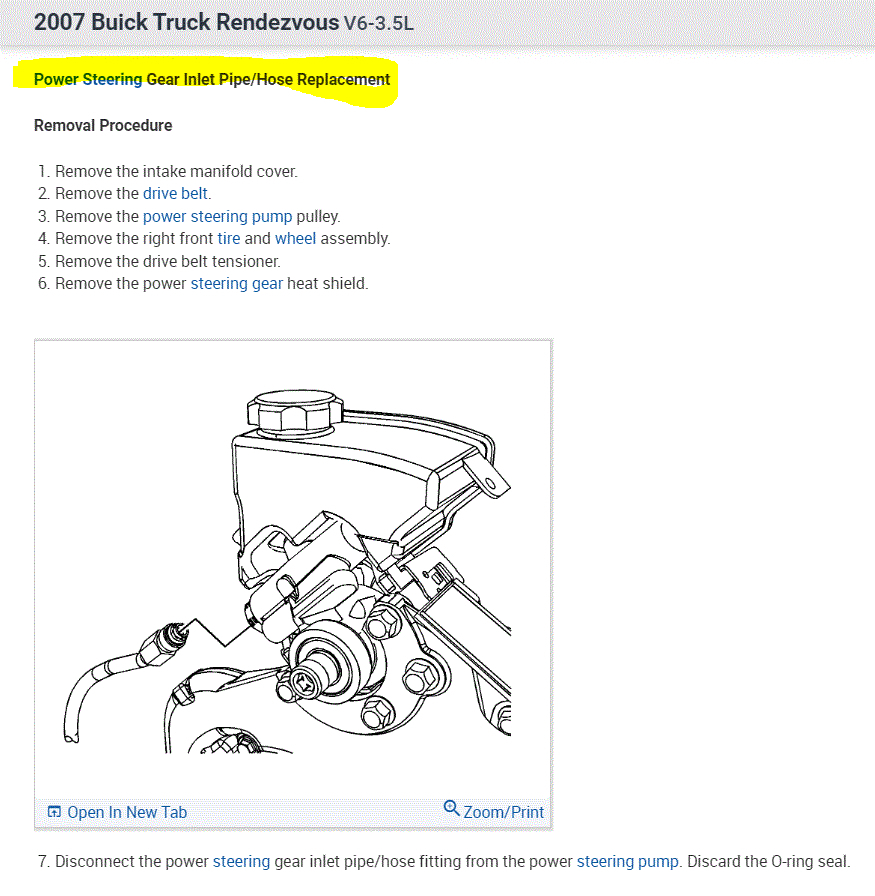

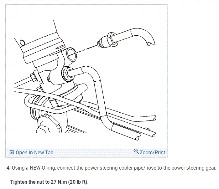

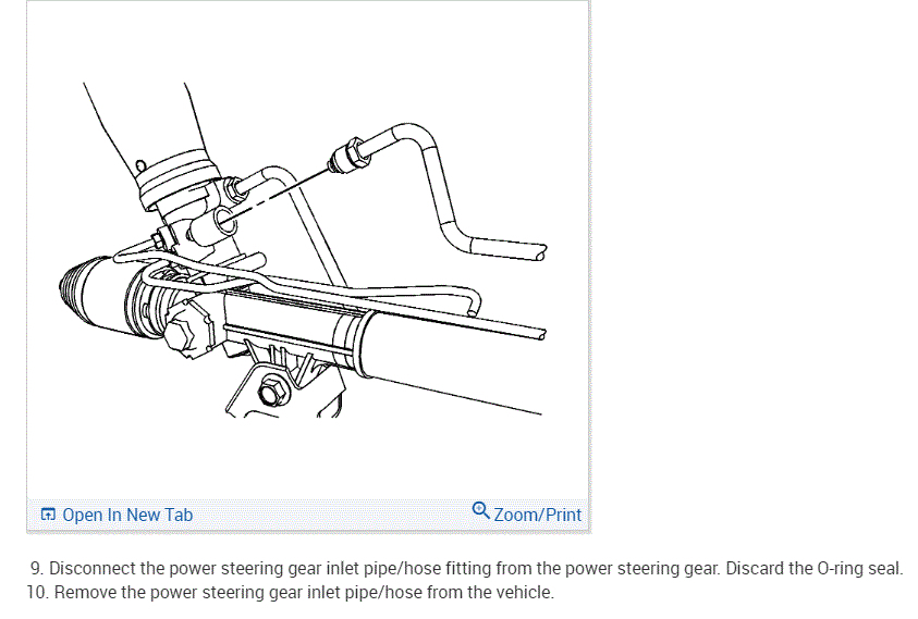

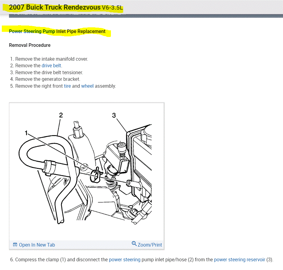

My son took the car to a mechanic for an estimate and the mechanic said the power steering lines and radiator are leaking, and the front seal is leaking oil. Do you have any diagrams on replacing the power steering lines? Thank you
Apr 13, 2022 at 2:30 AM
  • 110,241 POSTS
Hi Mark,

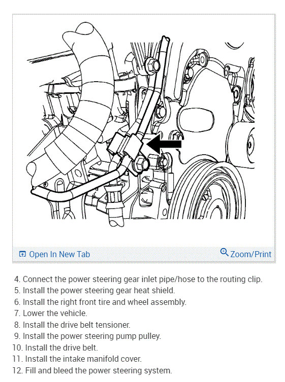

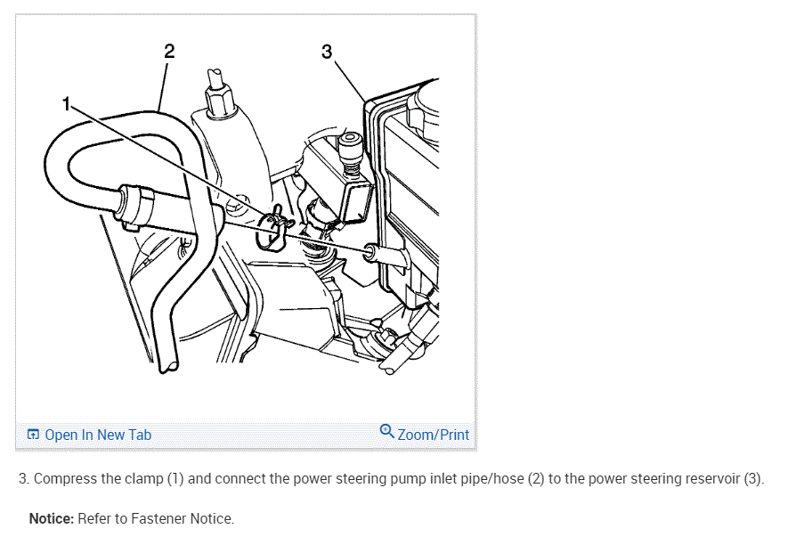

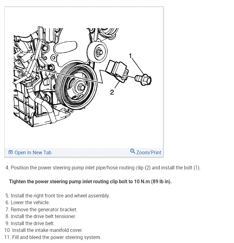

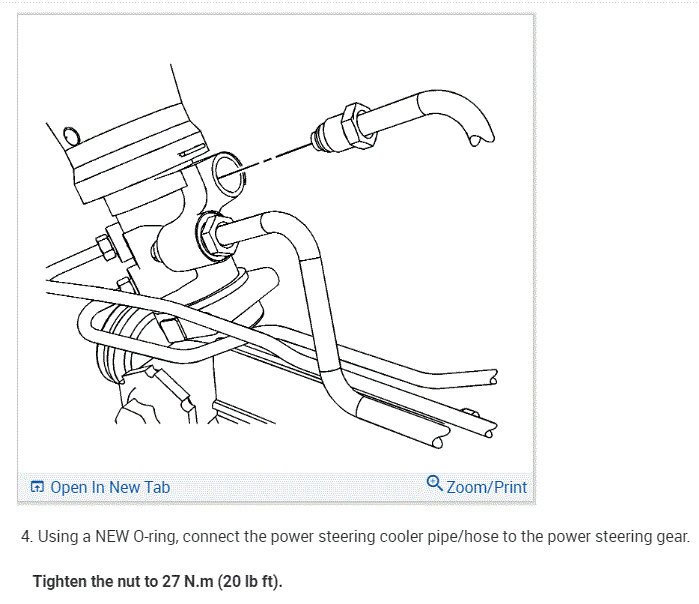

As far as the power steering hoses are concerned, there will be two, a high-pressure line and a return line. and a steel line that is a cooler.
If you look below, I attached the removal and installation directions for all three. I'm not sure which one you need.
Also, here is a link that you may find helpful. It explains the procedure in general.
https://www.2carpros.com/articles/how-to-replace-a-power-steering-hose
