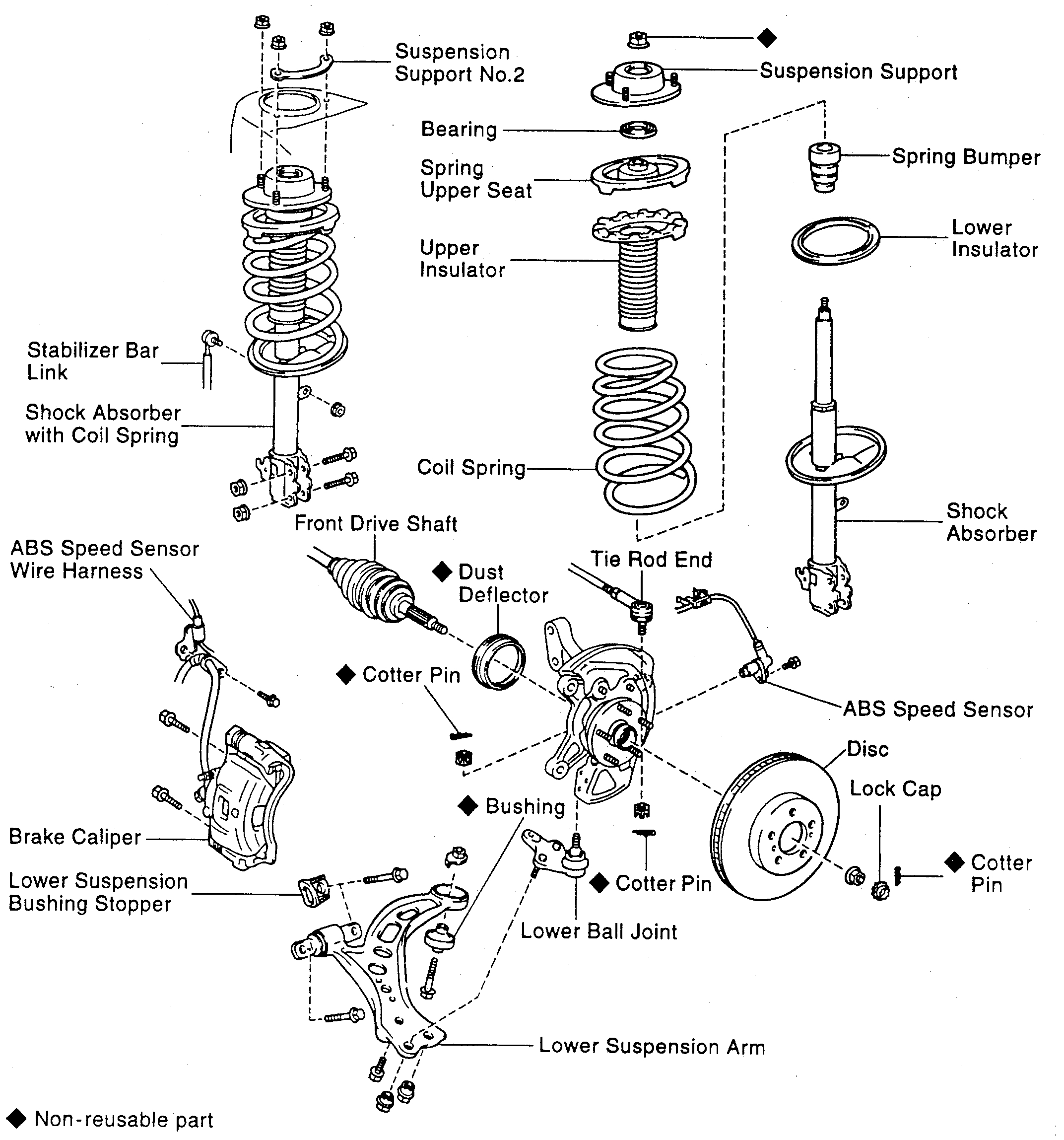

I need to remove a front wheel bearing on this car, it turns left when attempting to turn right, and also left when braking. Much play in the wheel all the way around. I have a 12 ton press for bearings, that should do the job (?). But I see there is a problem with the outer race on these bearings?
Any tips or instruction is appreciated.

Well to remove and replace the bearing, the steering knuckle needs removed. As far as the press, it will work fine for this.
Here are the directions for removal of the steering knuckle. The attached pictures correlate with the directions.
11-16

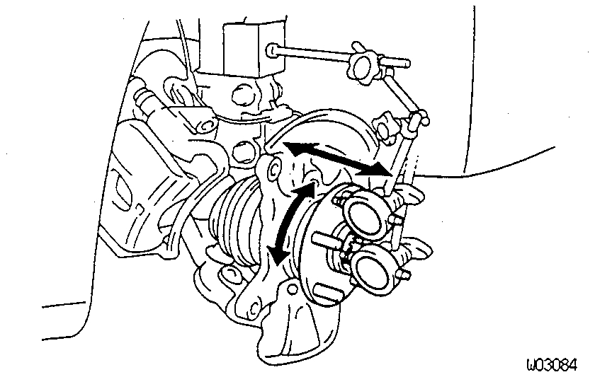

2. Check bearing backlash and axle hub deviation.
a. Remove the 2 bolts, brake caliper and disc.
b. Support the brake caliper securely.
pic 2
c. Using a dial indicator near the center of the axle hub and check the backlash in the bearing shaft direction.
Maximum: 0.05 mm (0.0020 inch).
If the backlash exceeds the maximum, replace the bearing.
d. Using a dial indicator, check the deviation at the surface of the axle hub outside the hub bolt.
If the deviation exceeds the maximum, replace the bearing.

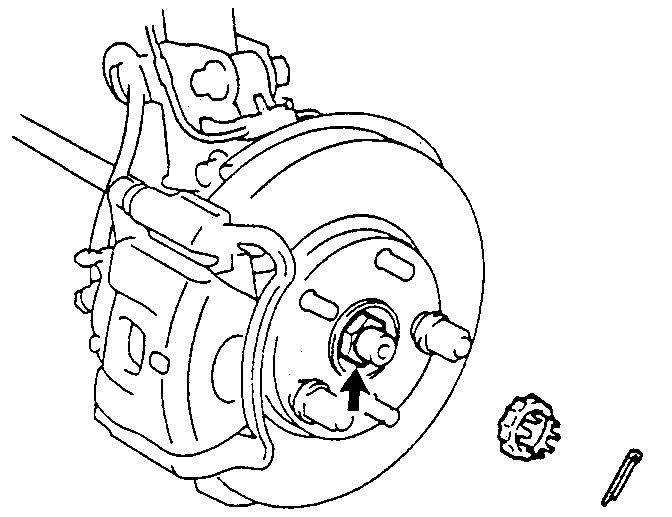

3. Remove drive shaft lock nut.
a. Remove the cotter pin and lock cap.
b. With applying the brakes, remove the nut.
Torque: 294 Nm (217 ft. lbs.)

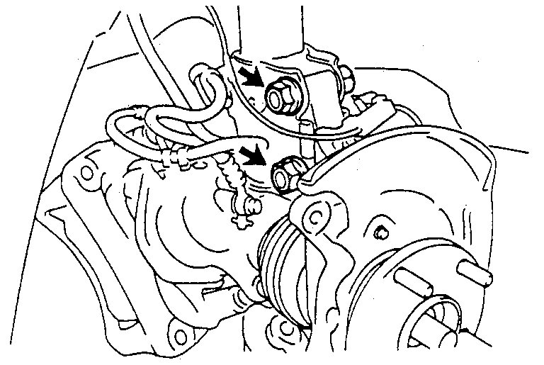

5. Loosen 2 nuts on lower side of shock absorber.
Torque: 211 Nm (156 ft. lbs.)
HINT: Do not remove the bolts.
HINT: At the time of installation, coat the nut's thread with engine oil.

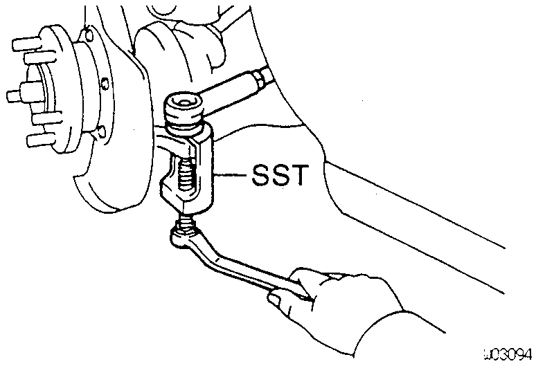

6. Disconnect tie rod end from steering knuckle.
a. Remove the cotter pin and nut.
Torque: 49 Nm (36 ft. lbs.)
pic 5
b. Using Special Service Tool (SST) 09610 - 20012, disconnect the tie rod end from the steering knuckle.

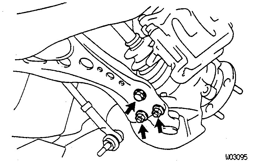

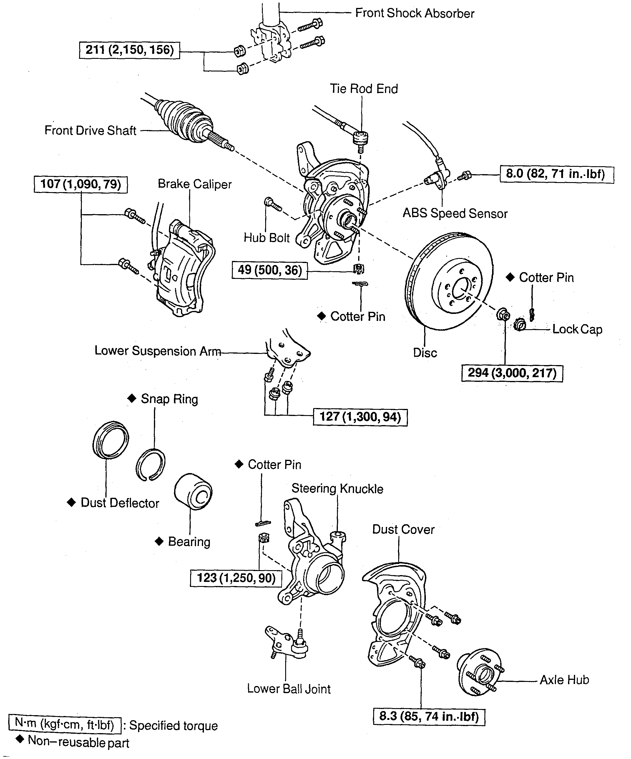

7. Disconnect lower ball joint from lower arm. Remove the 2 nuts and bolt.
Torque: 127 Nm (94 ft. lbs.)
8. Remove steering knuckle with axle hub.
a. Remove the 2 bolts on the lower side of the shock absorber.
b. Remove the steering knuckle with the axle hub.

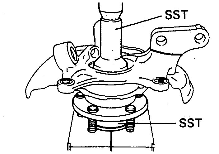

Here are the directions for removal and replacement of the bearing once the knuckle has been removed.
DISASSEMBLY AND ASSEMBLY
pic 7
DISASSEMBLY
1. Remove dust deflector, using a screwdriver.
pic 8

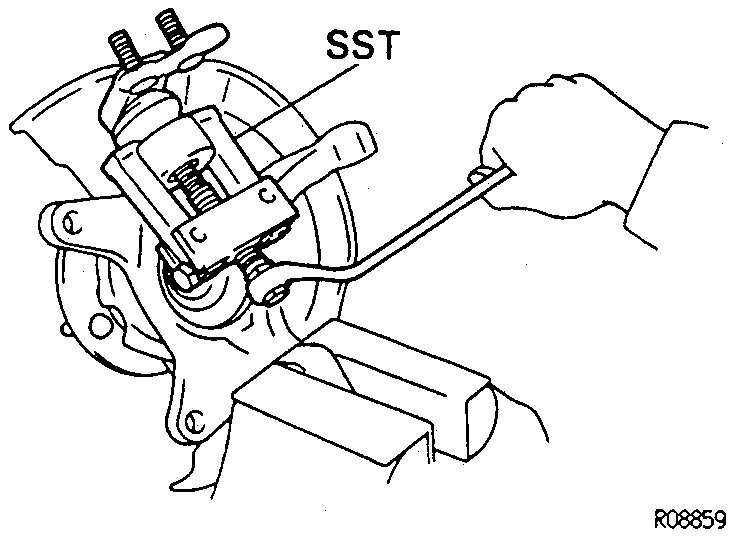

2. Remove lower ball joint.
b. Using Special Service Tool (SST) 09628 - 62011, remove the lower ball joint.

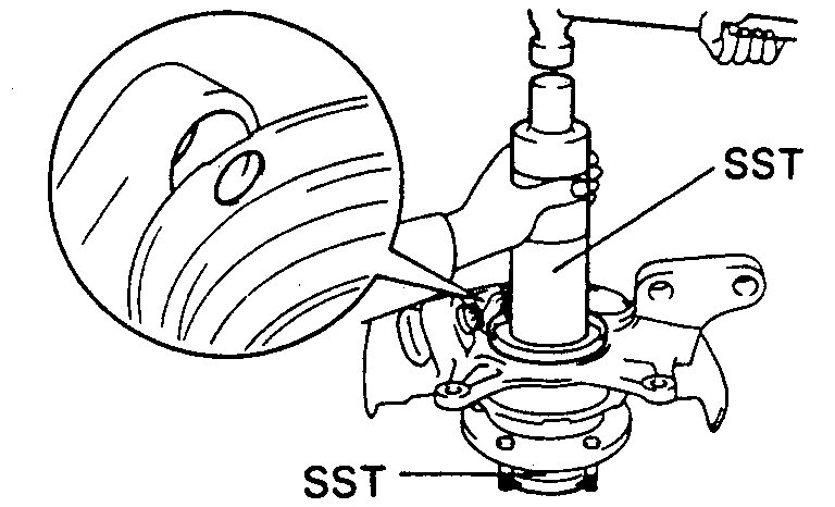

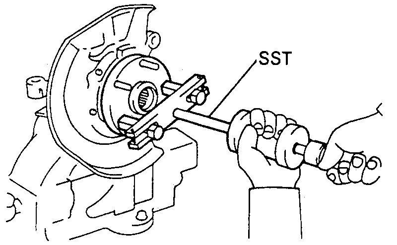

3. Remove axle hub.
pic 9
a. Using SST 09520 - 00031, remove the axle hub.

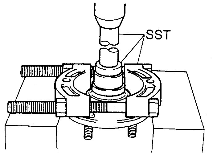

pic 10
b. Using SST 09950 - 00020, 09950 - 60010 (09951 - 00400), 09950 - 70010 (09951 - 07100) and a press, remove the inner race (outside) from the axle hub.
4. Remove dust cover. Using a torx wrench (T30), remove the 4 bolts and dust cover.
pic 11

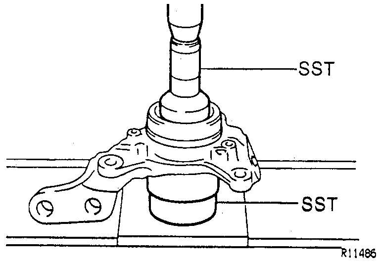

5. Remove bearing from steering knuckle.
a. Using snap ring pliers, remove the snap ring.
b. Place the inner race on the outside of the bearing.
c. Using SST 09310 - 35010, 09527 - 17011 and a press, remove the bearing.

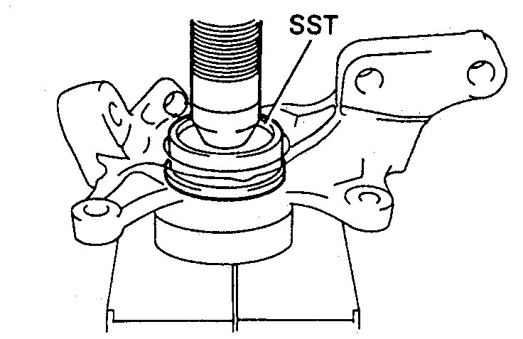

ASSEMBLY
pic 12
1. Install bearing.
a. Using SST 09608 - 32010 and a press, install a new bearing to the steering knuckle.
b. Using snap ring pliers, install a new snap ring.
2. Install dust cover.
Using a torx wrench (T30),torque the 4 bolts.
Torque: 8.3 Nm (74 inch lbs.).
pic 13
3. Install front axle hub, using SST 09310 - 35010, 09608 - 32010 and a press.
4. Install lower ball joint.
a. Install the lower ball joint and torque the nut.
Torque: 123 Nm (90 ft. lbs.).
b. Install a new cotter pin.
pic 14
5. Install dust deflector; using SST 09316 - 60011 (09316 - 00011, 09316 - 00041), 09608-32010 and a hammer.

Due to the extreme conditions you mentioned, I strongly recommend checking tie rods, ball joints, and anything related to the steering. This would be the time for replacement if you find they are bad.

It doesn't say anything about how to remove the annoying ring on the underside of the knuckle. It's right in front of the castle nut for the ball joint. I also have the hub pressed out but the bearing just isn't wanting to come out...
Jun 25, 2019 at 7:03 PM
  • 110,194 POSTS
Welcome back:
I'm not sure which ring you are referring to. Take a look at the attached pictures and let me know if you see it. The only thing I can think of is a dust deflector.
If you are removing the bearing, then the steering knuckle is off, correct? Did you remove the snap ring? Make sure the snap ring is removed and the adapters you are using with your press are the right sizes.

Finished the wheel bearing, customer came back with the same issue which was the car sliding when turning left. Also some kind of harmonic sound after sliding. Was asked to replace inner and outer tie rods and ball joints plus alignment. So I did. Still happens but a little better after an alignment.
Both CV axle boots are busted so I'm leaning towards the bearings there being worn or possibly the sway bar links.
Jul 13, 2019 at 2:29 PM
  • 110,194 POSTS
Welcome back:
Did you drive it and feel the slide? What part is sliding front or rear? Are you sure there isn't an issue with the frame or control arms? I have to be honest. I wish I could be there to drive it and experience what is happening.
