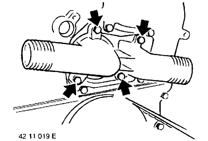

The only other flange that sounds relevant is the thermostat housing. However, that is at the front of the engine above the water pump. See pic below.
If that was leaking, I would think it would have been seen, but anything is possible.
By chance is that what is indicated?
If you have the receipt from the repair, take a pic of it and upload it for me to see. That may point me in the right direction. Also, I don't feel pressure testing the system would have caused this.
See pic below.

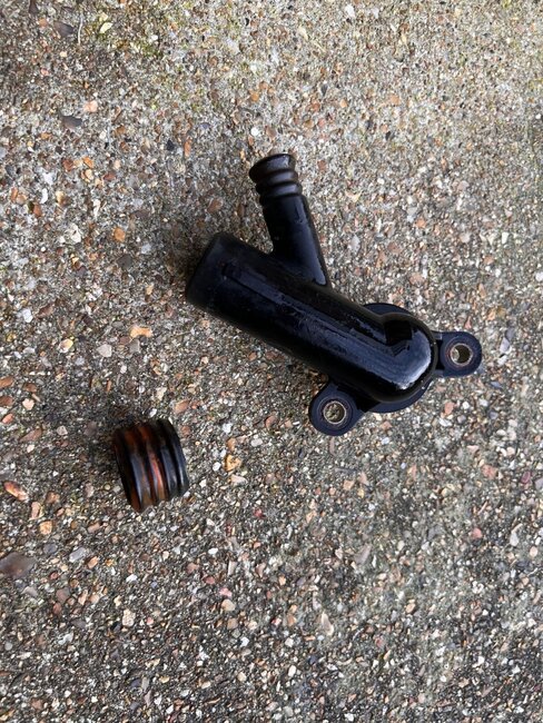

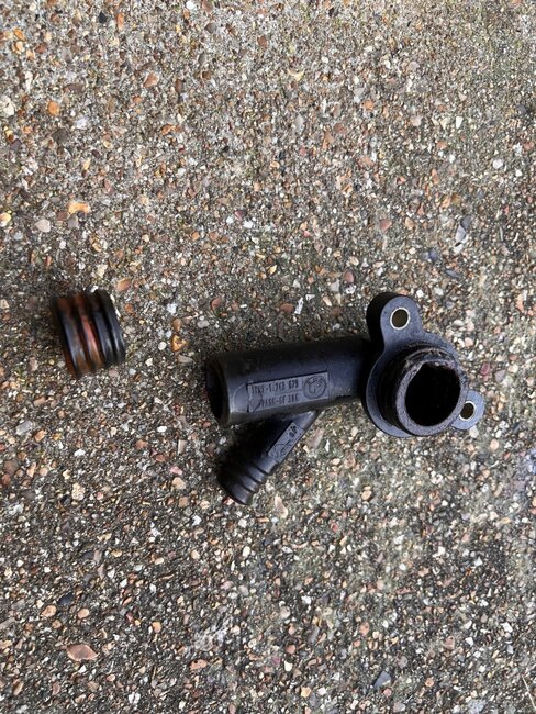

Thank you once again for coming back to me. I believe I have the broken flange that was replaced because the mechanic left it in the car, so I have attached a couple of photos of it. I am also attaching the two relevant invoices - the first for the radiator and water pump replacement: the second for the flange and radiator cap replacement.

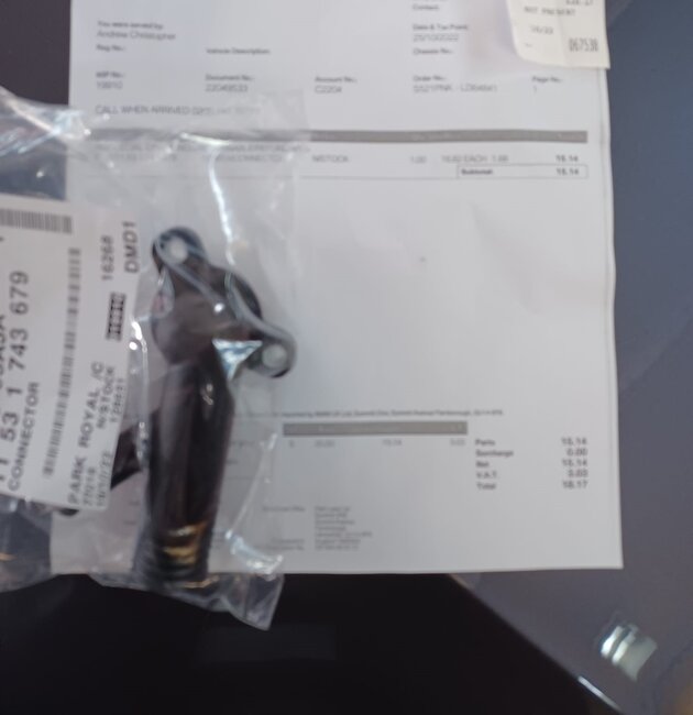

I also just remembered that the mechanic sent me a photo of the replacement part he ordered once it had arrived, so I am attaching a photo of that too. It is a bit blurry I'm afraid.

That is the thermostat housing, and it is plastic if I recall. I don't feel you have anything to worry about. If that has been replaced, you should be fine. Also, the tests that were done wouldn't cause that to happen.

First, it's odd for the thermostat housing to fail. They normally last the life of the engine. However, anything is possible. It may have been hit when other work was being done or the thermostat was incorrectly installed.
