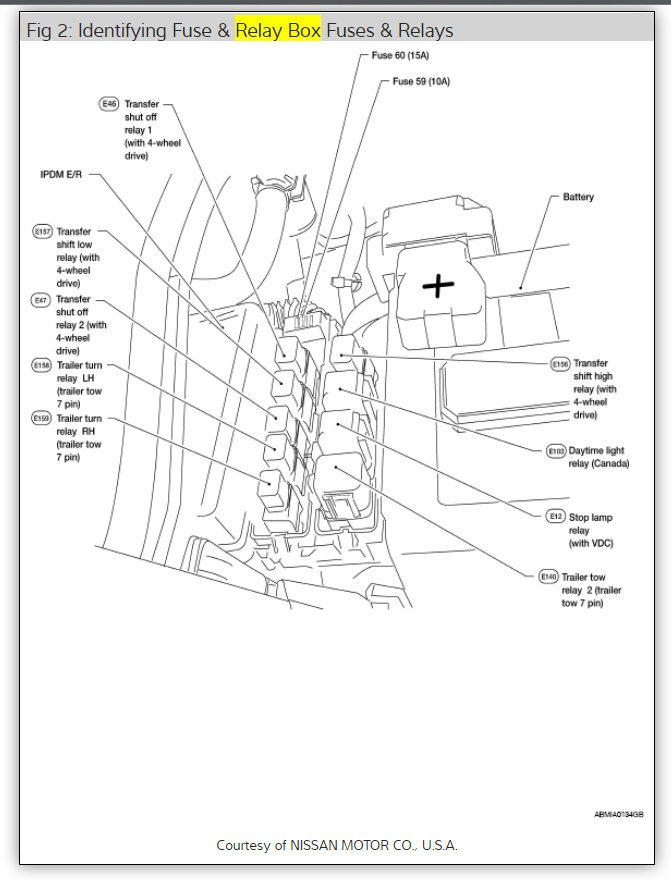

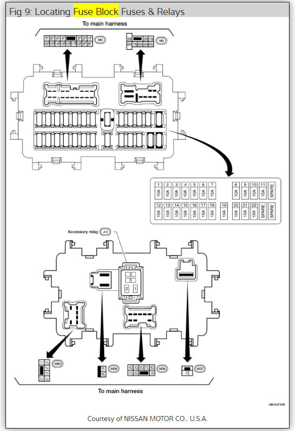

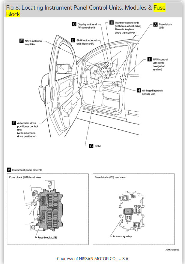

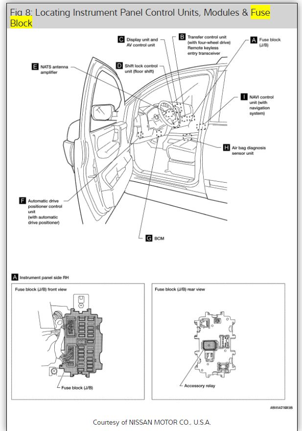

It sounds like you need to reinitialize the the new blend door actuator. With the key on remove the HVAC fuse (# 8 and 19) for two minutes and with the key still on reinstall the fuse.
This should reset the system. Here are the fuse locations.
