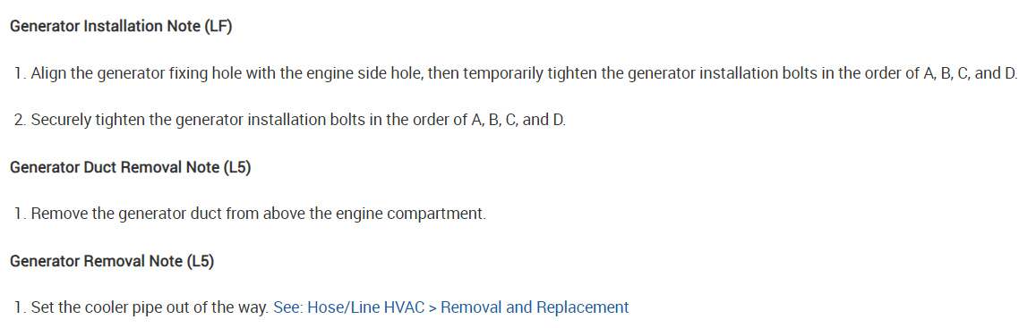

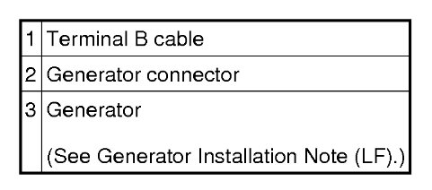

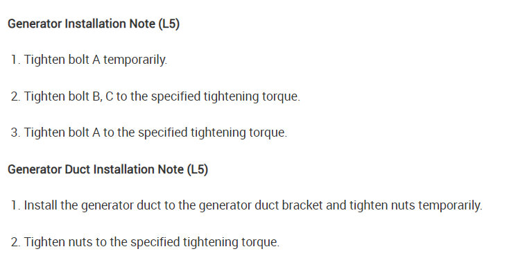

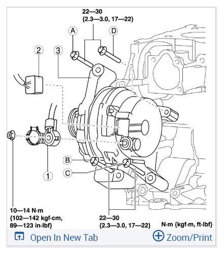

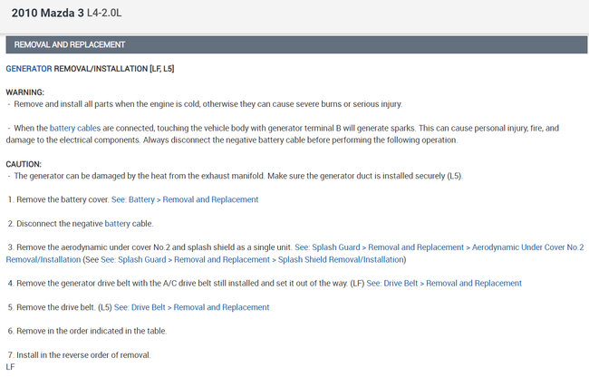

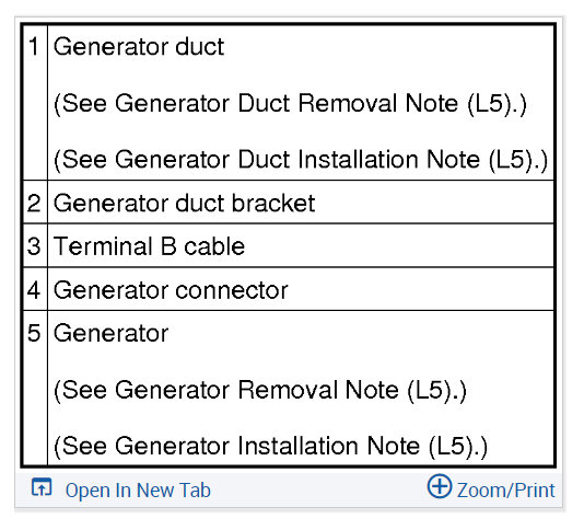

Yep, it sounds like the alternator is bad and not charging, you will need to charge the battery up first or jump start it once the alternator has been replaced. Here is a guide to help test the alternator in case you want to double check the charging voltage:

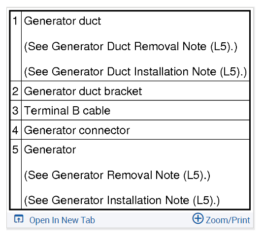

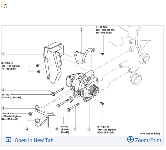

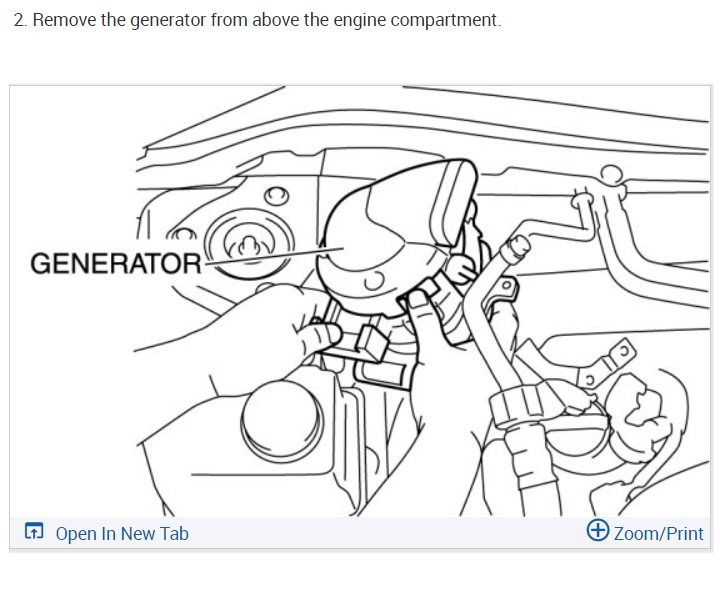

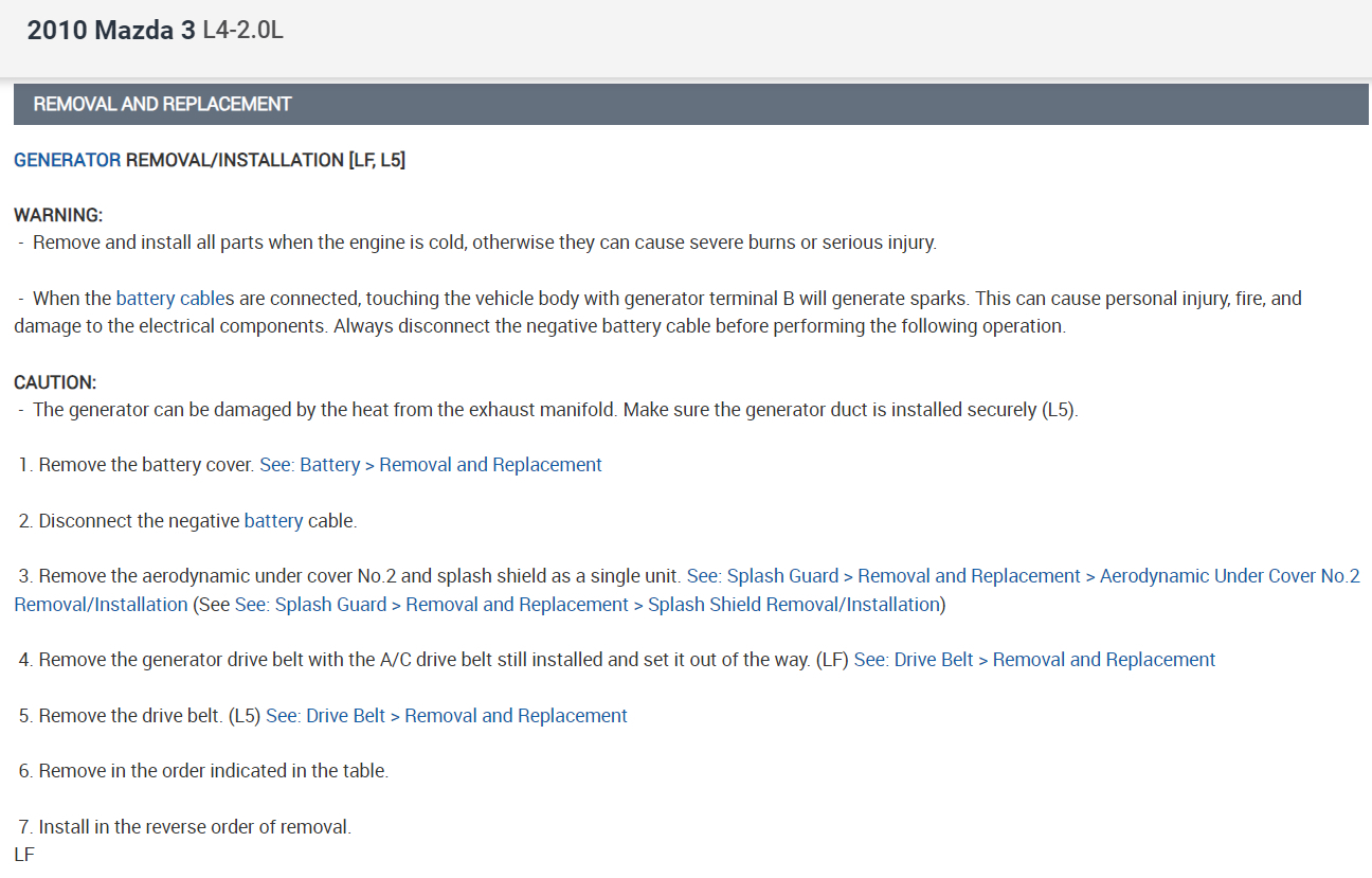

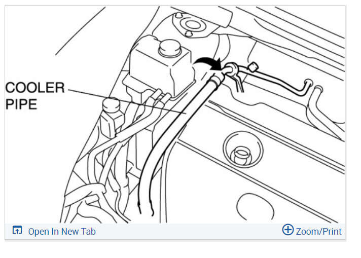

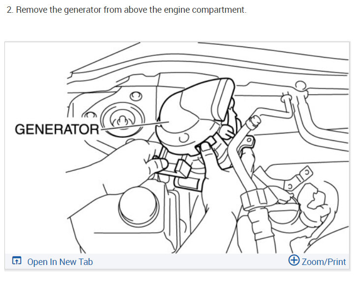

When the alternator is not charging the battery light will come on. Here is how to change the alternator out. Check out the images (below). Please upload pictures or videos in your response of any problems so we can see what to help you with.
