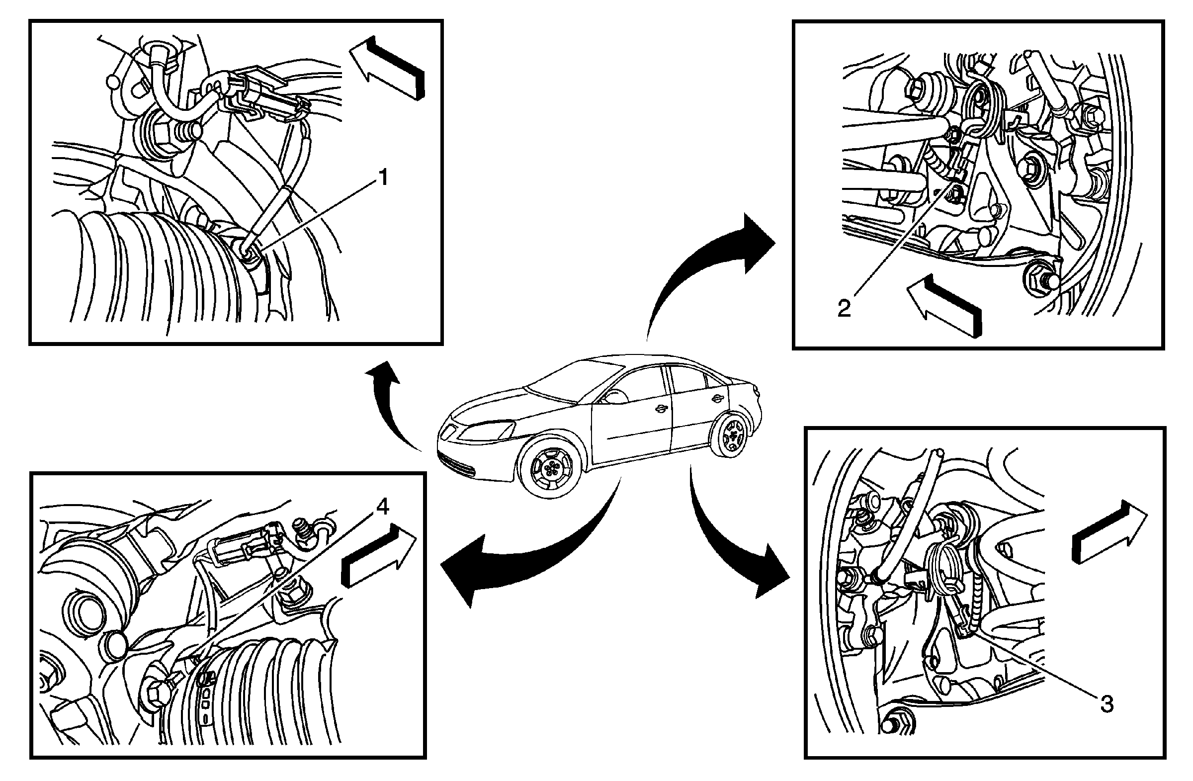

Since the traction control light flashes, it should have trouble codes stored in the computer. However, in most cases the type of code it will set requires an upper level scanner. Can you tell me if the check engine light stays on when the engine is running?
Now, most times a traction control light comes on, it is related to a wheel speed sensor. I have even seen them come on when the brake fluid in the master cylinder was low, so check that.
As far as a wheel speed sensor (aka an abs sensor), here is a link that explains how to test one. Also, I attached two pictures to help you locate the sensors. Pictures 1 and 2

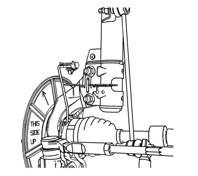

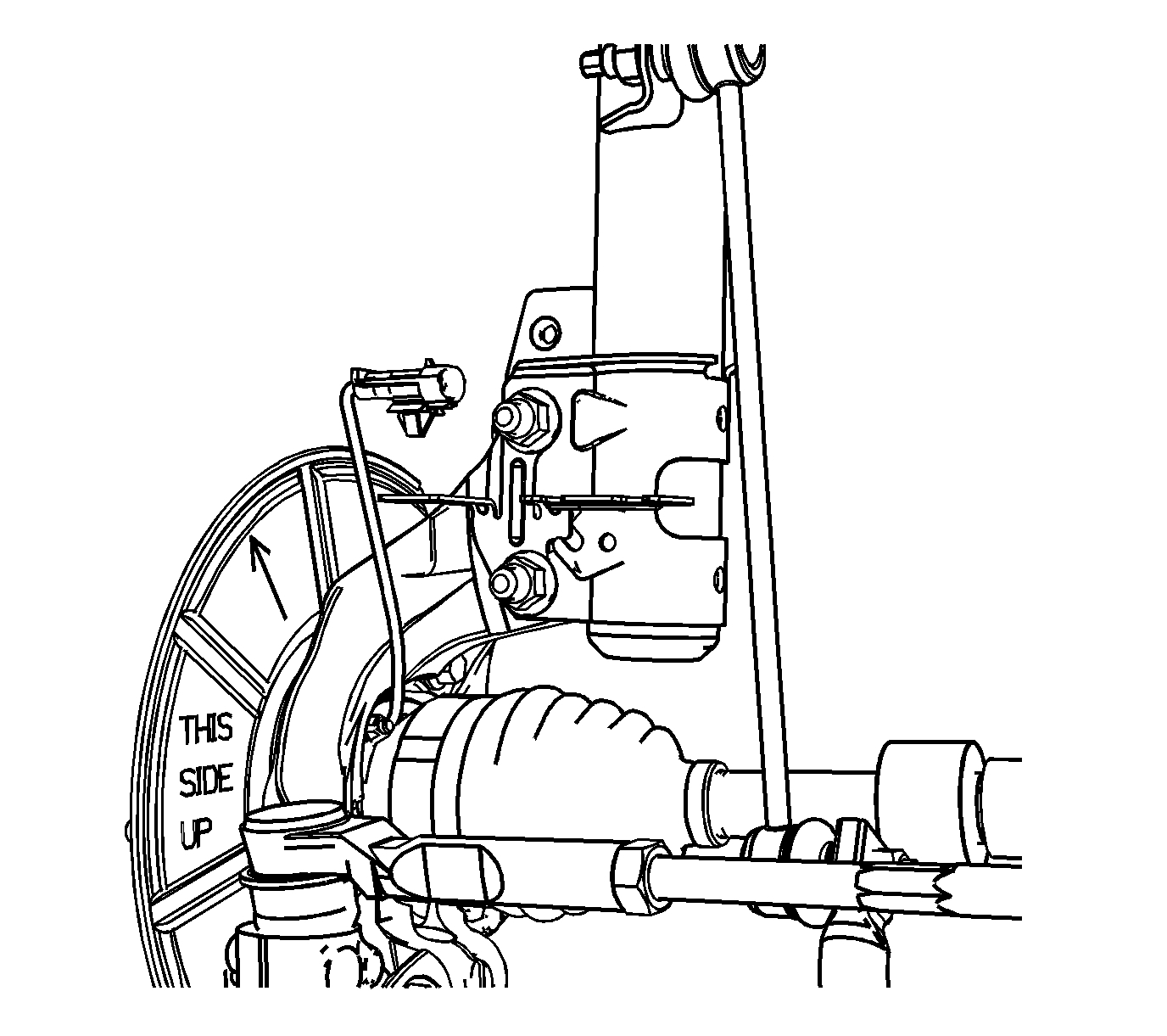

pic 3
4. Disconnect the electrical connector from the wheel speed sensor, if equipped with ABS.
5. Remove the stabilizer link bolt at the knuckle and position the stabilizer link out of the way in order to provide access to the wheel bearing/hub nuts. Refer to Stabilizer Shaft Replacement (See: Stabilizer Bar, Sway Control > Removal and Replacement > Stabilizer Shaft Replacement).
6. Remove the 4 wheel bearing/hub assembly nuts.
7. Remove the wheel bearing/hub assembly from the knuckle.

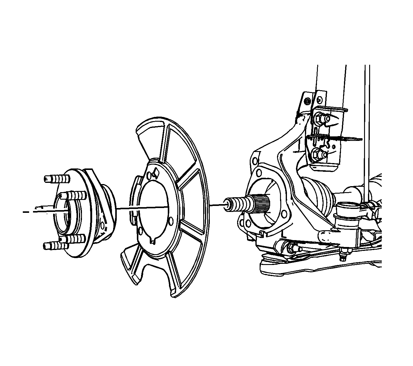

2. Remove the brake rotor. Refer to Front Brake Rotor Replacement (See: Brake Rotor/Disc > Removal and Replacement).
pic 4
3. Disconnect the wheel speed sensor electrical connector, if equipped.
4. Remove the wheel speed sensor electrical connector from the mounting bracket, if needed.

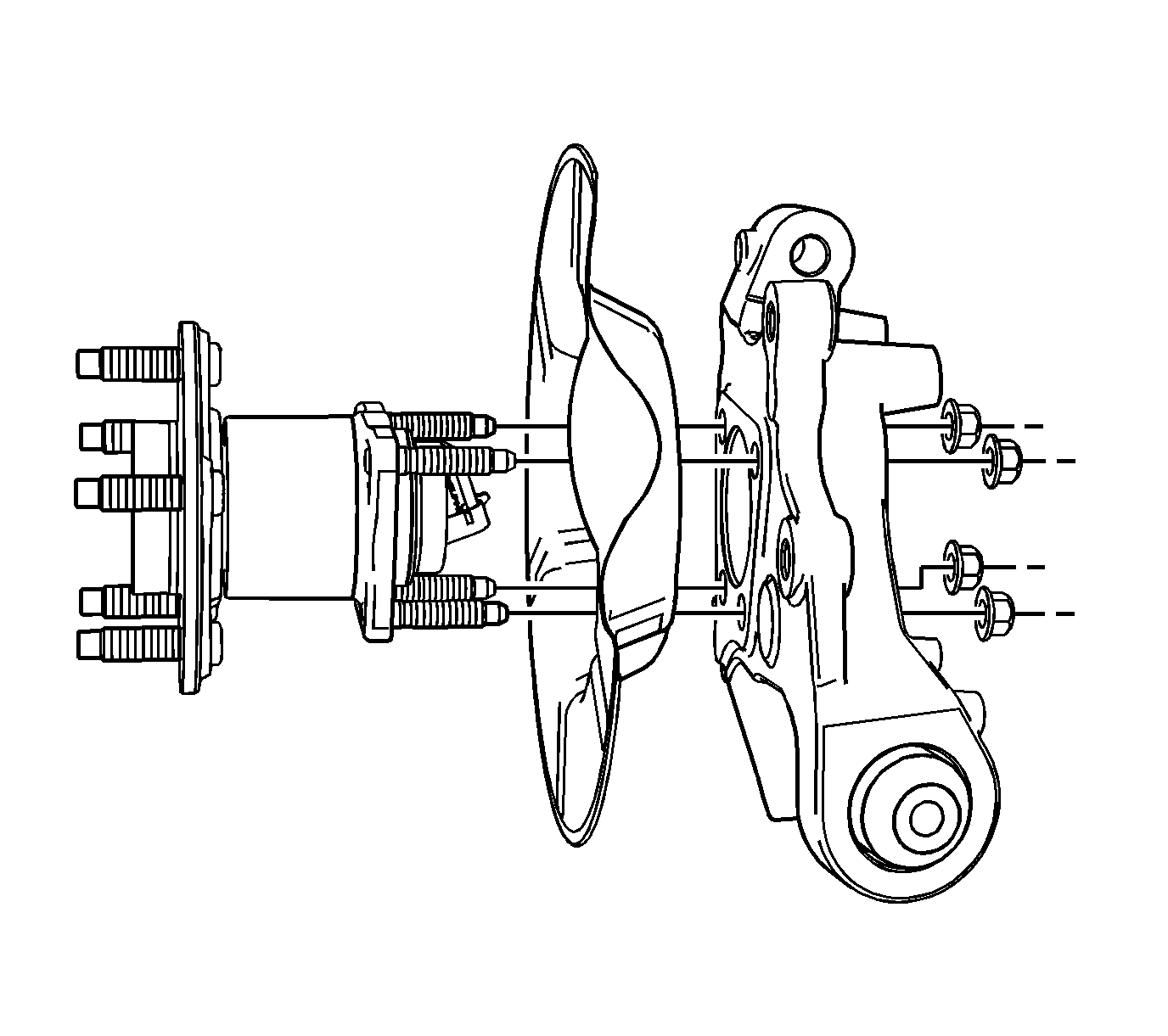

5. Loosen the wheel drive shaft from the wheel bearing/hub. Refer to Wheel Drive Shaft Replacement (See: Axle Shaft Assembly > Removal and Replacement > Wheel Drive Shaft Replacement).

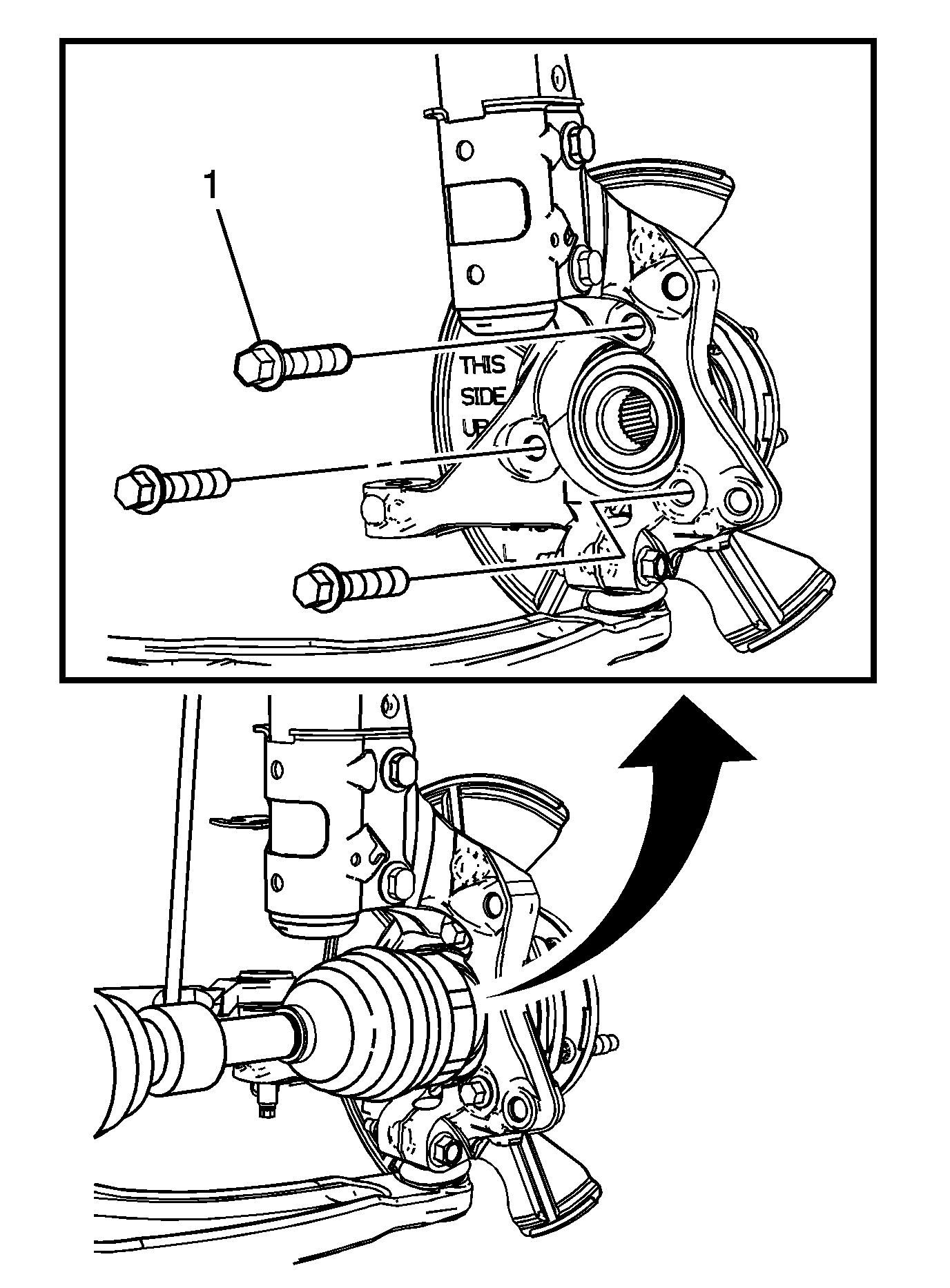

pic 5
6. Remove the wheel bearing/hub mounting bolts (1).
