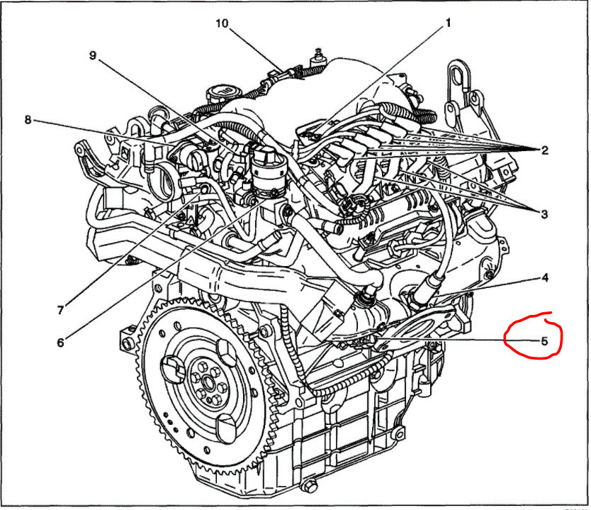

What you described sounds like a bad crankshaft position sensor. Often, they will fail when they get hot. Do me a favor. Read through this link and let me know if it seems to mirror what you experience.
If you feel it does, check to see if there is spark to the plugs when it won't start. If there is no spark, this is my first suspect. Here is a link that shows how to check for spark:
If you find there is no spark, here is a link that shows in general how to replace the sensor:
Here are directions specific to your vehicle for replacement:

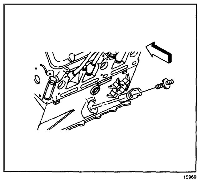

Pic 1 shows location.

pic 2
1. Turn OFF the ignition.
2. Raise the vehicle. Refer to Lifting and Jacking the Vehicle.
3. Remove the right tire and wheel.
4. Turn steering wheel fully to the left.
5. Disconnect the sensor electrical connector.
6. Remove the attaching bolt/screw.
7. Remove the sensor from engine.
8. Inspect for wear, cracks, or leakage if the sensor is not being replaced.

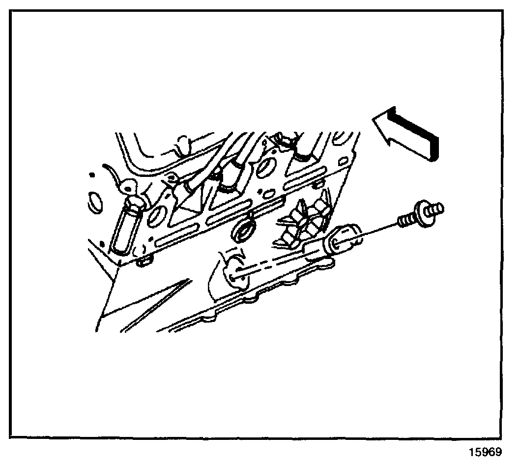

INSTALLATION PROCEDURE
pic 3
1. Lubricate the O-ring with clean engine oil before installation and replace if damaged.
2. Install the sensor to the block.
NOTE: Refer to Fastener Notice in Service Precautions.
3. Install the CKP sensor attaching bolt.
Tighten
Tighten the bolt to 11 N.m (97 lb in).
4. Connect the sensor electrical connector.
5. Install the right tire and wheel.
6. Lower the vehicle.
7. Perform the CKP System Variation Learn Procedure. See: Vehicle > Programming and Relearning

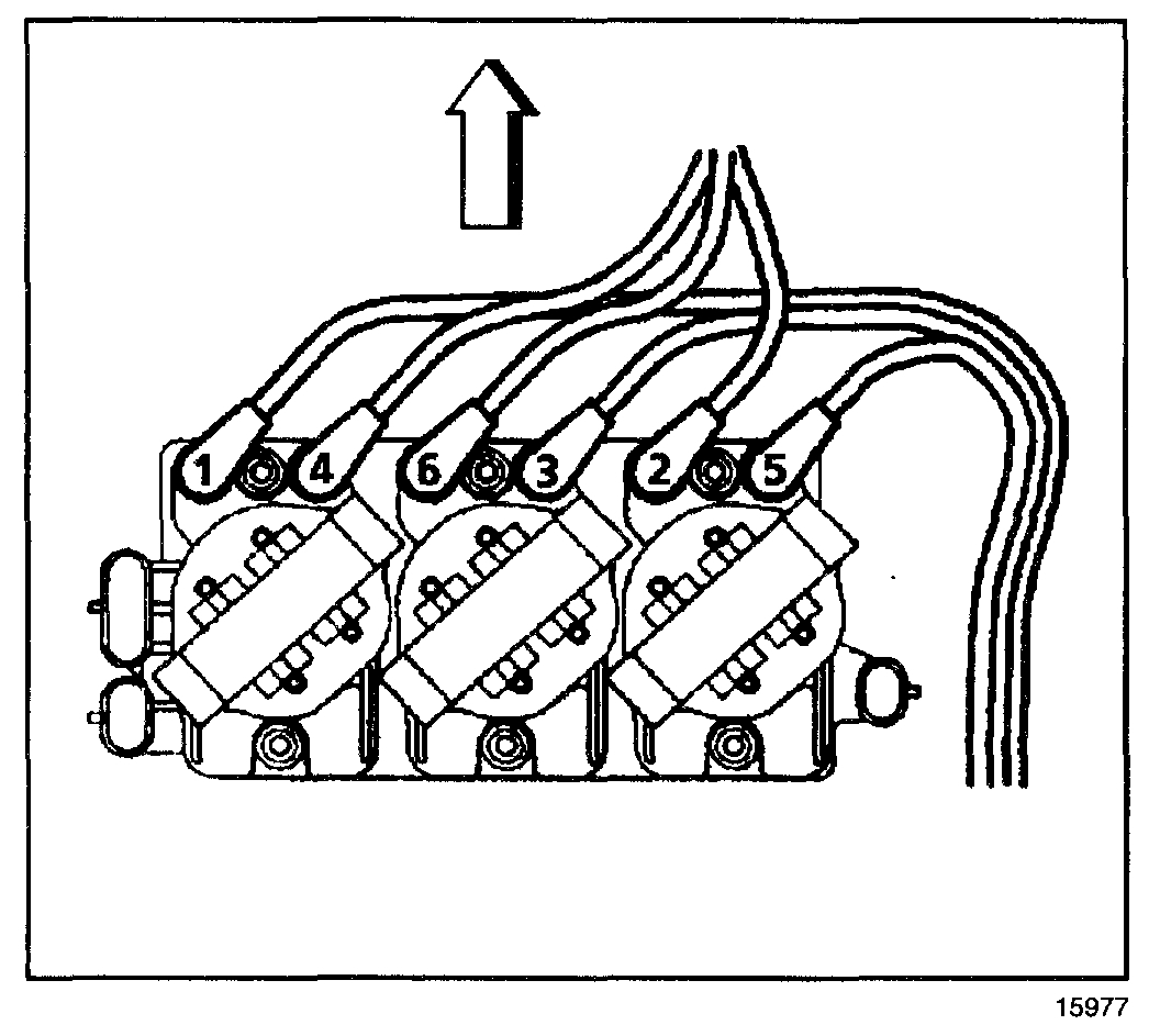

You replaced just about everything. The only thing left is the ICM (ignition control module). It is what the coils mount to. What I would suggest is to remove the module and have it tested at a parts store.
Here are the directions for removal and replacement. The pics correlate with the directions.

pic 1
2. Disconnect all the electrical connectors at the ignition control module (ICM).
3. Note position of spark plug wires for installation and disconnect the spark plug wires from the ignition coils.
4. Remove the screws securing the coil assemblies to the ICM.
5. Disconnect the coils from the ICM.
6. Remove the ICM from the module mounting bracket.
